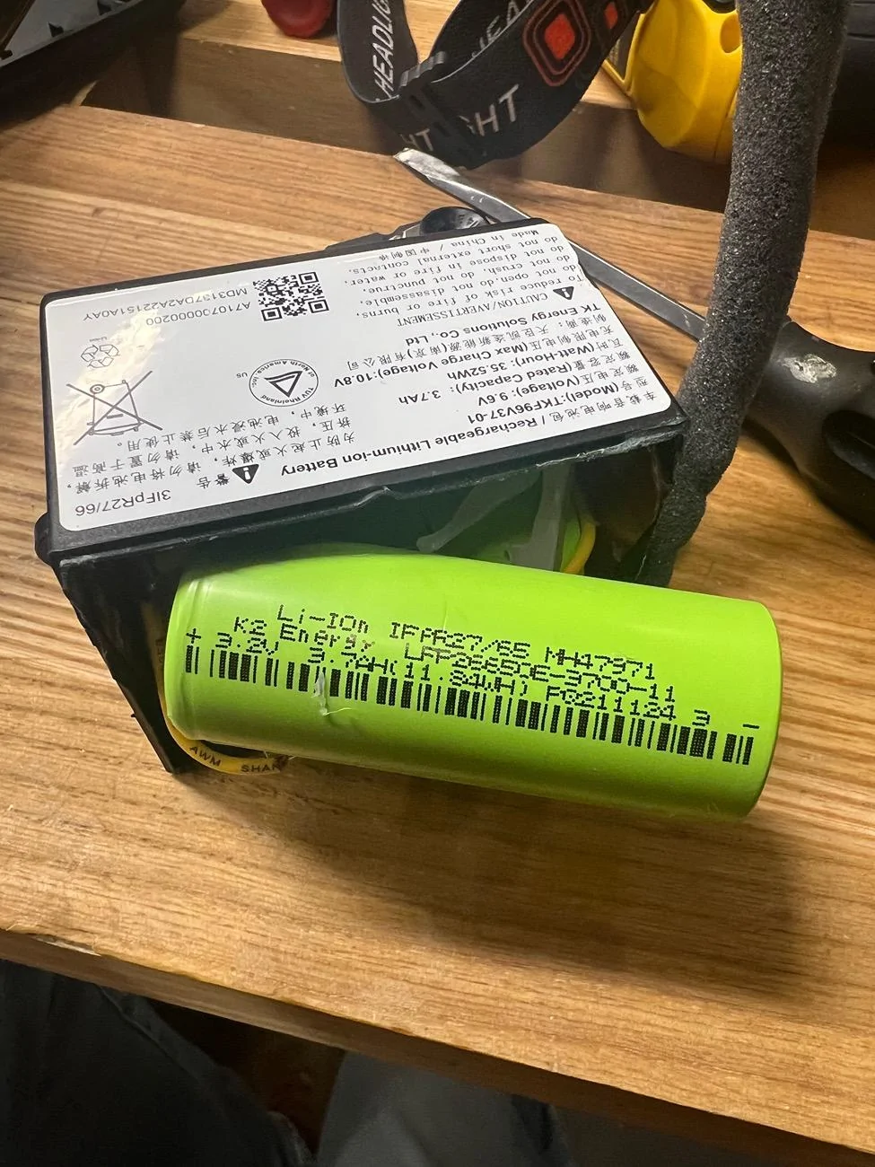

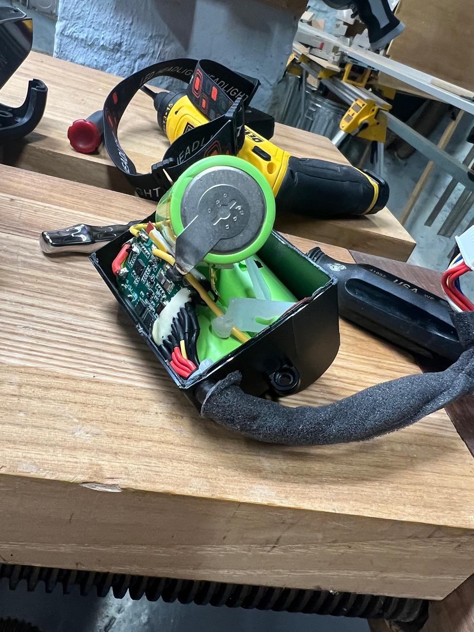

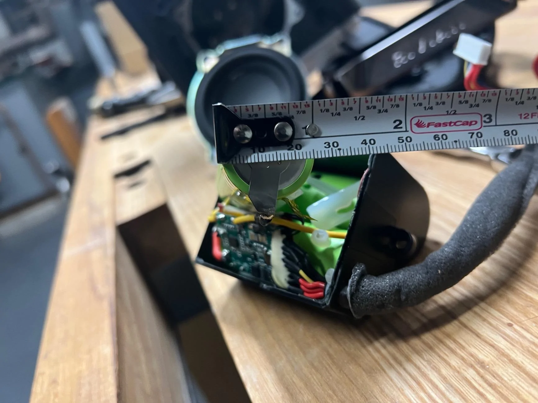

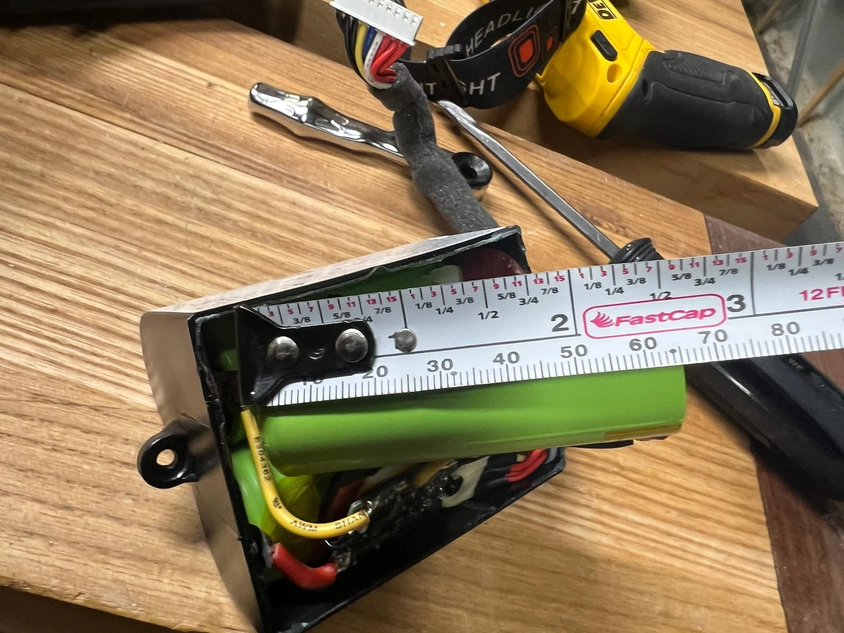

Pretty far down this rabbit hole - I doubt I will ever get out successfully so I ordered a drawer today. Here are some photos of the cells. I am not familiar with them.

That's interesting that it uses 26650 batteries instead of 18650 batteries in the battery pack.
https://www.batteriesinaflash.com/amfile/file/download/file/443/product/17051/ looks to be a data sheet on the battery cells in the pack. If you had the ability to spot weld tabs onto individual cells, you could replace the cells inside the pack.

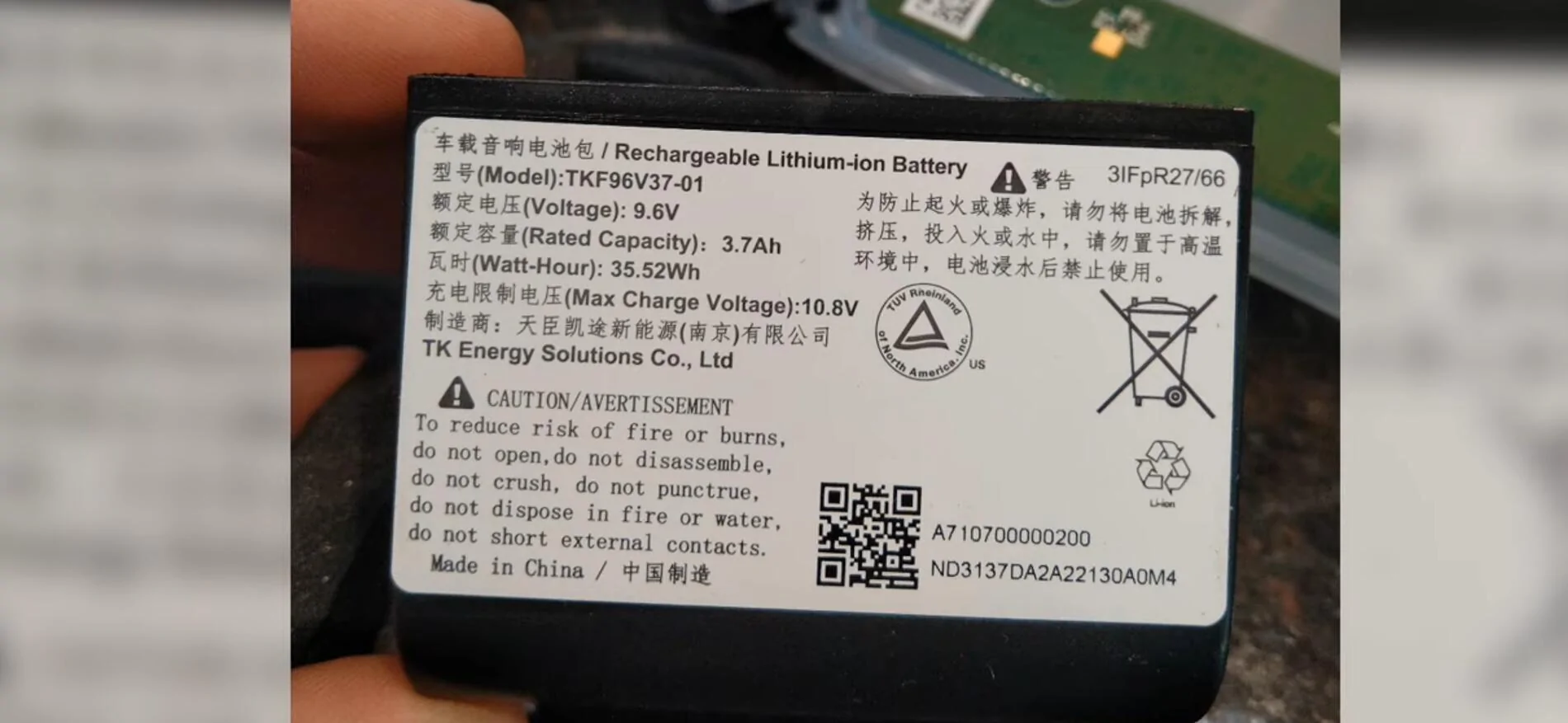

Looking at the details on the label on the battery pack, here's some of that translated with Google Translate. The text above the "do not trash" symbol is some safety warnings ("do not disassemble :) , put in fire or water, etc..."). I did find a TK Energy company with google, but it seems like a different company than would make a battery pack like this. The line of Chinese text above TK Energy Solutions translates as "Manufacturer: Tianchen Kaitu New Energy (Nanjing) Co., Ltd."
The text at the top left of the label translates as "Car audio battery pack".
Interesting details, but I didn't really find something that looked like you could order a ready-made battery pack.

26650s are on Amazon for about $20
