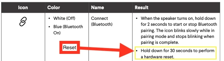

I had the same problem this weekend when camping in Camp mode. The docked speaker started making its "connect" bong every 15-20 seconds. I was in my tent trying to sleep. Locking the car seemed to stop it and I fell asleep.
When I got home, I started unpacking the truck and the speaker (still docked) started bonging again every 15 (or so) seconds. I did a soft-reset vs factory-reset (see attached photo) and the bonging has stopped.
I don't think this is a priority for Rivian to track down and fix. Some of service center folks know about it and some don't. Most think it just the nature of Bluetooth. I think the soft-reset is something I'll just need to do occasionally.
Rivian R1T R1S Camp Speaker Wakes When Truck Sleeps camp speaker reset
