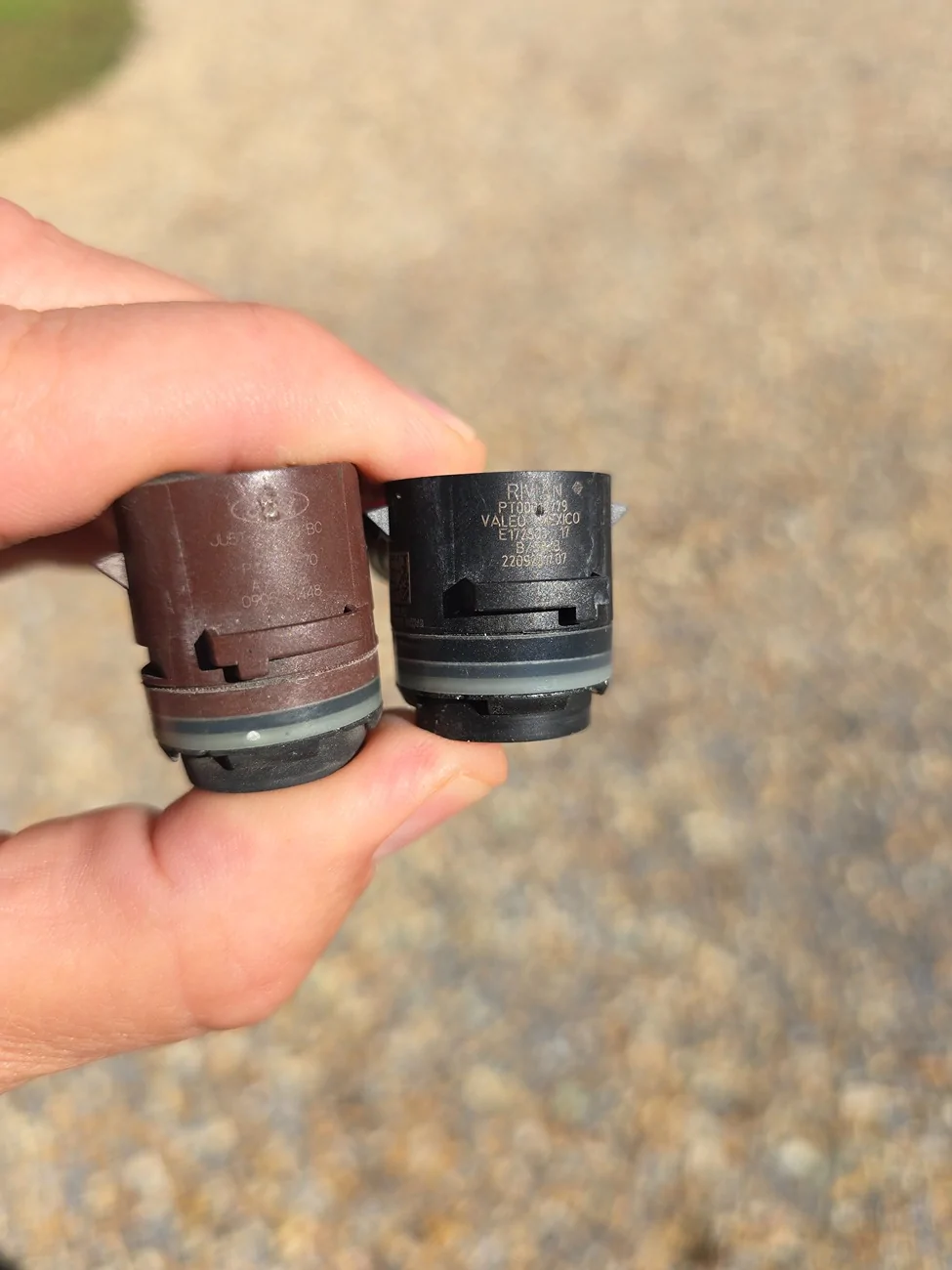

I had a very similar issue for a while after first buying my 2023 R1T and finally after showing a mobile tech (thus proving I wasn't crazy) he convinced his hierarchy that we should just replace the sensors. When he did, he noticed one sensor that was not the same as the others - it was a Ford sensor... seems crazy but it didn't surprise him. Either way, I haven't had a single issue since
I went back and found a pic I took of the sensors that were replaced. The one on the left has the Ford logo but it's obscured a little by the glare in the pic... The one on the right clearly shows Rivian.
