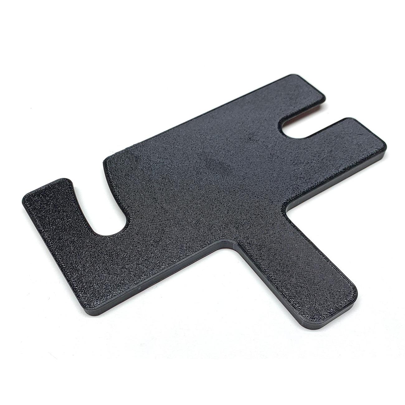

Random Maker
If you have access to 3D printing you can print one of these little tools I designed. If not, you can buy one on my webshop. MUCH easier than struggling. A bunch of forum members have downloaded and printed one. And a bunch have bought one. Everybody seems to love it.
Ray
Rivian R1T R1S Car Seat in Back RHRRT-top-2048

It does move. You can get the tool or struggle with it for 5 min while sweating and swearing. I chose the second option :(
Ray
I ordered your tool. If it works (I am sure it does) you are a genius! It should not be an impossible task to safely buckle in a child's seat. Thumbs down to Rivian on this one.

Random Maker
Just shipped the tool. I'm pretty sure you'll shake your head and grin after using it. Too easy.
Ray
I printed one of these a while back and just used it this morning and it worked perfectly. Well worth not having to strain and cuss to release that thing by hand.
