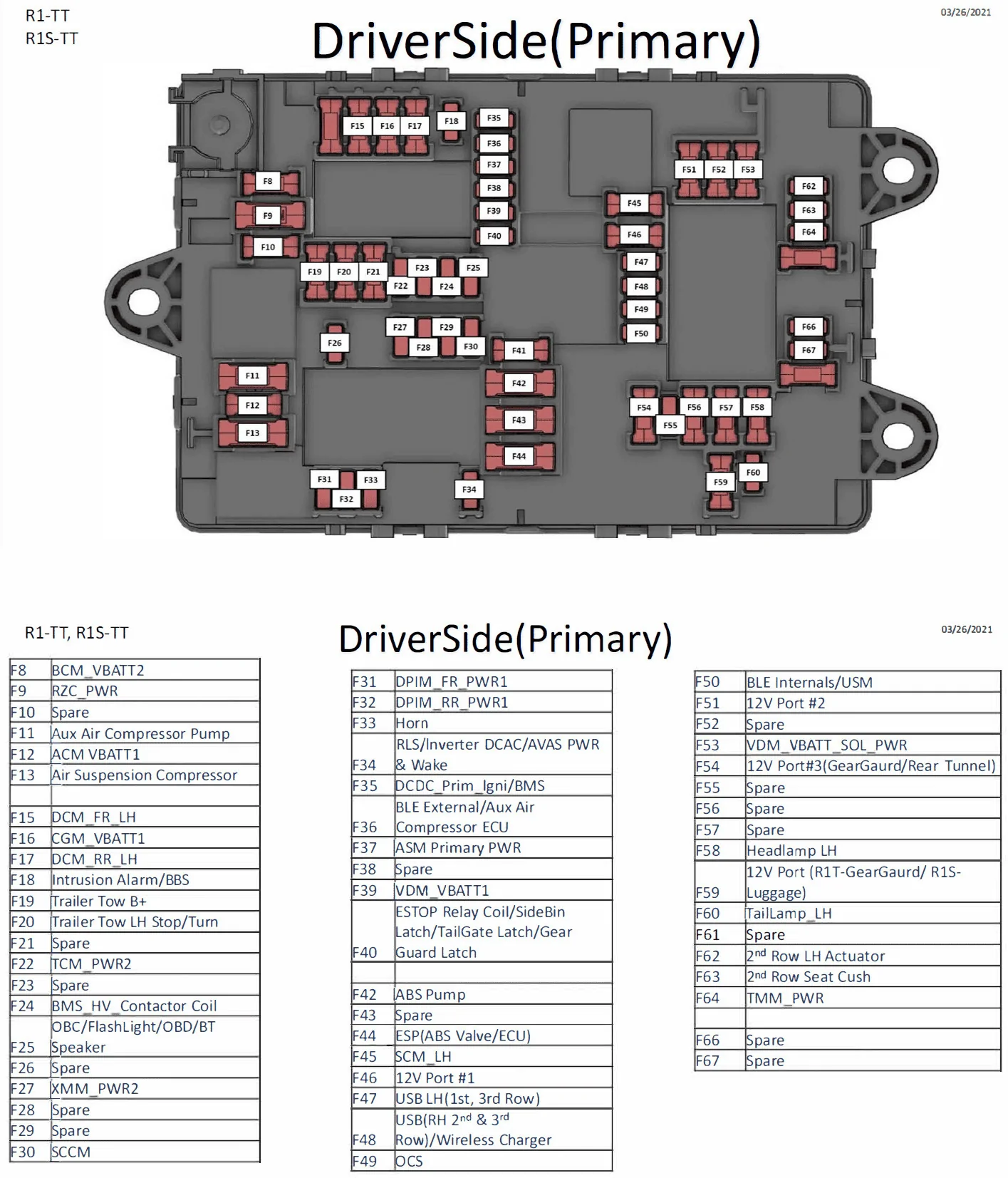

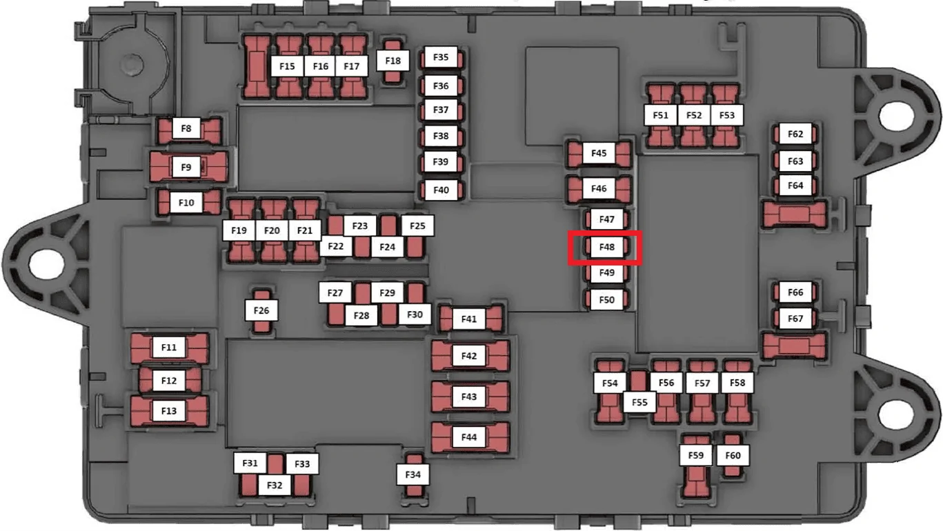

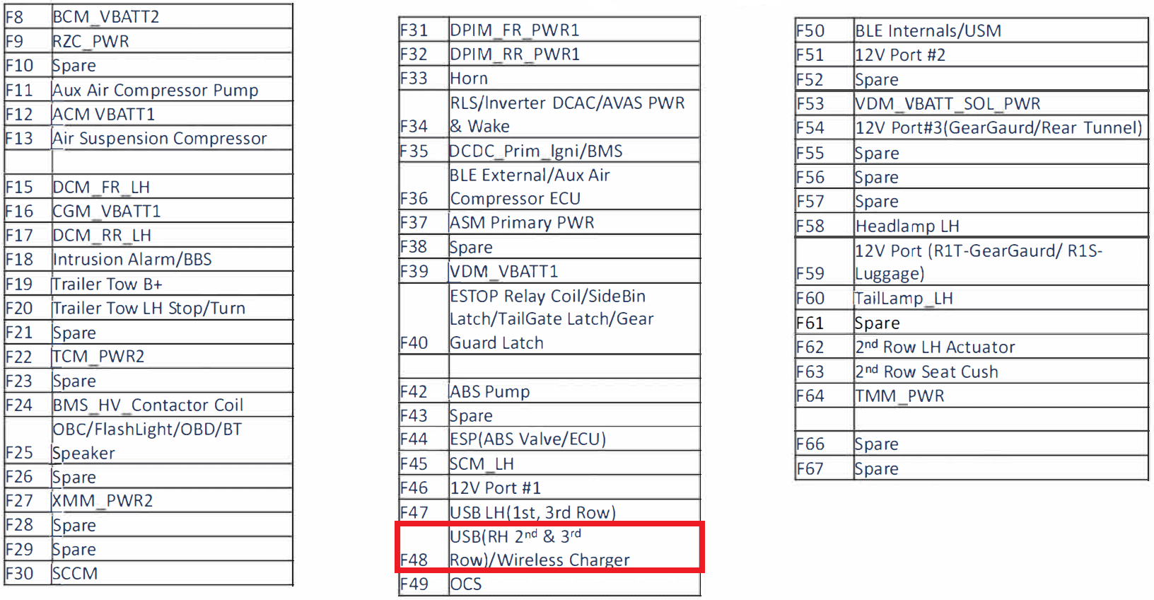

Hardwire went fine and I prefer it at this time. It's growing on me more and more each day. One question...does the charging pad work thru the same fuse? Mine quit working after install.
The fuse EV Sportline taps is "F48".. see below for description...
As an alternate you could tap "F47".
NY_Rob thanks for the info. So my guess is it does affect the wireless charger. Guess I will see what EV sportline says.
No, if the Smart screen is working, there is no reason another circuit would be down.
@EV Sportline @jebinc @Mcdubjr
Even though I have a 12V in the center stack in my R1T, I hate seeing wires and decided to hardwire this last night Into the recommended F48 fuse. I ran and hid the wiring pretty easily. I was very surprised at how easily and conveniently the dash pad comes up. I went straight across the dash to the driver's side door as others have done. The display mount is rather brilliant in my opinion. Very well done @EV Sportline.
The EVSportline CarPlay/AA display powered up but also IMMEDIATELY cut off charging on my precious StowNCharge, which is just a pair of Apple OEM MagSafe pucks hardwired into the OEM charging pad plug (and mounted in the best tray and storage solution ever).
When I unplugged the EVSportline CarPlay/AA fuse tap and re-inserted the OEM 10 amp fuse, my iPhone 15 Pro immediately started charging again on both MagSafe pucks mounted in the StowNCharge.
The display then would NOT power up via my 12V, but thankfully @jebinc researched that and I know I need to get a QC adapter. The one I have has USB-C PD ports. I'll try it again when whatever I ordered arrives and see if I can live with the visible wires.
Is there another possible fuse that can be tapped safely while maintaining full functionality? Is there a workaround to using the same F48 fuse? As @NY_Rob pointed out in that fuse chart, the display and OEM charging pad are on the same circuit and apparently, for a handful of us at least, do not play well together.

@shrink as an alternate try fuse F47 "USB LH (1st & 3rd Row).
That fuse only powers existing USB ports where fuse F48 powers USB ports and the built-in phone charging pad.
Rivian R1T R1S CarPlay & Android Auto Smart Dash Screen has arrived!  New from EVSportline.com 1704469980507
shrink
Feb 16, 2021
103
1,398
2,722
Appreciate the tip.
So for testing purposes, F47 would power the 2 USB-C’s in the center console and what else?
It’s an R1T so there is no 3rd row and it looks like F48 powers the USB-C’s on 2nd row displays and back of the seats, and OEM charging pad?
Am I reading that right?
If I stick with a hardwire solution, I’d want to test everything relevant while the display is on rather than being surprised and annoyed later when trying to use a port.

@shrink, according to the description.. F47 only powers the left side 1st and 3rd row USB ports and since you have an R1T.. looks like it's only the front center console USB ports? I'm guessing the front seatback and rear console USB ports are covered by F48 "2nd row USB"?
You could always pull F47 and see which USB ports no longer work.
