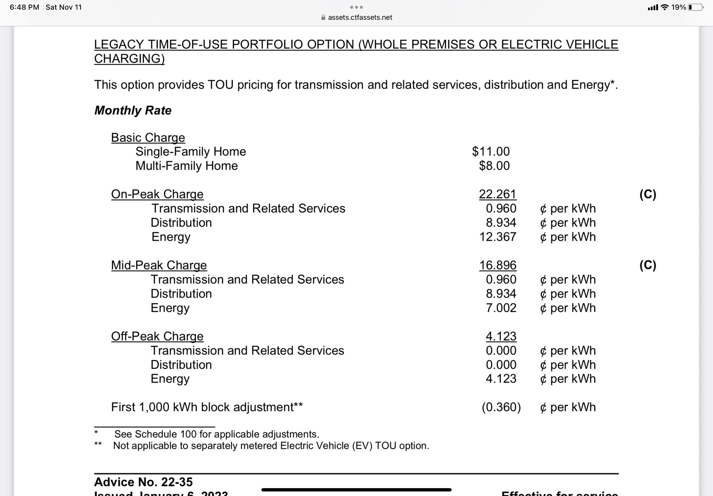

Are you really only paying an extra $0.0036 per kWh once you eclipse 1000 per month? I’m assuming you also use PGE, so please disregard if I’m wrong. One reason I couldn’t ever switch to TOU is because it says it’s an additional $0.36 per kWh over 1000, not just $0.0036. Like you, I oftentimes go over 1000 at least a few months per year - the worst I ever saw was 1715. That would mean an extra $257 on top of an already hefty bill just for using TOU (would probably be close to $500 for a single month!). But if you’re actually only paying $0.0036, that might be worth the gamble.
That is confusingly shown on their website. It is zero point three six ***CENTS**. $0.0036.
I would add that on the TOU plan that I have I actually get that 0.0036 as a credit up to 1000kWh.
Yep, that's the same plan I'm on. High five, fellow PGE customer!
