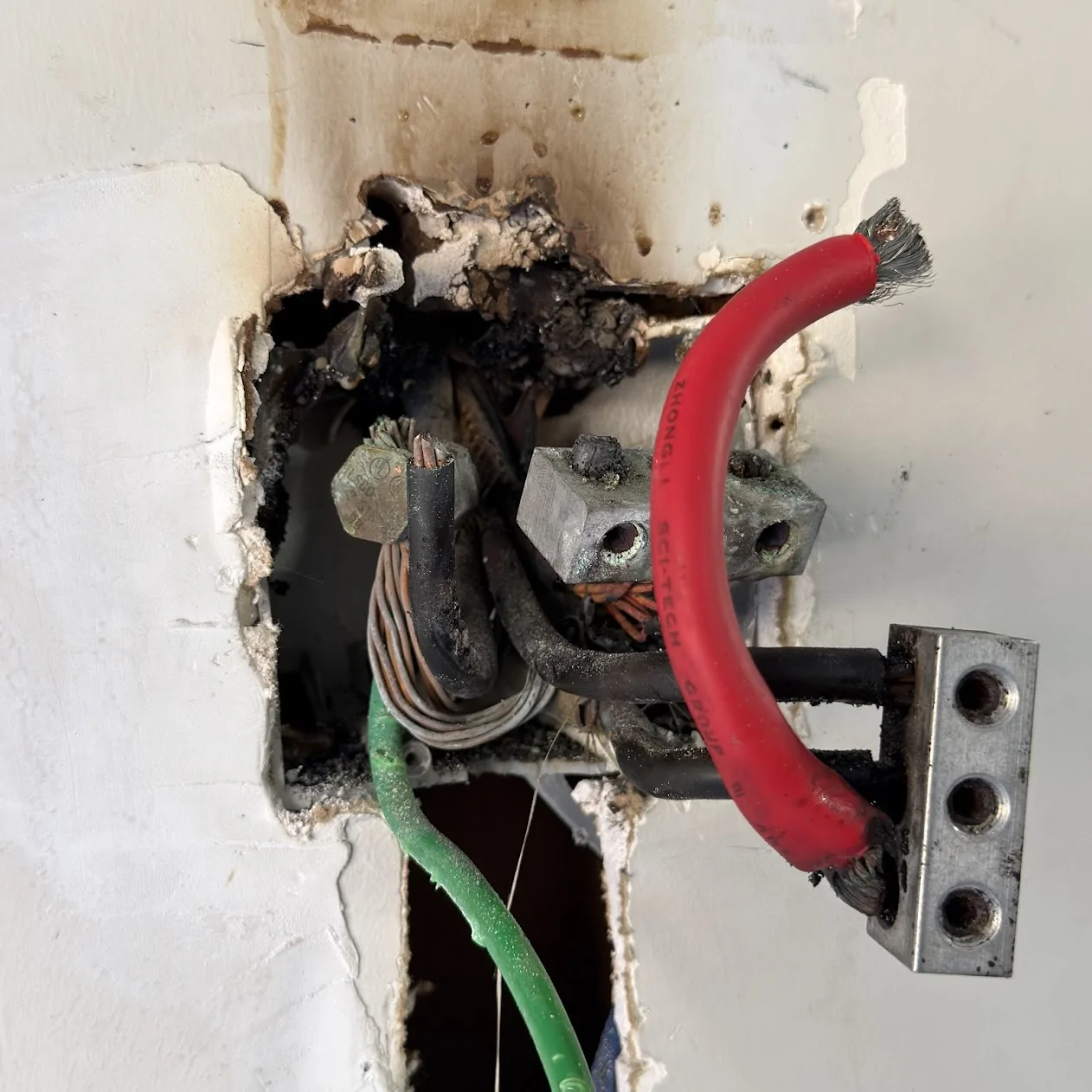

Can confirm. This is the aftermath of two chargers (one each side of a shared wall). Neither would charge, although they were both green until they tried. Mr Melty got close to Mr Burny. All fixed now, and no damage to the chargers.
