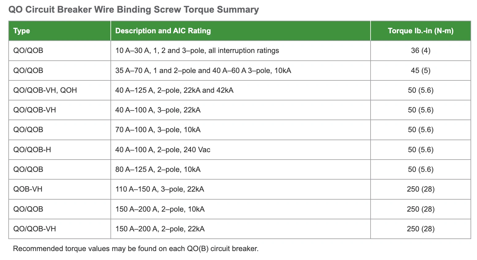

If you can torque much more than 70 lbs with a "screwdriver", remind me not to arm wrestle you. ;)
The torque rating for the conductor lugs of breakers is general measured in in-lbs. And usually in the 30-50 range.
lol, but typical circuit breakers and terminals are typically in the range of 20 to 60 inch-lbs.
Here's a Square D type QO spec sheet calling for 50 in-lb on 40A to 80A breakers. That's 4 foot-lbs. Can exceed that with a large screwdriver or 90 degree screwdriver, let alone putting vice grips on the screwdriver, which I have seen some people do..... 😱

Or you can just crank it until it will not go anymore - which I found to be 70+
Given how 50 inch pounds felt with a torque wrench, I probably wasn't getting there with a regular screwdriver. This probably explains my melted receptacle, at least in part. I reefed on the philips terminals of my old 14-50 with a #3 driver and one was only finger tight when I did the autopsy. A lot of the 14-50s need 75!
