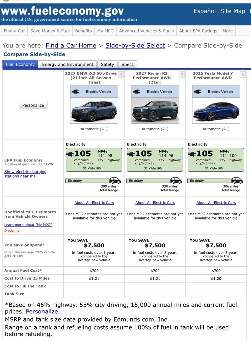

I specifically pointed out the BMW iX3 gets much better highway mpge at 70mph than either R2 or MY. This has nothing to do with a bigger battery.
7,533
12,916

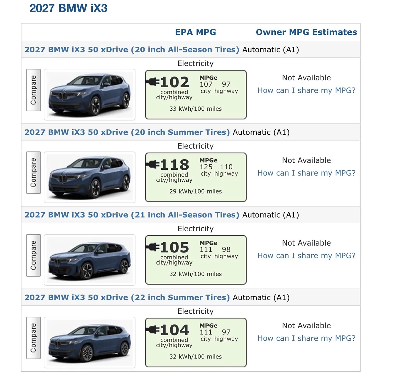

interesting with the exception of the 20 inch summer tires the ratings are very similar to the MY and R2 performances. With a drag coefficient similar to the MY why do you think it would be so much better on the highway? They all look pretty similar.
Rivian R1T R1S Coast to coast race: Model Y vs R2 (ABRP simulation) IMG_4717

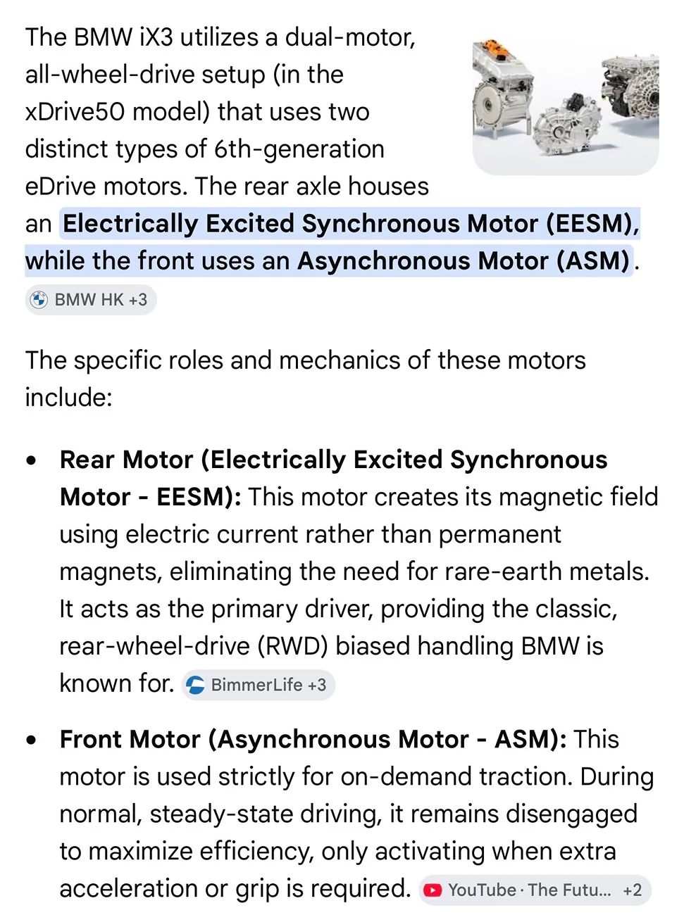

I think BMW did a much better job at reducing the drag from the motors at highway speeds, unlike the R2 and MY, where you’re “fighting” against the electric motors.
More info on BMW motors whereas Rivian and Tesla use permanent magnet motors only (I believe)
That does not show in the MPGe ratings. Looking at those 4 sets of numbers, I’d almost think the 20 inch summer tires are so much of an outlier that the numbers are suspect and probably should be reverified.

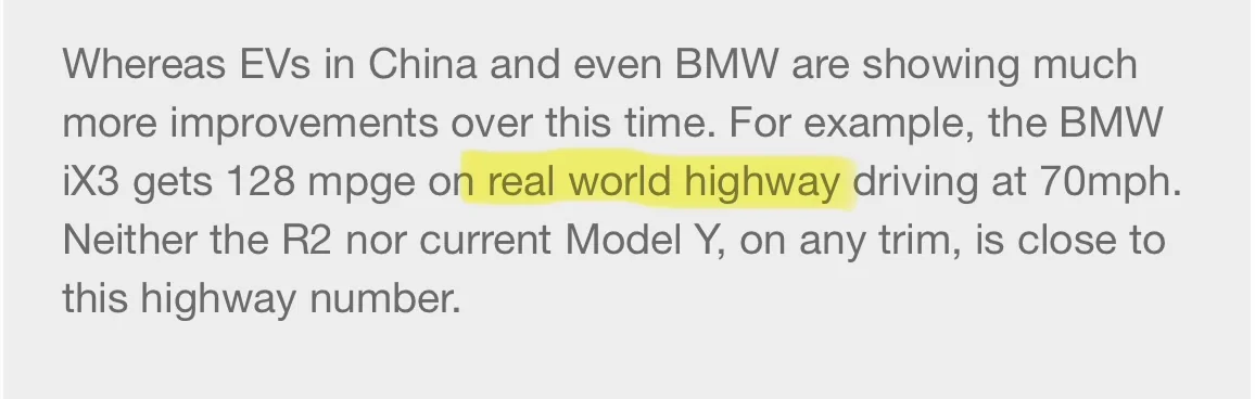

I’ve always said actual highway mpge for the iX3. The extra battery pack and better charging speed are added benefits. Read it over again.
Edit: I’ve highlighted it for you.

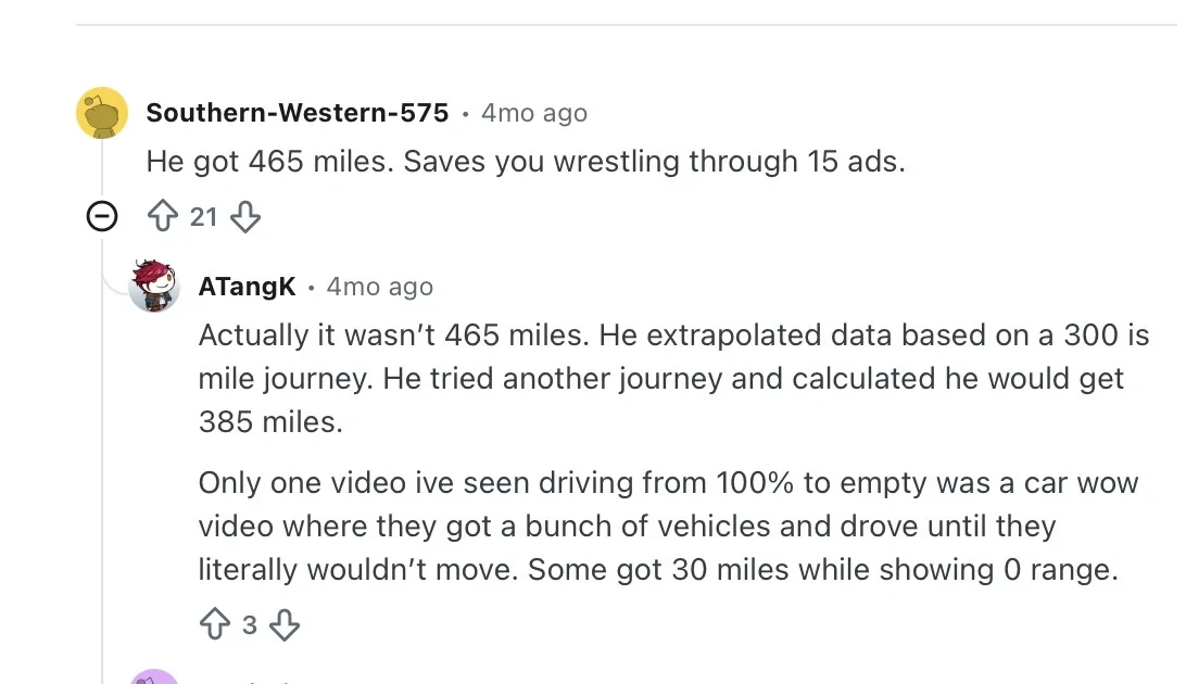

First comment says it was a number extrapolated from a 300 mile trip, a second try was lower. Still pretty impressive range.
Range is not one of my main concerns for an EV, my longest stretches are typically less than 140 miles on road trips, then I stop, stretch my legs, and charge keeping the battery % low for faster charging.
I still think Lucid has some of the most efficient hardware, shame they are not doing better. Would be nice if someone with more business savvy would purchased their hardware tech.

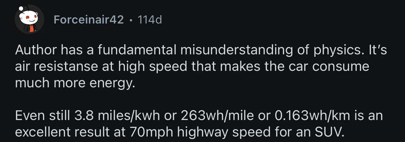

I’m not talking about range. I’m talking about EFFICIENCY at highway speed. So 300 mile sample size is plenty for data
I converted 263wh/mile to 128 mpge since that’s what everyone is looking at here for some reason.
Did you even read the article you linked? He got nowhere near 500 miles range. I’ll even use the higher 385 miles number in the calc below for you. R2 is a high riding big box, of course it’s not going to be as efficient as something thats a lower to the ground egg. That has nothing to do with efficiency and everything to do with design choice. This is why the Model Y actually has a vastly superior mpge than all 3 bc it’s an egg.
