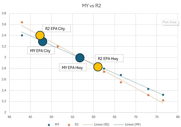

They appear to be almost the exact same effiency, looks like MY may have a slight advantage over 65 mph and R2 a slight advantage under 50 mph...
I'm not sure either one has a significant advantage over the other (except for the fact the R2 has a bigger battery and likely more range under similar conditions). The newer non-performance MY is a different story, likely 20% more efficient than the R2...
Best apples to apples comparison is the MYL to the R2, both are 88 kWh batteries, looks like MYL is roughly 5% more effiencient...
MY and R2 are tied between ~50 to 60 mph
Under 45 mph R2 may be slightly more efficient
Over 65 mph MY is 5% more effienct

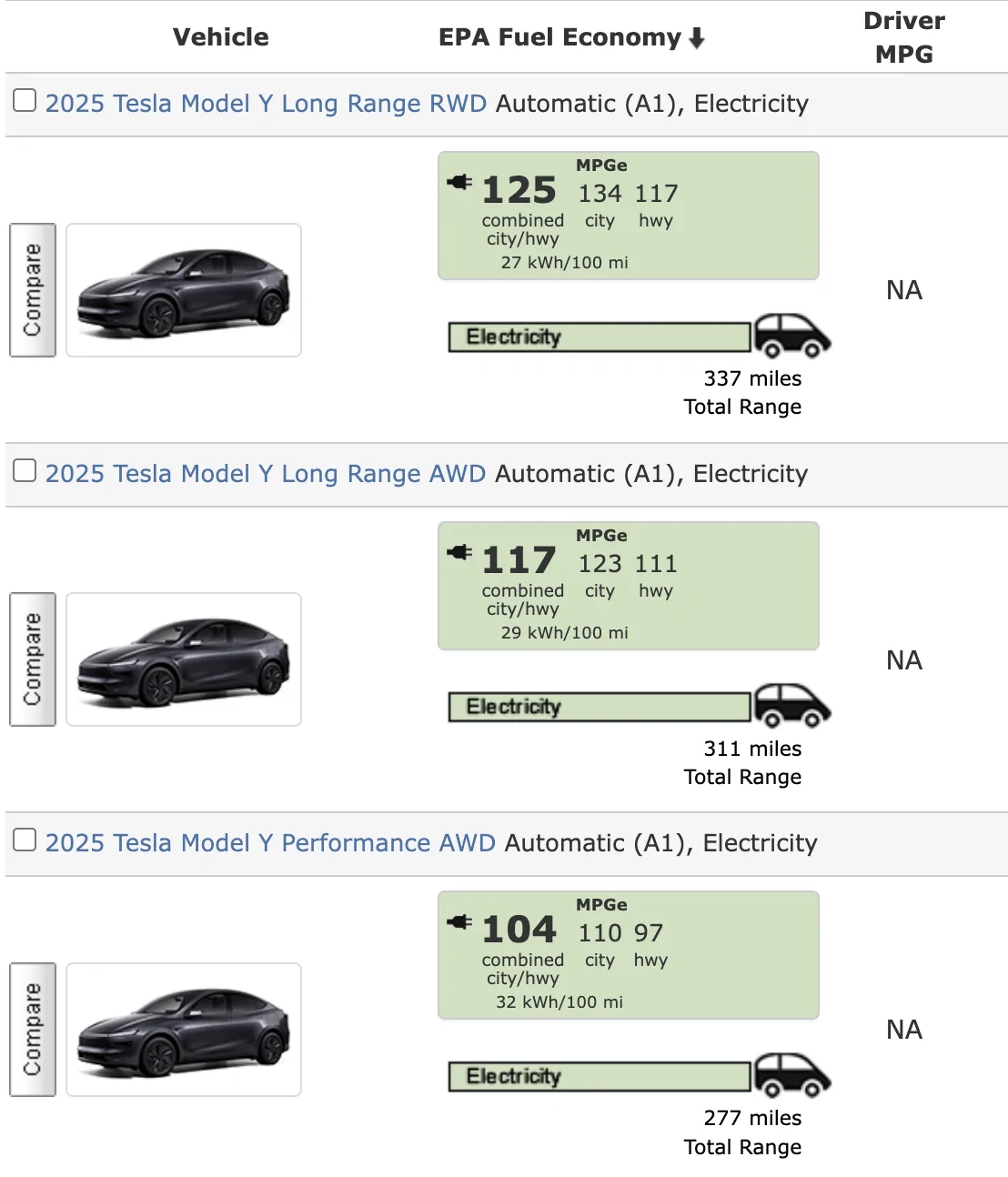

Not really, you just want to compare the least effiecient MY to most efficient R2, which is fine...
According to the EPA:
>Base Model Y returns 138 MPGe,
>Model Y Premium RWD returns 125 MPGe,
>AWD version sits at 117 MPGe, and
>Performance AWD returns 104 MPGe
OP was wrong. I don’t care what is in ABRP, the EPA figures are the like for like comparison to use (so mpge).

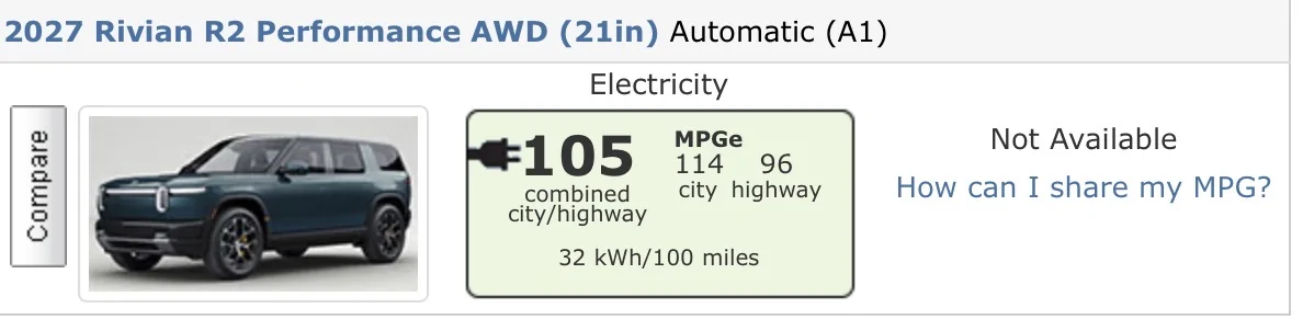

I see the OP’s Tesla’s numbers on fuel economy’s website.
And the R2’s (performance) fuel economy shows:
- 105 combined (114 city, 96 highway)
So, we’ll have to wait and see what the R2’s nonperformance numbers look like.

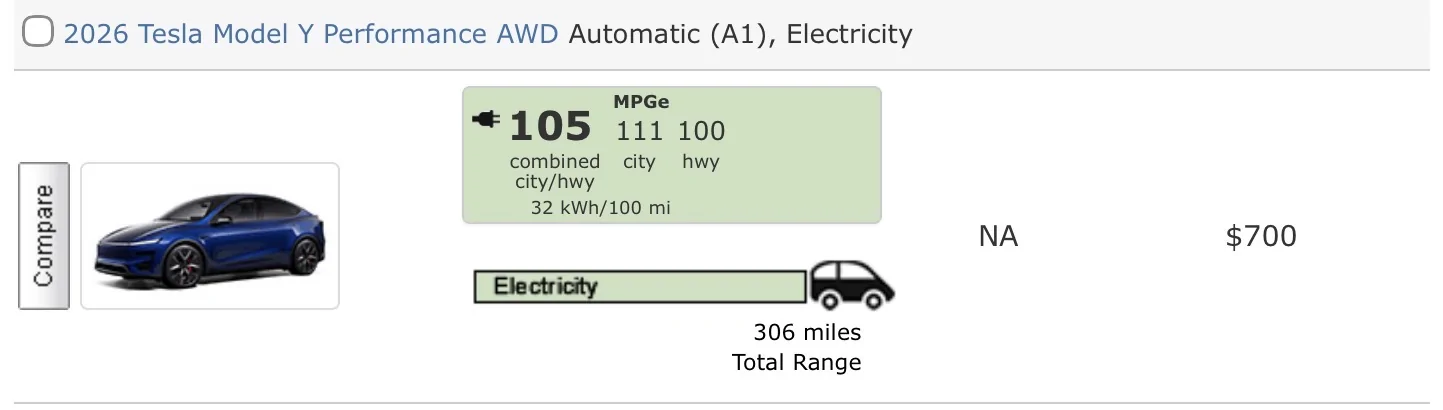

Would apples to apples not be these 2 Configurations?
Yeah not sure what the arguing is about here. R2 P has a bigger battery so goes further in the city where aero is insignificant, while Model Y P has better aero so goes further on the highway where drag is the biggest range killer. Should be Performance trim vs Performance trim for comparison.
