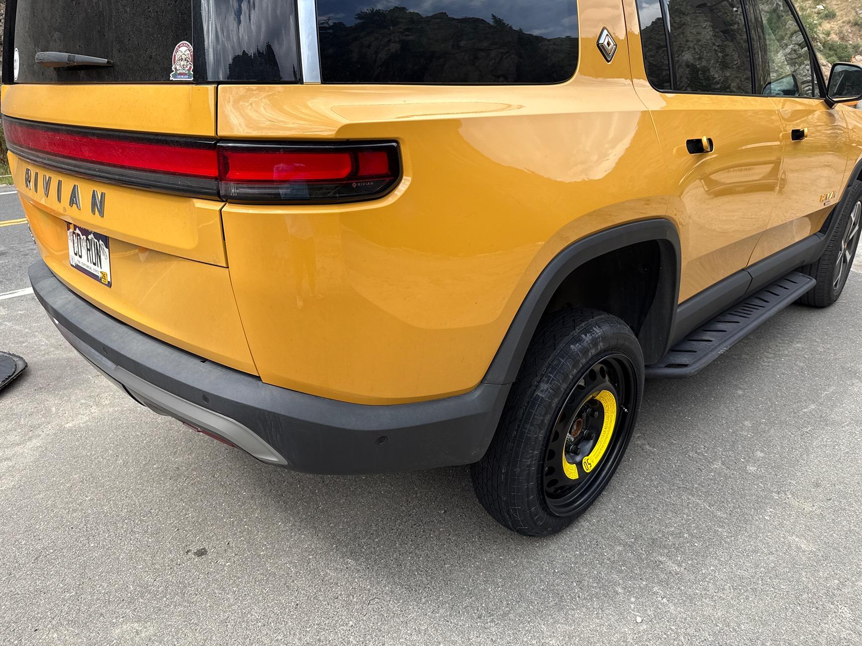

I don’t suppose anyone has a spare 21 inch tire they’re willing to give up/sell ? Coming down from the mountains this afternoon I got a puncture (hole in the tire wall), fortunately I had one of these kits, but my tires only have about 6000 miles on them so would really rather not buy another set… thanks
Rivian R1T R1S Colorado Checking In image
usulio
Jun 2, 2023
1,046
1,295
Ouch. I don't, but when I had a flat, I had a good experience buying a single replacement tire online, at this forum's advice, I used United Tires and looked for one that matched my current tread depth. https://www.utires.com/t/b/Pirelli/?size=63062

thanks all. I had no idea there were so many for sale on the Facebook marketplace. Full sets of wheels and tires out there. I think I'm set now.
