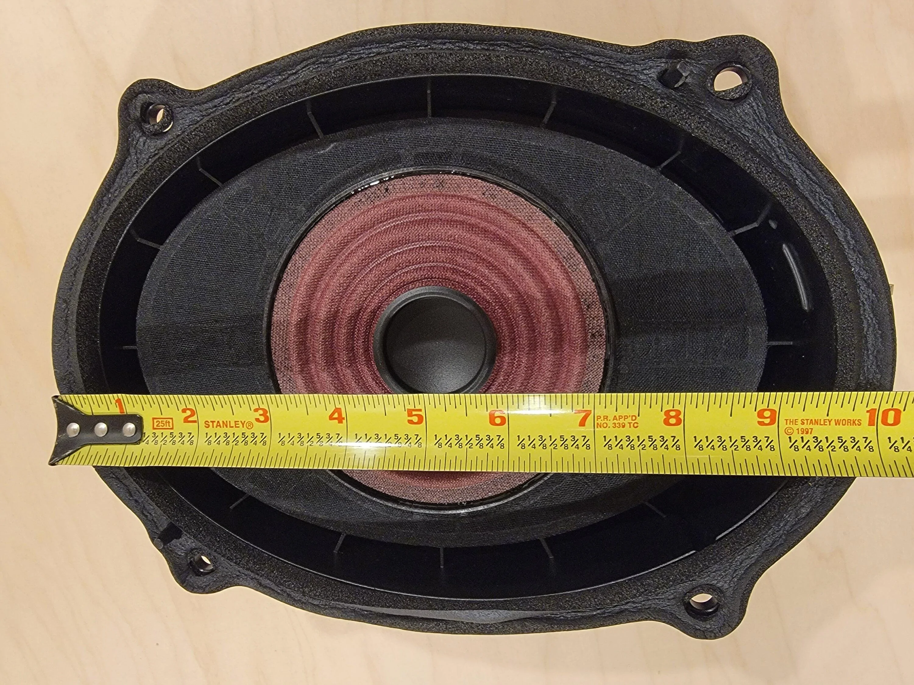

You're right, it was 10" initially - modified original thread.
The Rivian 'sub box' is pretty terrible too, we couldn't get rattle under control.
Ended up switching out JL 10 (replaced Rivian sub, unplugged).
Put a JL 12TW3 with factory box down in spare tire cavity *** no more rattle *** and hits way harder. Much cleaner at low volume filling low freq even at casual listening.
Very happy with results, good clean build.
