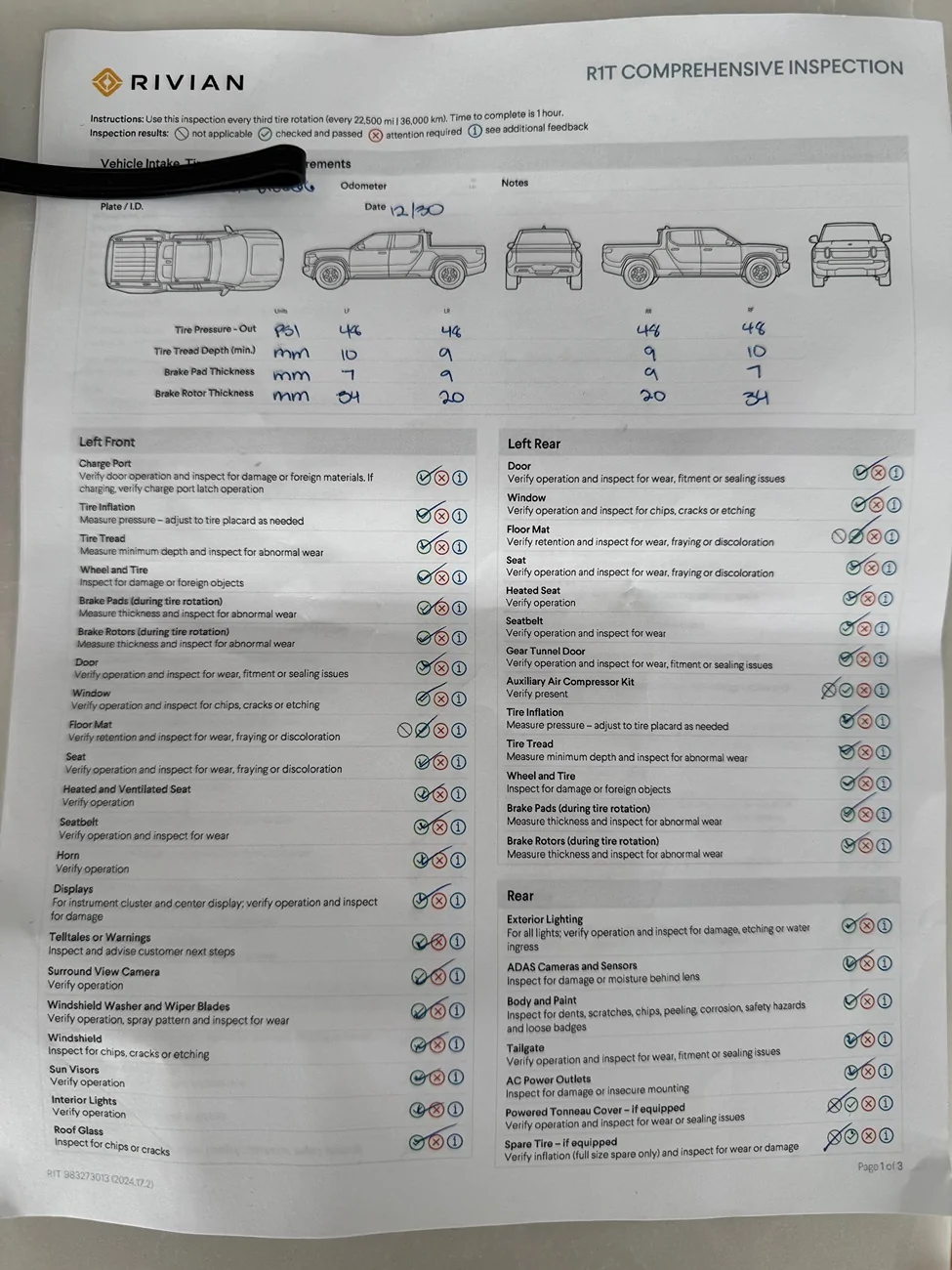

They list each wheel and corresponding suspension separately LF LR RF RR
I just paid for it at 59300 something miles and they found front seals leaking and replaced them at about $400 each
I look at it as $300 warranty expiration check out that IMHO was well worth it
Edit to add picture this is one of three for the R1T
Rivian R1T R1S Comprehensive Inspection Includes? IMG_4566
Thanks for sharing. shouldn't the front seals leak be covered under warranty?
You are correct
The billable cost was the $400 but it was covered under warranty by Rivian
