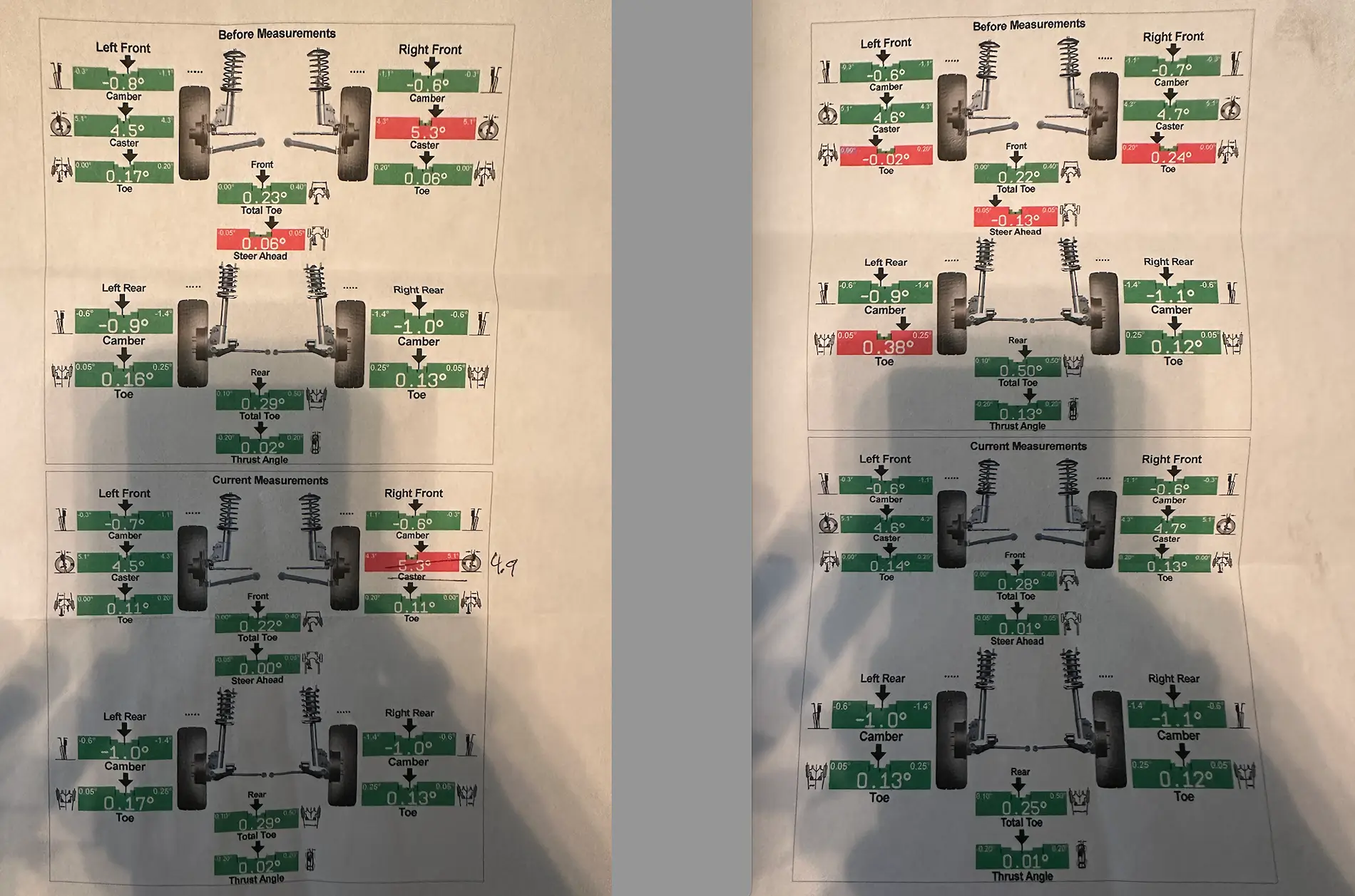

I don't have the first alignment that was done but these are the 2nd (left) and 3rd (right), there might have been a 4th that was done as well. But there was maybe 50 miles of driving between these.

that's quite a bit of change in toe, both front and rear, between the #2-after and #3-before. it should not be changing like that. you need to push Rivian to figure out why it changed so much over only 50 miles. interestingly for the front, you lost about 0.13 deg of toe on both sides shifting the left front from the proper amount of toe-in to a little toe-out. On the front right, you lost the same amount pushing that wheel into excessive toe-in. So for the front, that might suggest a problem with either the steering rack or subframe as it seemed something moved affecting toe on both sides equally. I'm guessing something at the left rear just wasn't torqued properly during the #2 alignment.
Rivian has told me this is normal as, to paraphrase, “if you put a truck back on the rack right after you put it on you’ll get different numbers.” The amount of times I’ve been told the vehicle driving as it has is “in spec” is very frustrating and not confidence inspiring.
I’ve been pushing for them to escalate beyond alignment for engineering review as that is not an acceptable answer and the alignment has not resolved any of the steering issues.

The cross caster will cause the pulling. If you have a severe shock issue where it dives, you can get a cross camber issue that causes it to pull.
I would mark the cam positions, right after aligning it, with a marker and see if they slip after driving. If they do then they weren't tight or have a mechanical issue
yes, a slight variation is to be expected. however, the amount of change in toe your printouts show is absolutely not within normal variation. the slight changes in camber and caster I would chalk up to normal variation.
Thanks for the input. Have a call with the regional lead scheduled so hopefully that info moves the needle...
