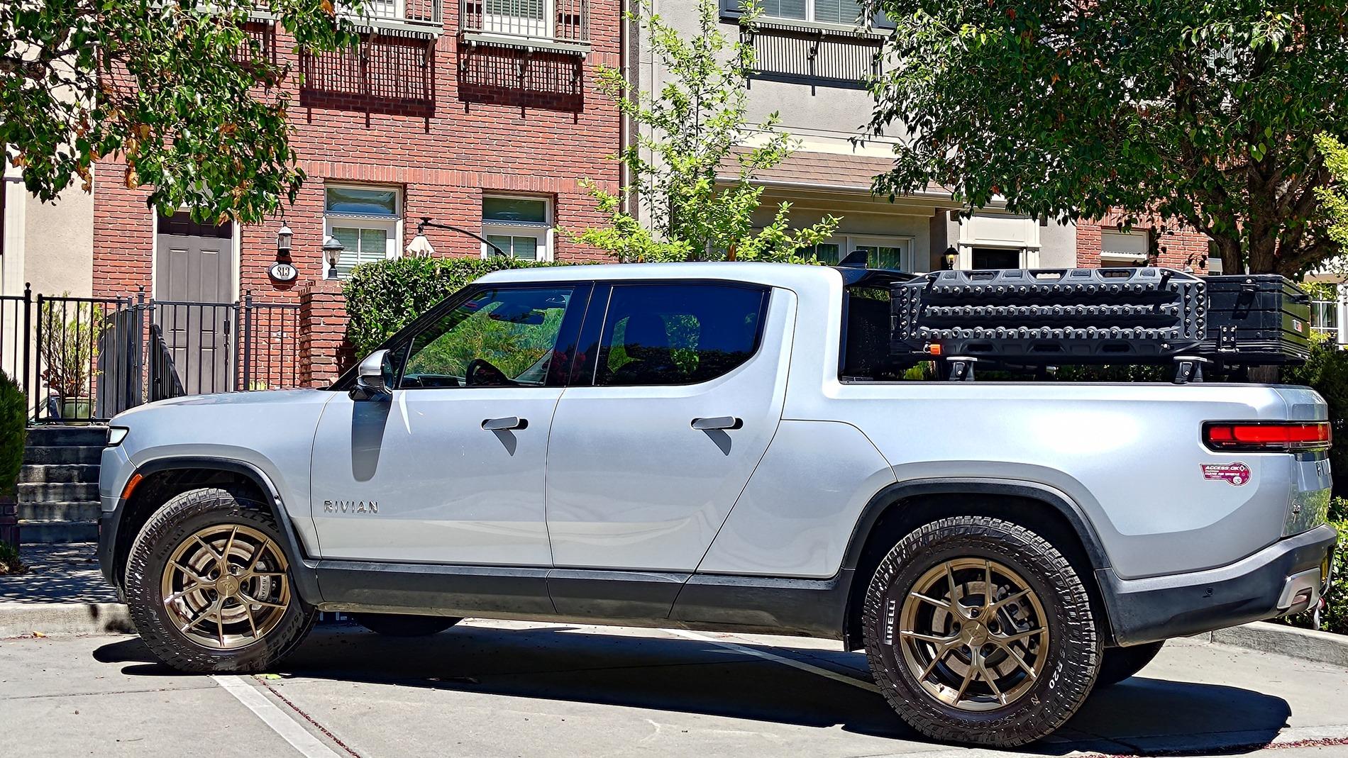

Loving the look/color and now debating on if i want 20" or 22" LOL. 22" looks on these wheels would be amazing but Im tired of the harsh ride.
So one of the things I did not expect, was these AWZZ's impact on ride quality. I can totally feel the change in unsprung mass (suspension is noticeably more compliant over broken pavement) as well as rotational mass (steering feel is much lighter).
No idea how that will scale from 20s to 22s and vs. the OEM 20s vs. 22s, but all things being equal more lighter should help the harsh ride regardless of wheel size.

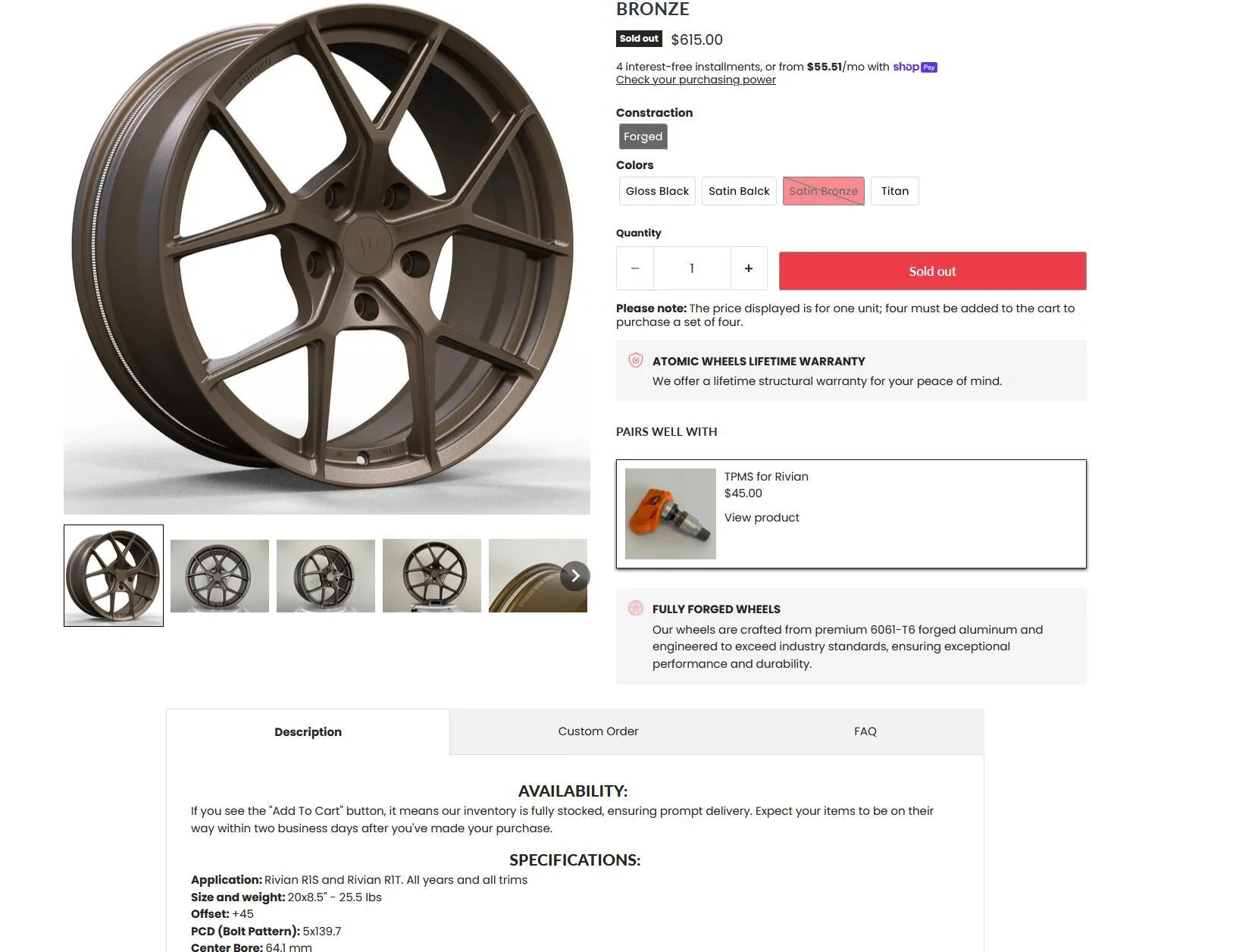

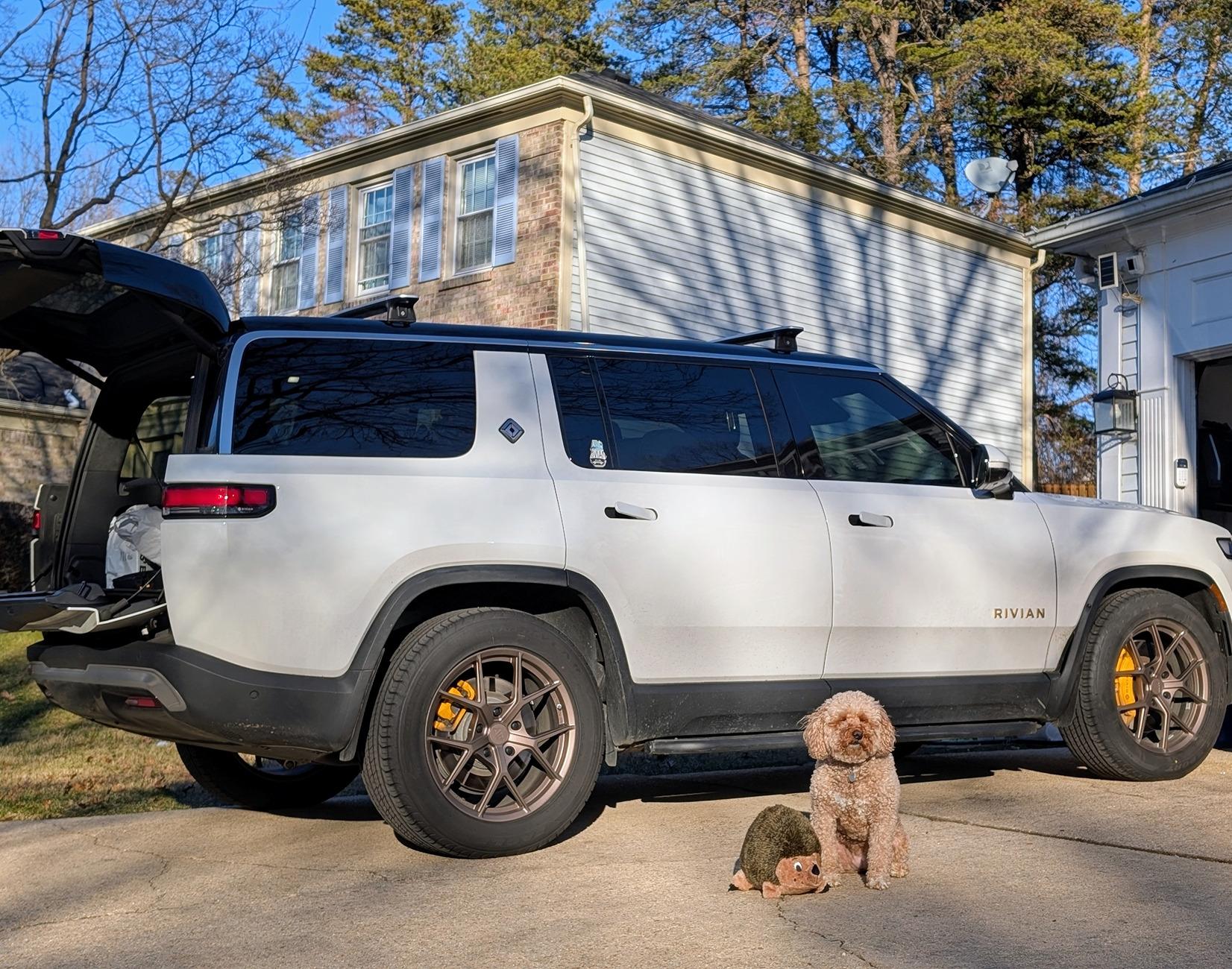

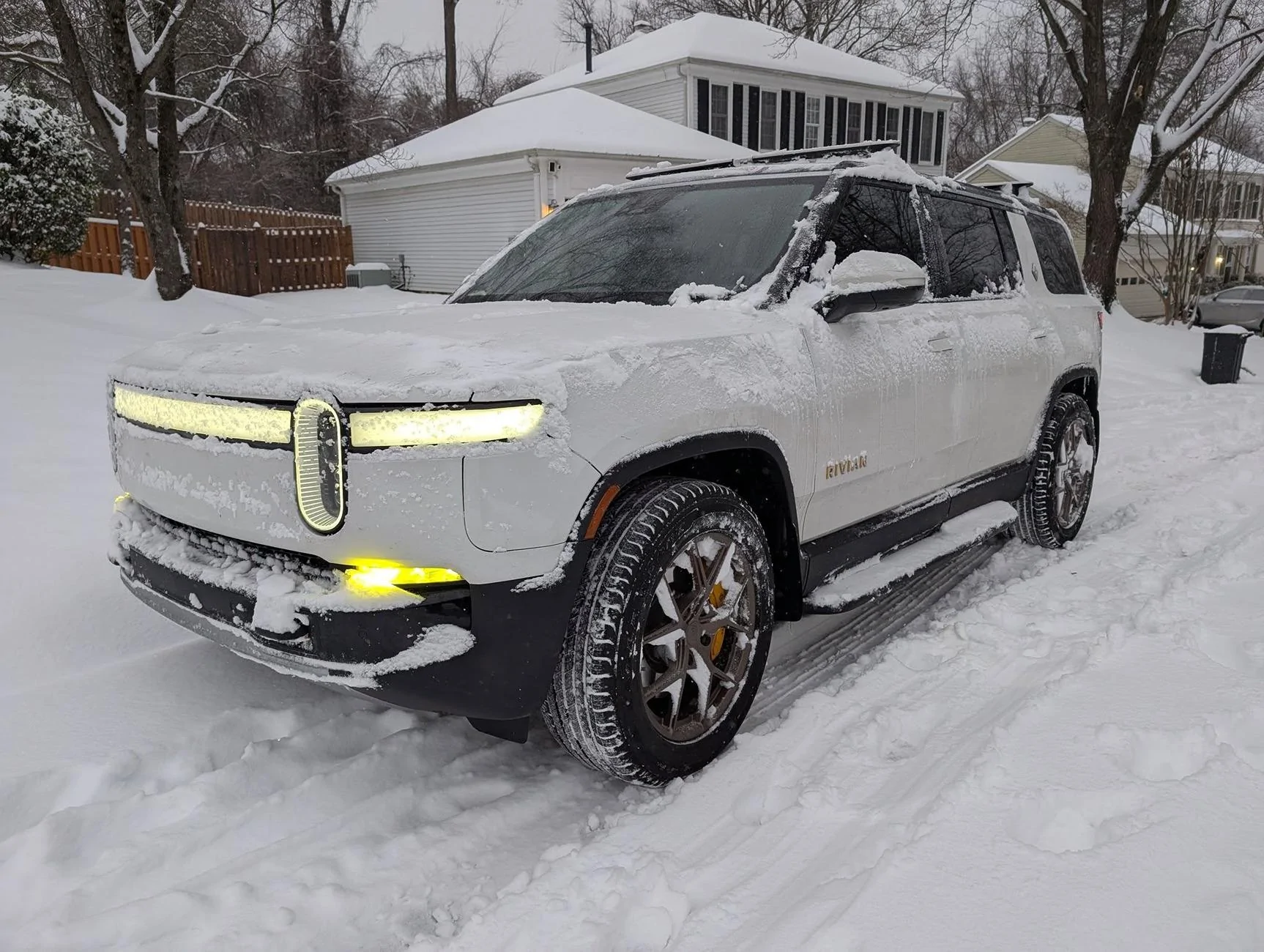

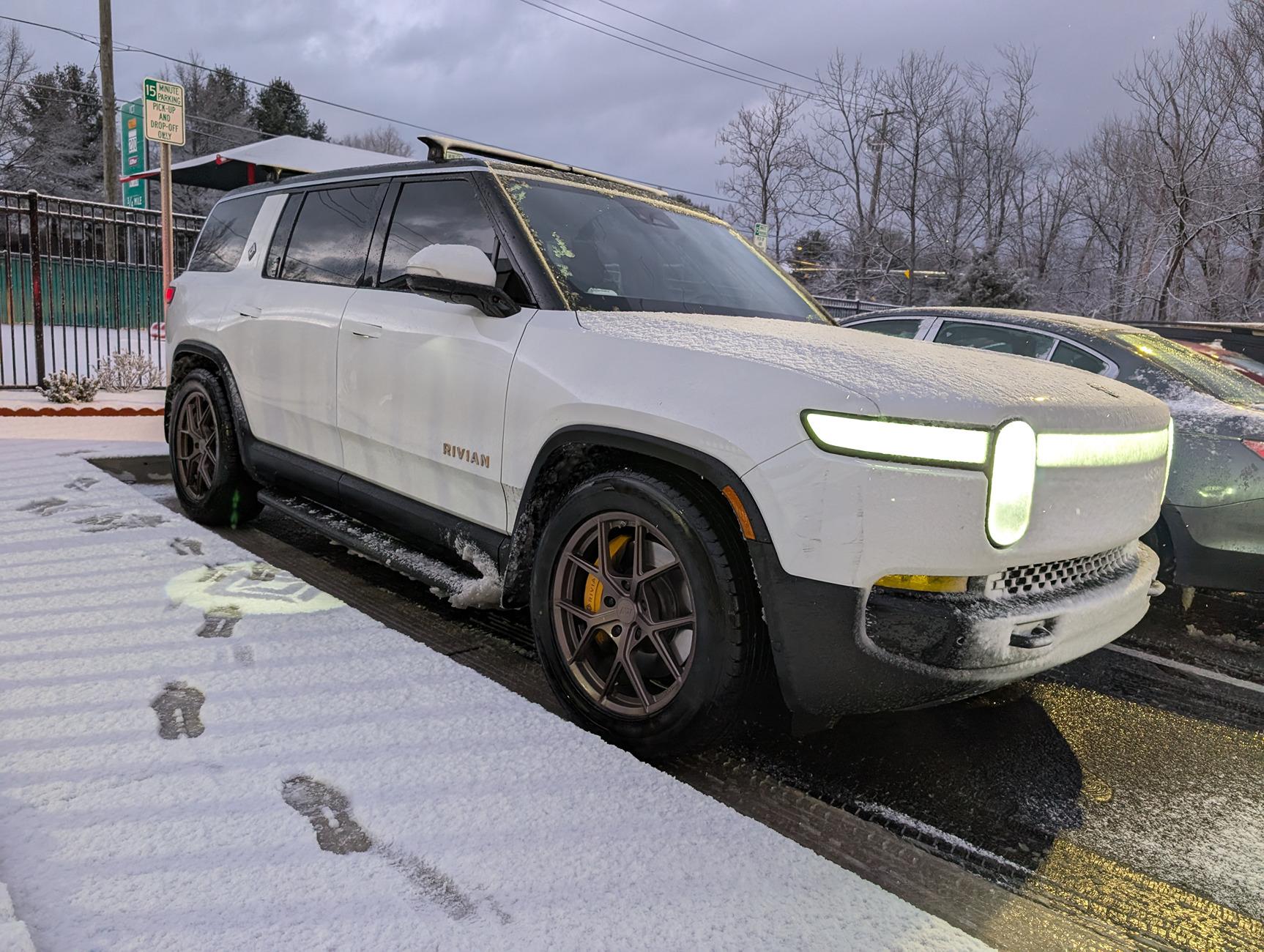

Here is my Combo
Rivian R1T R1S Creating the Ultimate Wheel/Tire Combo (Help Needed) 1732683654467-tk
Rivian R1T R1S Creating the Ultimate Wheel/Tire Combo (Help Needed) 1732683692633-

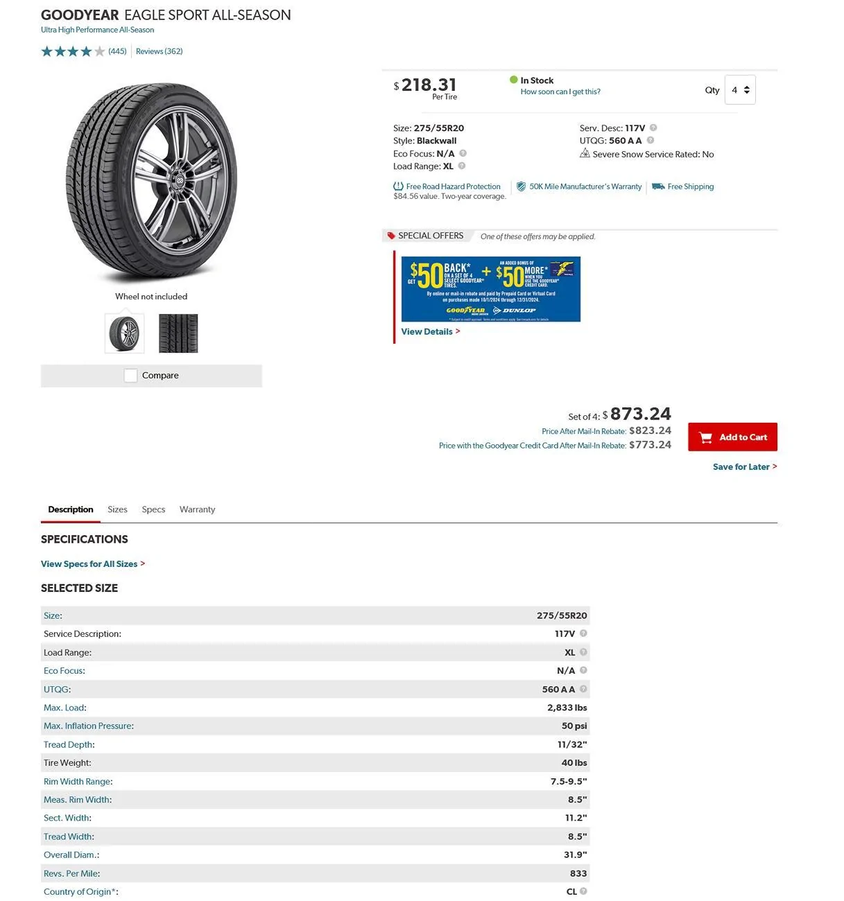

Stock 22" set weighs 83lbs vs my 65lbs. about 18lbs per corner savings, a better tread/compound tire w/ more tread depth, better traction then OEM 22's and cheaper.
The only difference is the 2.5% odometer difference which ill happily pay with all these benefits of grip, efficiency and longevity.

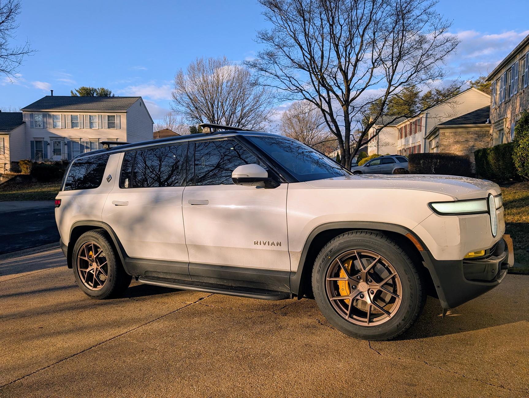

Big aesthetic difference as a result of the 32“ diameter tires vs 33” (or optional 34”) — was this a consideration? Please post pics when available. Good luck.
Not really. Didn't even think about that but not sure if it would make that much of a difference personally I think anything that's not a AT tire looks small so I don't really care.

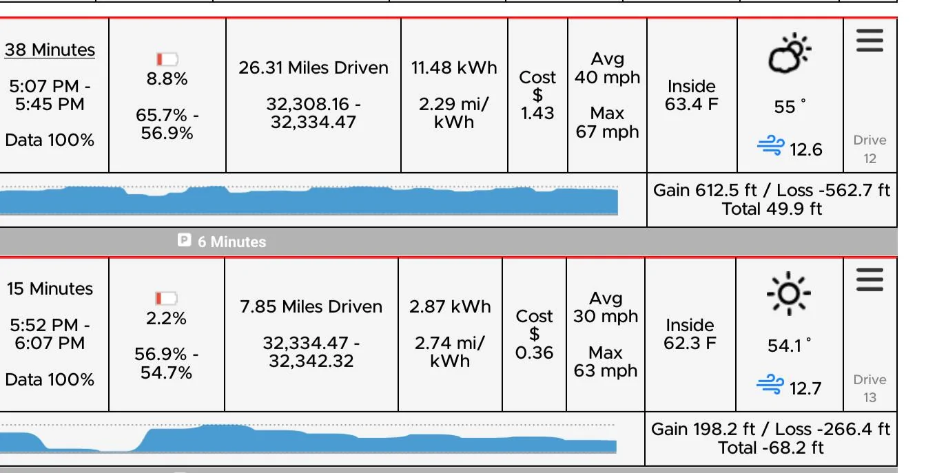

Here is a highway run with a 13 mile an hour cross wind, low setting, 47 psi in all purpose mode. Used driver+ 70mph on main stretches.
Your new tire set up causes an artificially elevated efficiency because your truck thinks it's moving 3.5% further per mile. That's almost 0.1w/mi. So not accounting for all your efficiency jump, but definitely a portion
Tesla Fi calculates it based on raw data (how much used vs how much traveled) so this should be accurate.
