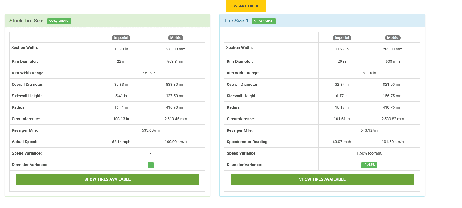

So doing some research from a spec perspective I found this
Rivian R1T R1S Creating the Ultimate Wheel/Tire Combo (Help Needed) 1716750639741-xq
Rivian R1T R1S Creating the Ultimate Wheel/Tire Combo (Help Needed) 1716750686787-uz
Let me know if I am wrong or just being too nitpicky lol. Also would love input.

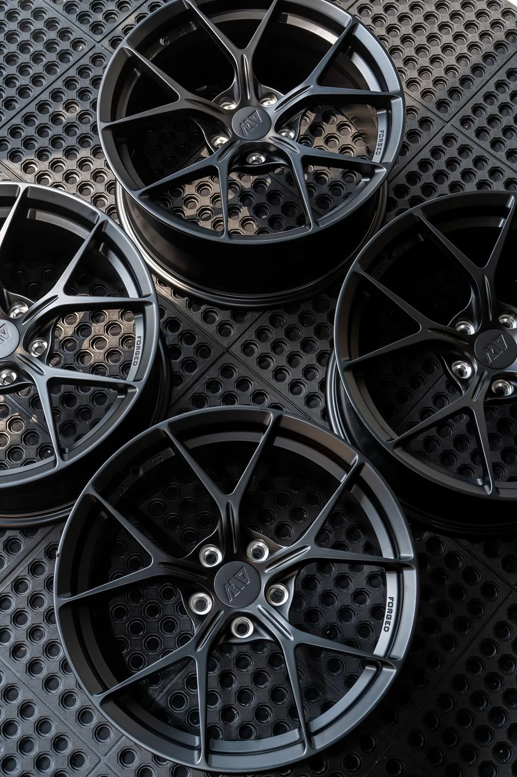

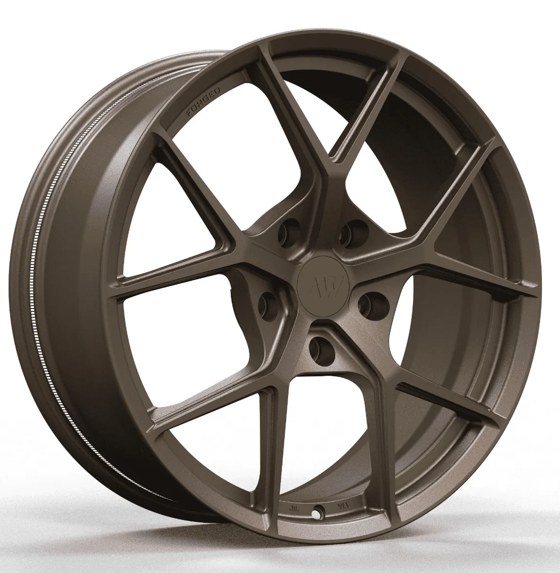

Just in case you need even lighter wheels, we have another design—AWZZ. We haven't made them for the Rivians yet, but we are happy to produce them as a custom order or any other design you like.
Rivian R1T R1S Creating the Ultimate Wheel/Tire Combo (Help Needed) AWZZ Model Y-04
Specs?
Atomic Wheels
Oct 7, 2023
329
358
Dallas, TX
Rivian
Any specs you need. Regarding weight, I think for 20x8.5, we can achieve less than 25 lbs, while keeping the same 1170 kg payload. The exact weight we will know after we design the 3D model of these for Rivians.
We will do it in the next few days and I'll share the outcome.

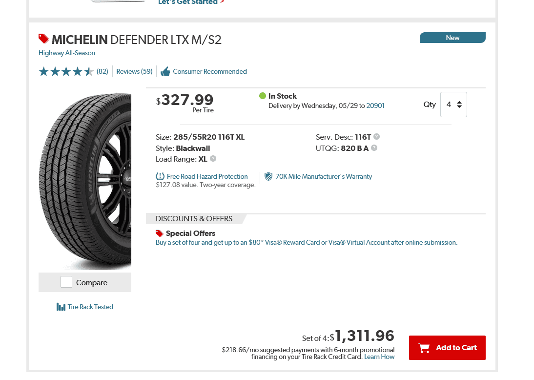

Based on what you described your use case is, I think you would be very happy with the Michelins. And they would look great with those wheels. If you don’t need an AT tire I can’t really imagine a better set up.

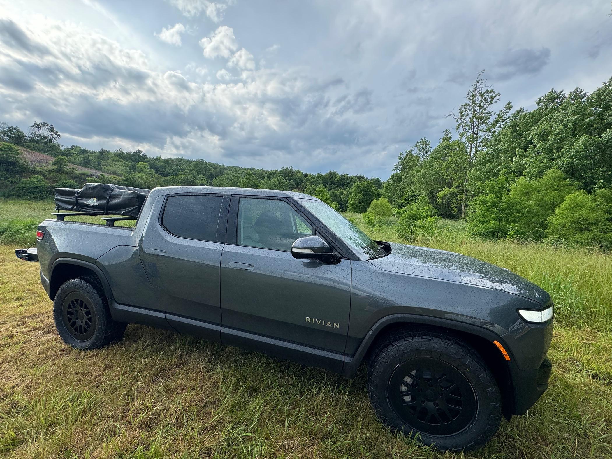

I am mid testing. But so far with the Martians and the Toyo EVs, I love this thing. The 22s are the spirited smooth road driving champs. But damn does this 20” combo go “best of both worlds”.
Rivian R1T R1S Creating the Ultimate Wheel/Tire Combo (Help Needed) IMG_5869
Jiri
Jiri
Mar 28, 2022
145
Washington, DC
R1T, 1983 Defender, 1999 Defender, Tesla Model 3
Sidebar: yes. In that pic the truck is leveled for camping and that feature rocks!
