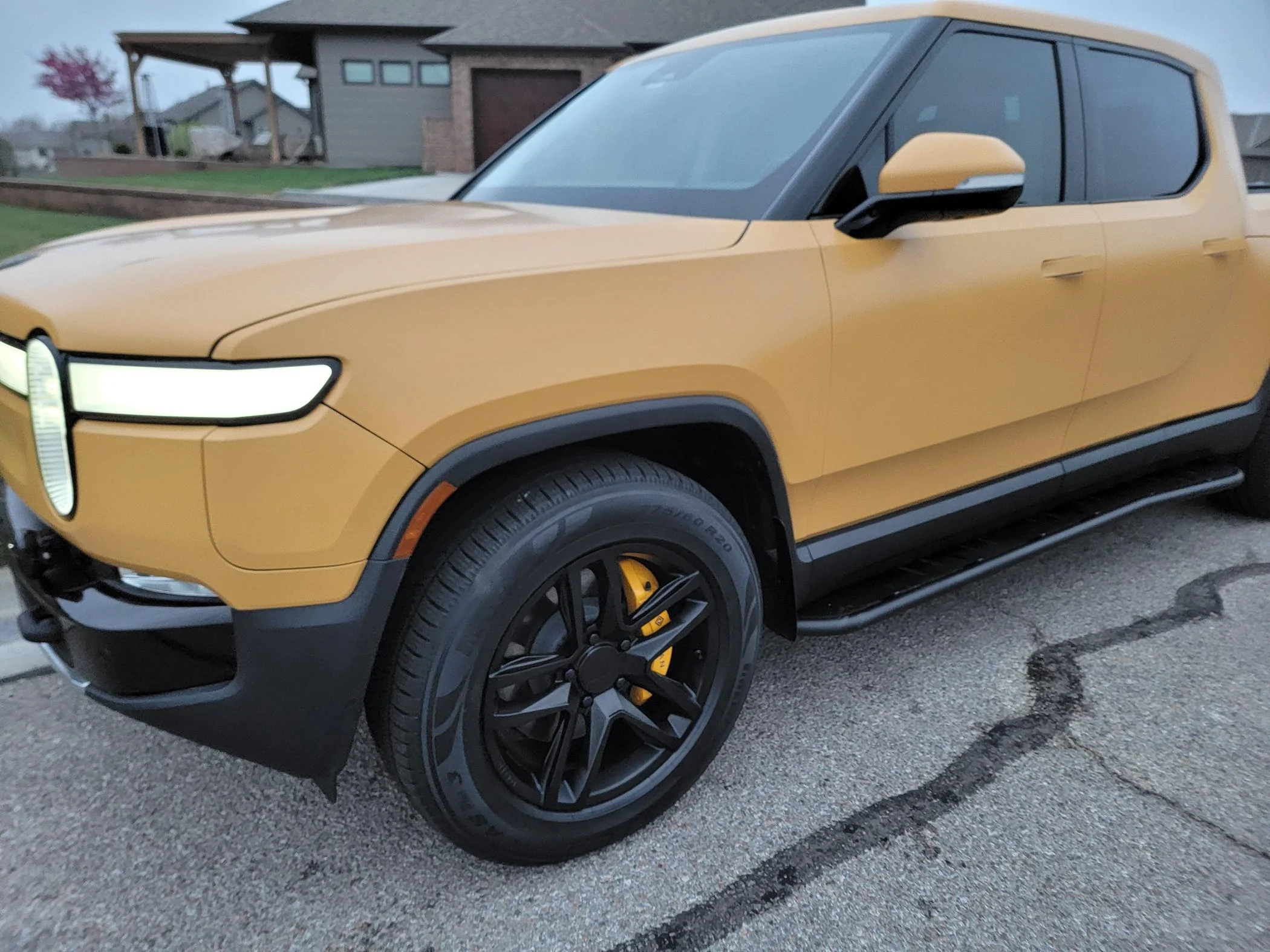

Atomic for the win. If efficiency, very good handling and great comfort are what you want. I'm very happy with Pirelli AS Plus 3 20 275/60. Look way better and cheaper than 21s and same to better efficiency.
Any efficiency data you can share with this setup?
Looks like a solid setup and imagine your MPK has to be pretty high, maybe >2.5?

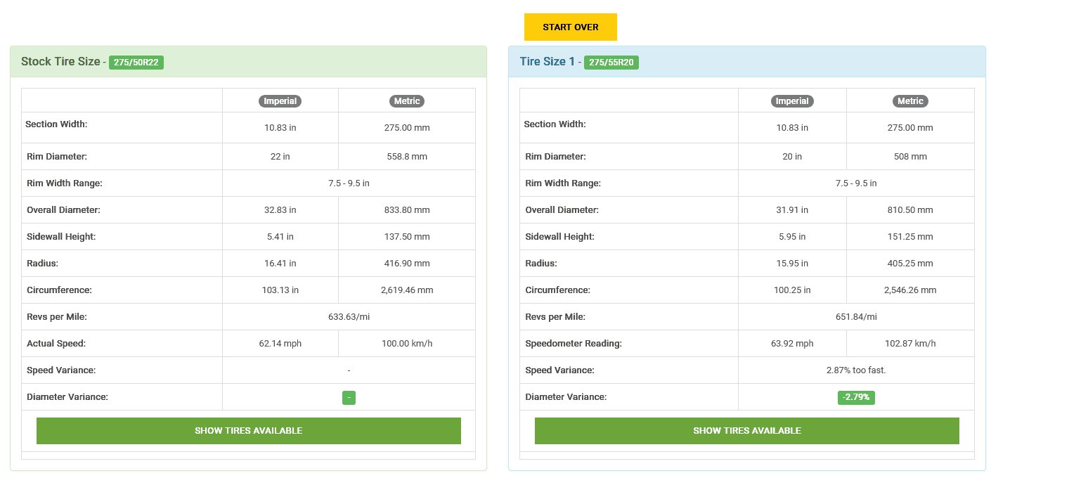

You may want to consider the Continental terrain contact H/T’s also. I put them on 10k miles ago and they are wearing great. As in very little. They are a A/A vs A/B on the Michelin on temp/traction? Sorry going from memory…
You are correct the only issue is the width of 275 vs 285 (Contis arent available in 285) would throw off aspect ratio by about 1% more making it 2.79% vs 1.48% diff in the speed calculation
