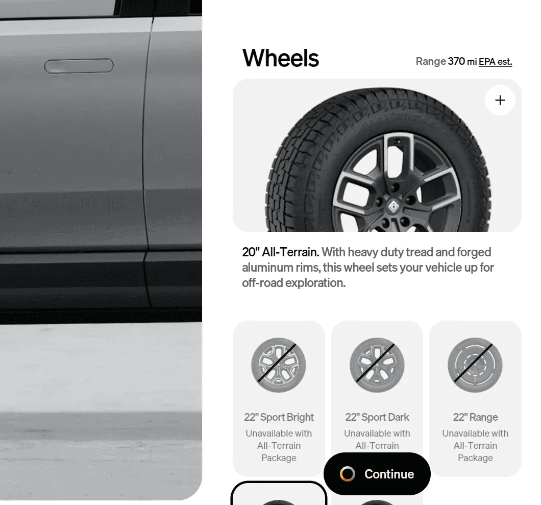

The Gen 1 OEM 20" wheel are forged enkei's, not 100% sure what the Gen 2s are, but they are still described as forged aluminum.
Rivian R1T R1S Creating the Ultimate Wheel/Tire Combo (Help Needed) Screenshot 2024-08-06 204527

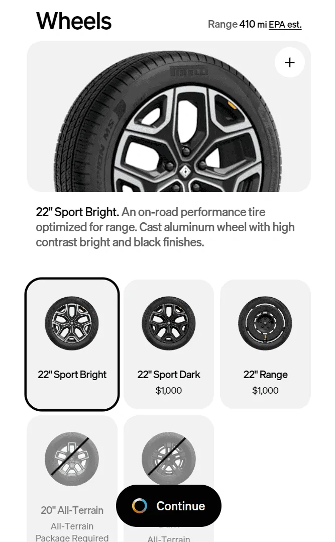

The 22" Sports are described as cast aluminum.
Rivian R1T R1S Creating the Ultimate Wheel/Tire Combo (Help Needed) Screenshot 2024-08-06 204716

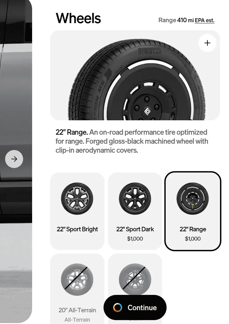

While the 22 range is "machined".
Rivian R1T R1S Creating the Ultimate Wheel/Tire Combo (Help Needed) Screenshot 2024-08-06 204757
