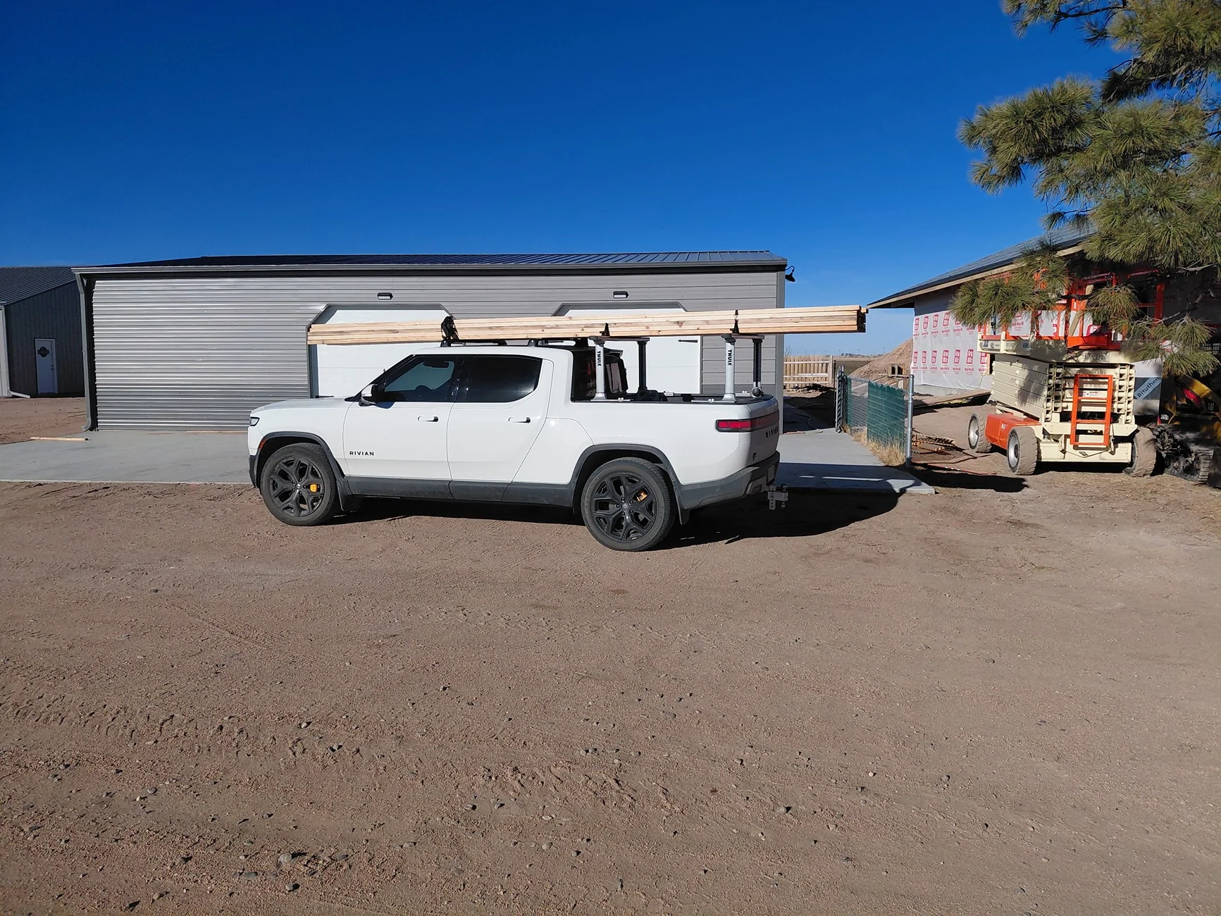

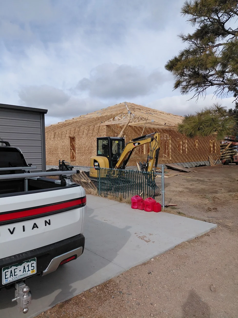

After hazing over the internet for a while I didnt want a permanent up in the air rack.. I decided to customize my Thule rack to work.. it was easy and in all reality all ya need is a grinder with a cutoff wheel to shorten the Thule components which are all adjustable.. then all ya need is to go to your hardware store and find some u bolts to mount to the factory rivian hanger.. also a 1/2 drill bit.. minimal effort.. here some pics of the rivian hard at work..
Rivian R1T R1S Customized Thule racks works on R1T 20260227_083826
Rivian R1T R1S Customized Thule racks works on R1T 20260210_101649

Would like to see more details on how you did this. Final pics are nice. But a how to would be appreciated.
