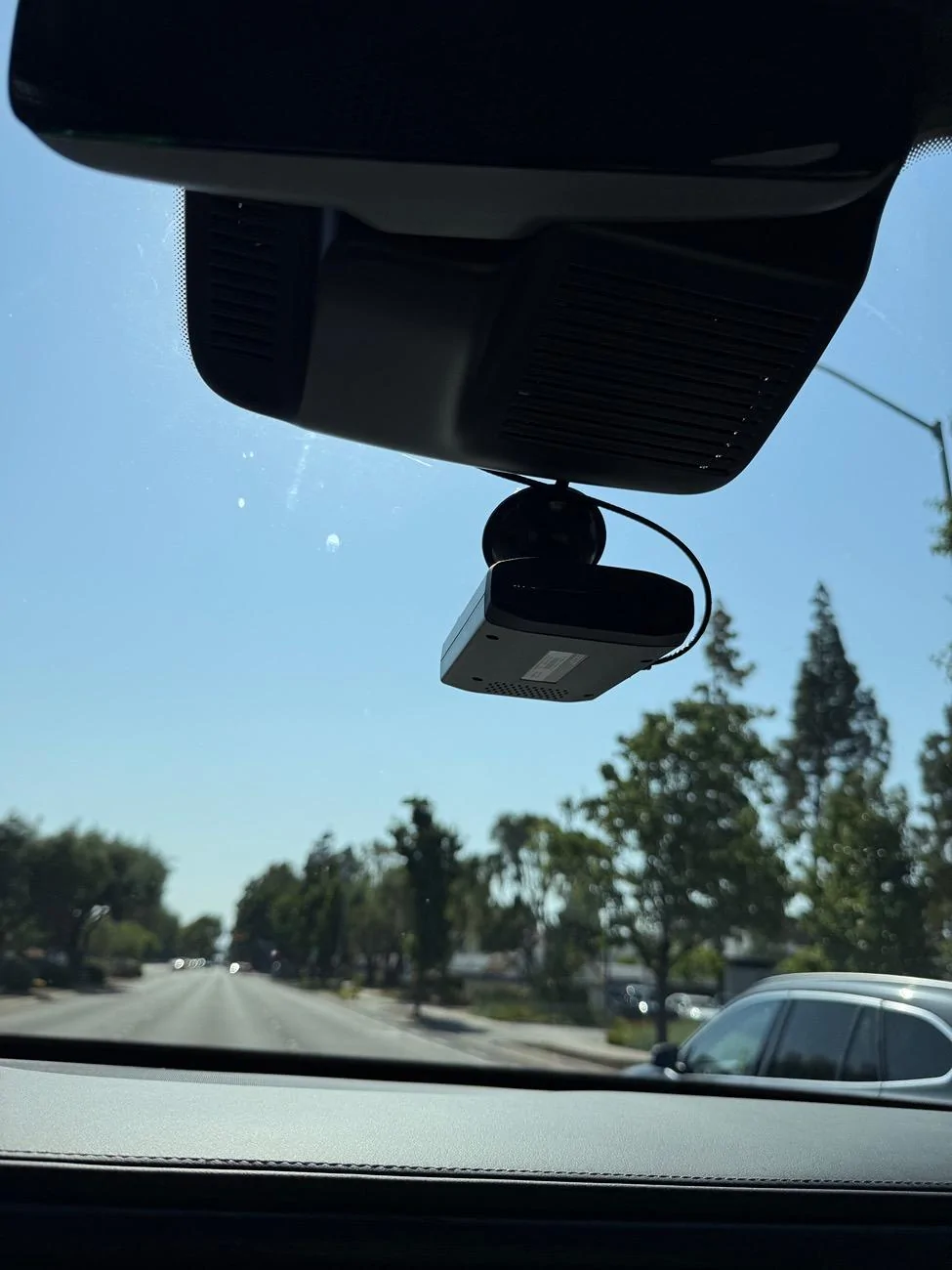

I just installed my radar detector this week. I had a mirror tap harness that I removed from a taycan lemon, but damaged one of the pins and it was intermittent. Replaced it with this kit:
Xislet 16.5" Radar Detector... https://www.amazon.com/dp/B082V1245P?ref=ppx_pop_mob_ap_share
the difference is the pin converters at end of mirror tap vs 3 made in china harnesses, two of which you will not need.
Functionality is the same. Make sure you get a solution with a fuse.
Rivian R1T R1S Dash Cam/Radar Detector Harness - Mirror tap IMG_6838
