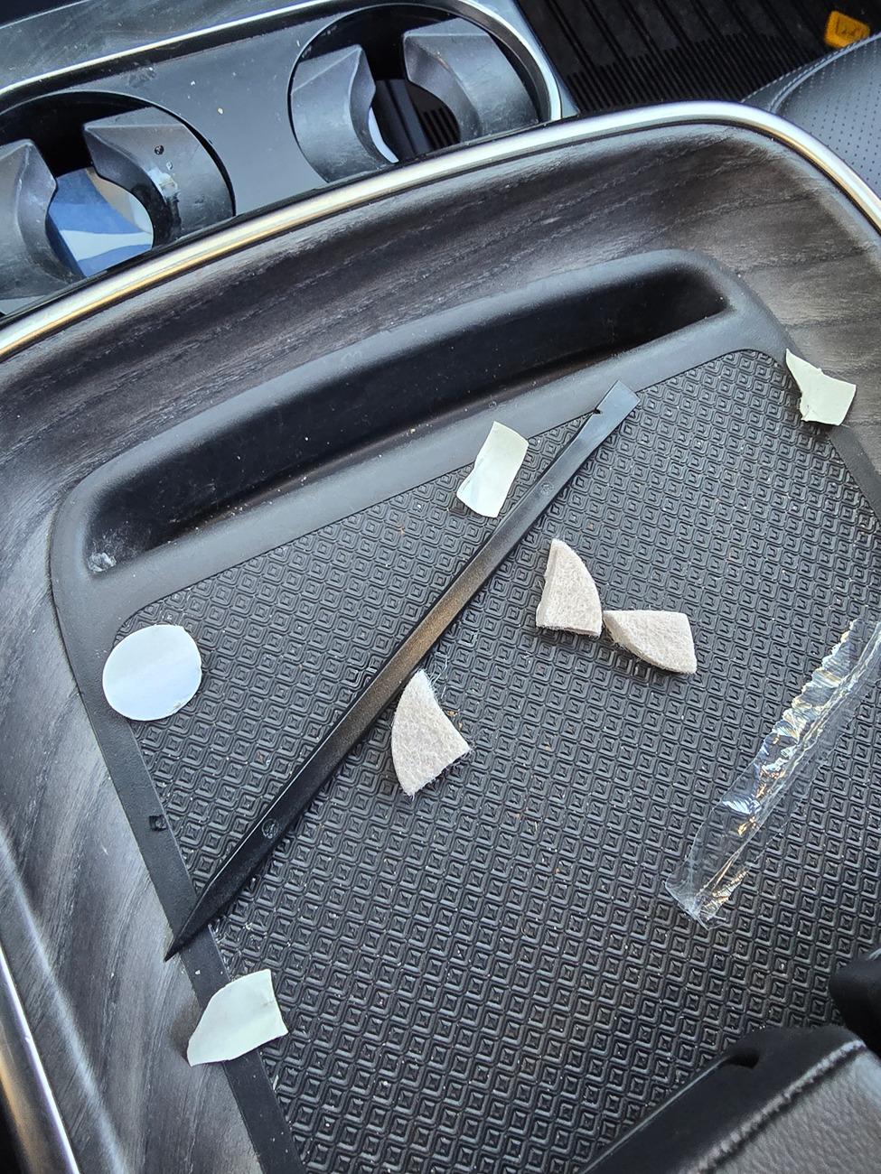

I had this issue and with this part of the mesh grill. I was able to address my rattle with a small DIY project. Happy to share if you’re getting the same rattle.
Quick way to diagnose: If you drive over the same road while you active press down on the middle part of the mesh grill, do you still hear the rattling?

Center grill is just clipped into place. Go slow and a plastic pry bar should do the trick.
You inspired me... Went for it and fixed it by placing some cut up chair felt pads on the top and side edges of the hvac under the speaker grill. One test drive later and 0 noise now!
Rivian R1T R1S Dashboard disassembly? 20241026_140241
