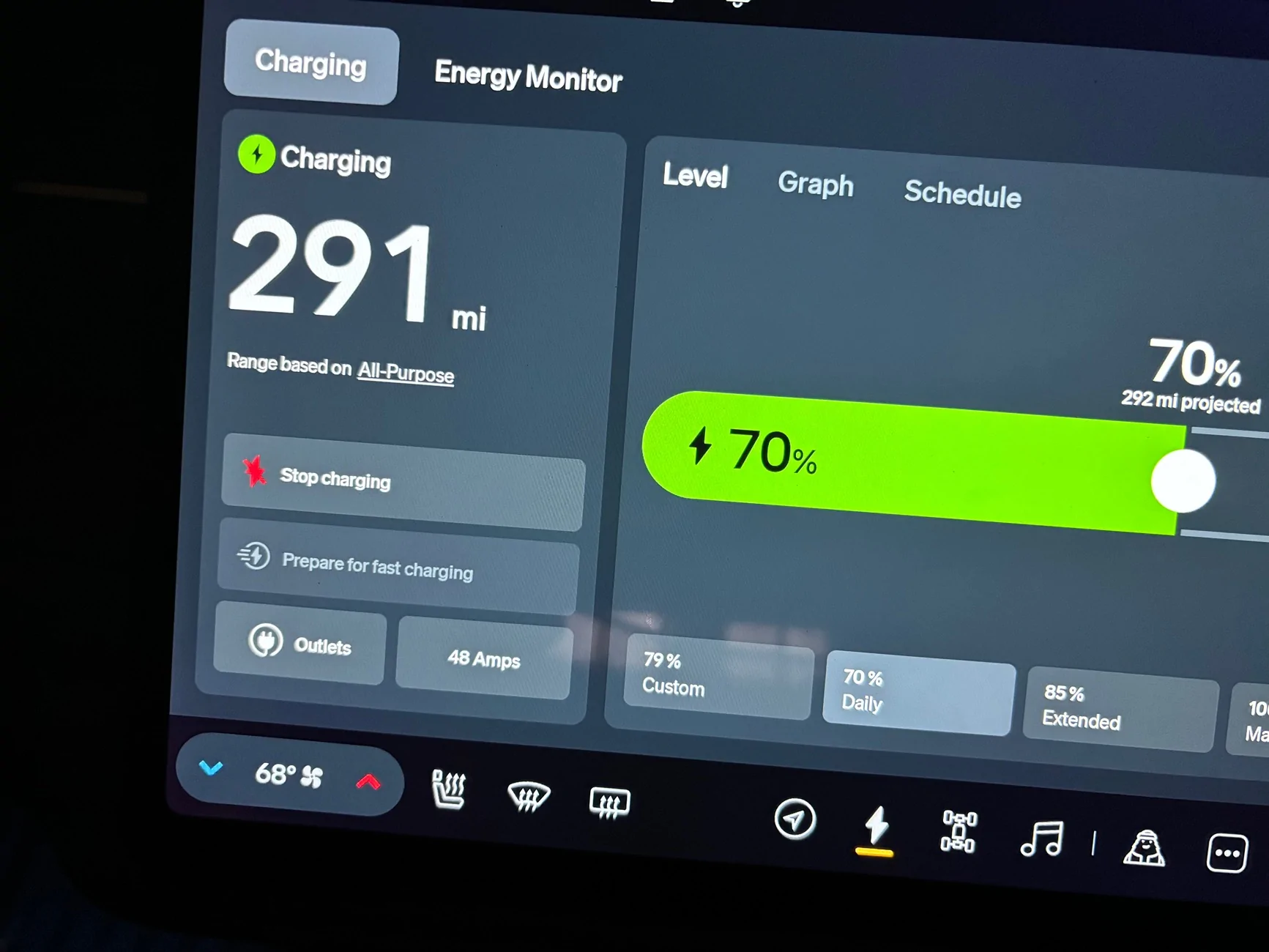

Stopped in here to charge before heading back to Denver yesterday. Chargers are easy to access and things connected very quickly. However, I could barely crack 100 kw/h when charging and this quickly dropped to about 80. I had about 50% charge at the start, and did not pre-condition, but still this seemed pretty lame. I’m used to getting much better charging rates from the RAN units.

There is a button in the charging display to manual force the preconditioning to start. “Prepare for fast charging” If the battery is really cold it could take 39 minutes. Monitor the battery temperature in the Rivian drive modes menu

Appreciate all the tips. Yes, I realized too late that I should have pre-conditioned. I'm in a Gen2 TriMax R1T.
