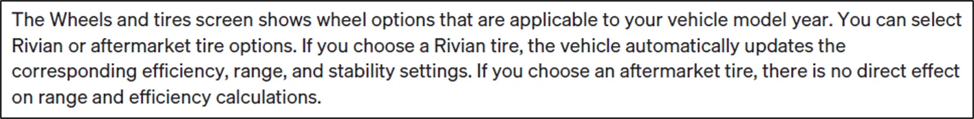

The car allows you to set new tire configurations in the software. Details on Page 360 of the Manual.

R1 do come in configs with different overall diameters. Calibration of instrument readings is done through software—defining what each full revolution represents—and choosing among the available software profiles that best match tires you have chosen to use.
Factory R2 options all have same overall diameter. One full revolution equals same distance travelled. No need to change software or calibration; unless you chose to run a different overall diameter. The wheel size is just the size of the hole in the tire. Overall diameter of the tire is a different parameter and the one that matters most in instrument readings/calculations.
