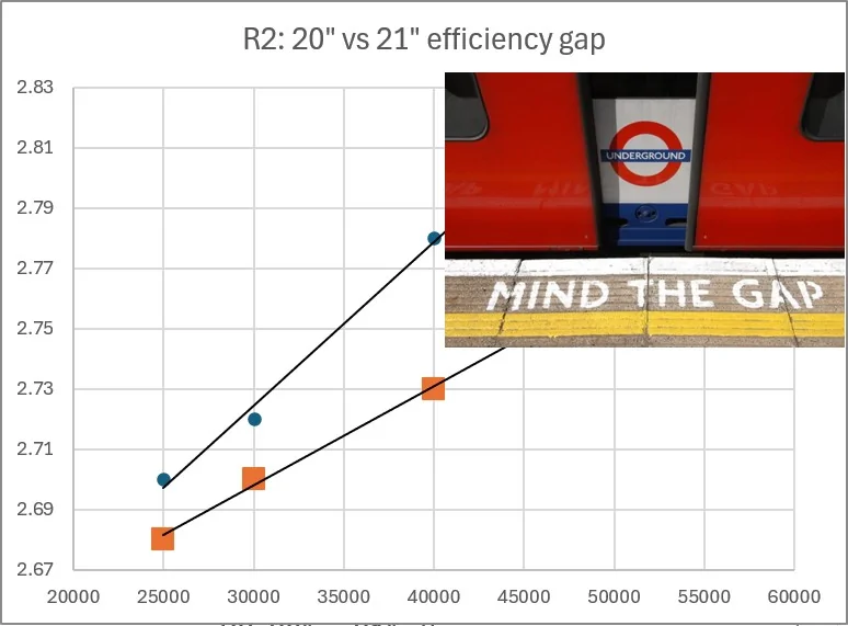

While anecdotal, it appears that the R2 with 20" wheels may in fact be slightly more efficient that the 21" setup. Some say that it's just the 21" crowd is driving faster, which might be true, interesting none-the-less:
As reported here: Rivian Tires: Compare & Review for R1T, R1S & R2
TireMilesVehiclesMpVMPKRange
20"9184127652.74241
21"5579115072.53223
Any current owners willing to report in with tire size, total mileage, average speed, and efficiency?
