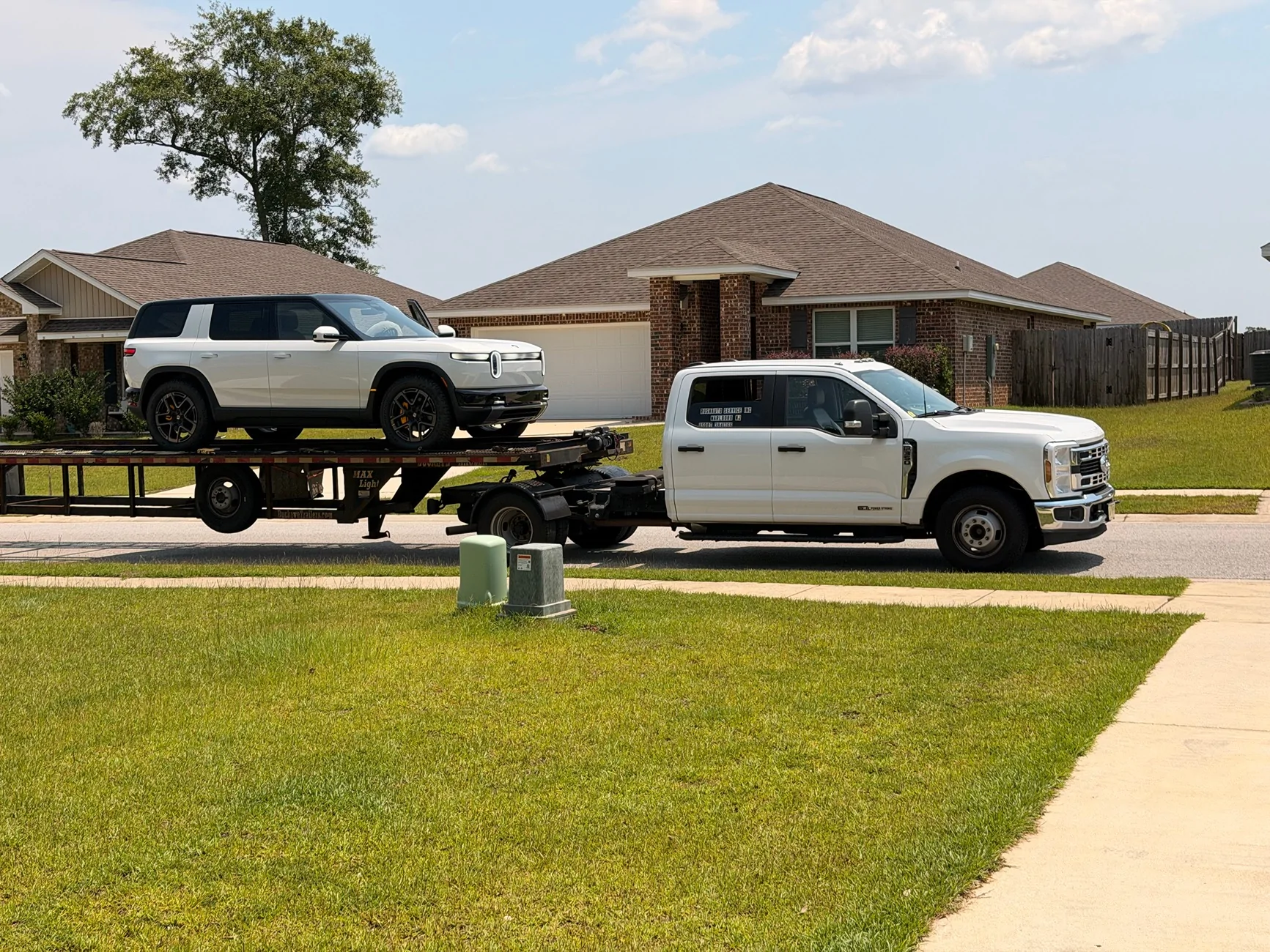

Update: Rivian is having my car flat-bedded to the Atlanta Service Center tomorrow.
It appears that an ECU/Zonal module is faulty as its not just the subwoofer and blind spot view as I thought, its all things under the "Autonomy -> Obstacle Avoidance" sub-menu, which includes blind spot view.
They also plan to replace the defective subwoofer.

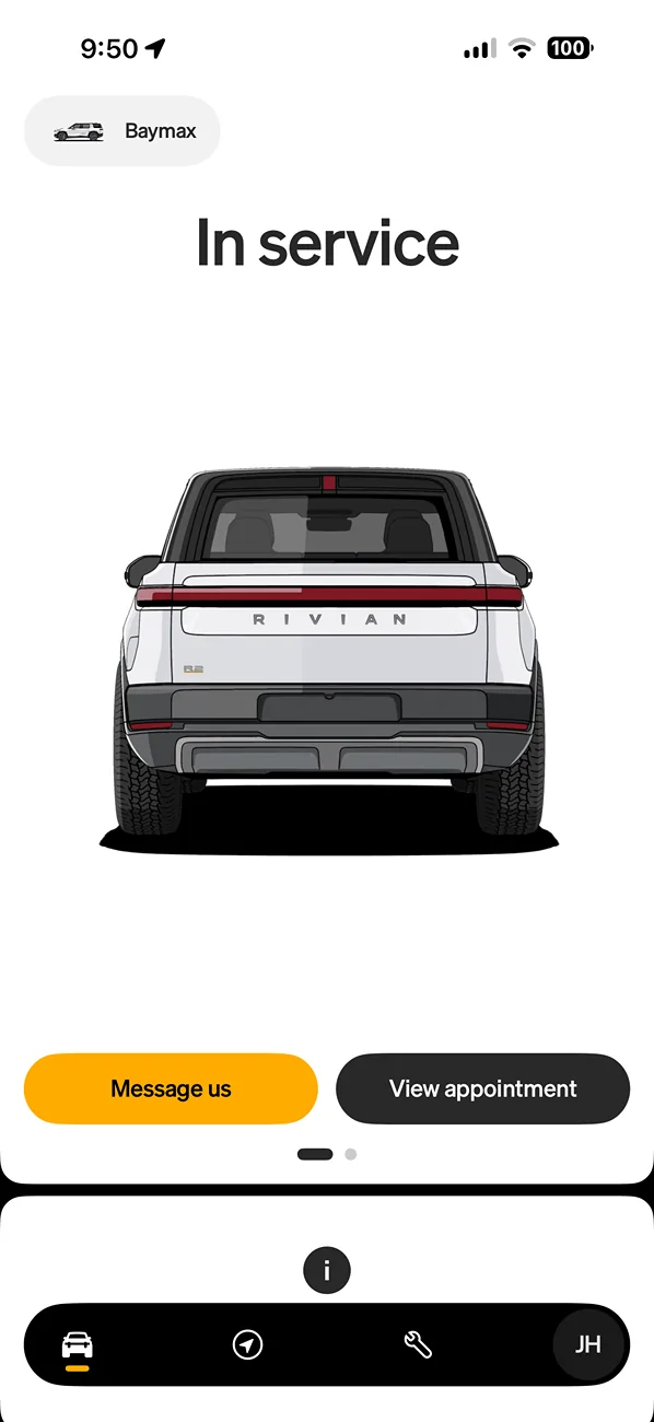

Rivian messaged me yesterday promising to call me today with what their diagnostics found how long to fix.
They just called and basically said a lot of words to basically say that they still have no idea what’s causing the problem or what parts are needed. 🫠
Before they told you something about an ECU/zonal module failure. Are they walking that back now?

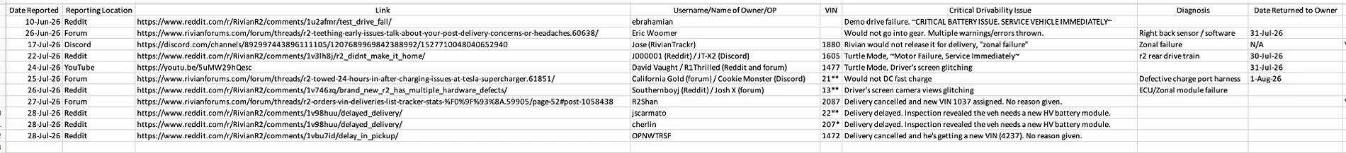

Seems like a handful of serious R2 issues are being amplified because they're being posted and cross-posted on various websites. So this morning I tried to compile them into a single spreadsheet and only found seven that I'd consider critical problems that affect driveability.
Lemme know if I missed any and I'll add them.
David Vaught's R2 was fixed as well with some sort of software issue. I assume there will be video uploaded about it at some point.
Eric Woomer's old report from 5 weeks ago was fixed in a week and he said on FB "Just got a call from the service center and they said it's a software issue AND the right brake sensor. Seems like the airbag and parking brake alerts were part of the software, the not being able to drive is the sensor. Handed me an R1S loaner and sent me on my way!"
So this only leaves JoshX/southernboyj on this forum as the only other publicly known customer car on that list that hasn't been fixed or diagnosed. So hopefully that means things are getting back on track.
So this only leaves JoshX/southernboyj on this forum as the only other publicly known customer car on that list that hasn't been fixed. So hopefully that means things are getting back on track.
Thanks for the update on Eric. I'm not on Twitter so I wasn't aware. I did have David's updated, but like you I'm waiting for details on the fix (he said it was software-only, which is interesting).
This is what I currently have as of 1 Aug.
