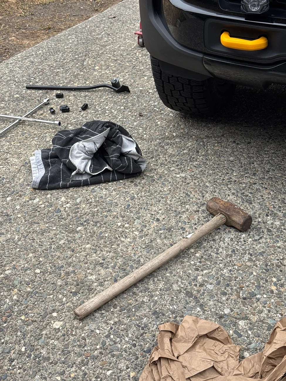

Why yes, I do in fact do my own rotations…
Stupid seized rim…
On a real note OP, you may like the extra tall jack puck. JackPuckXL - I appreciate the hell out of mine.
Seized to the hub? Loosen the lugs one turn and drive it the length of the driveway.
Ever tried that in tire change mode … when it lowers your truck as you put it back in drive while the suspension settles and presses the tires outward? It’s not great for that traditional approach.
