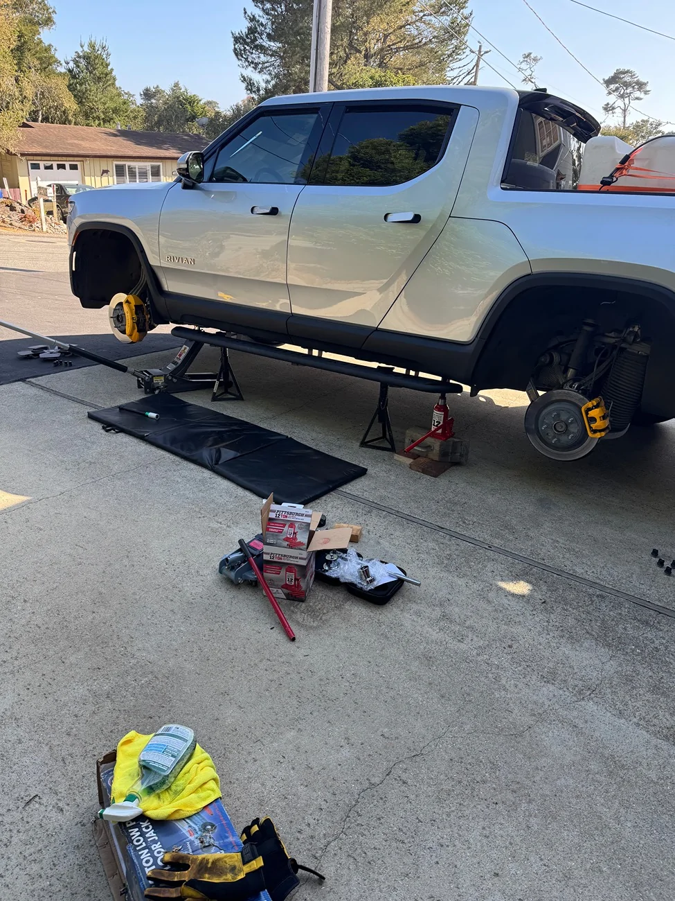

I have done my own tire rotations on the R1T. No need to buy a torque battery or plug in wrench. Long breaker bar is fine. Accurate torque hand wrench for tightening lug nuts to proper spec definitely needed in x pattern.
Two hydraulic jacks needed. Safety jack stands as well.
45-60 min job for sure. Wheel/tire very heavy so I bought a car moving dolly with a jack to remove the wheel easier.
i have Harbor Freight jacks. Never had an issue. Heavy duty 3 ton; 2 rolling hydraulic jacks.
