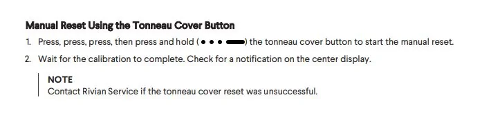

He showed me how to do it:
- Open the tonneau fully
- Press and hold the open/close button and keep it depressed until 5 seconds after the cover has completely closed.
Thanks for this info. Ever since mine came back from service a few weeks ago its been having the same problem of leaving a 1" gap between cover and tailgate. When closing I would just hold the button down until it closed all the way, but then next time the issue was back probably because I didn't hold for 5 seconds after close. I'll try your trick next time.

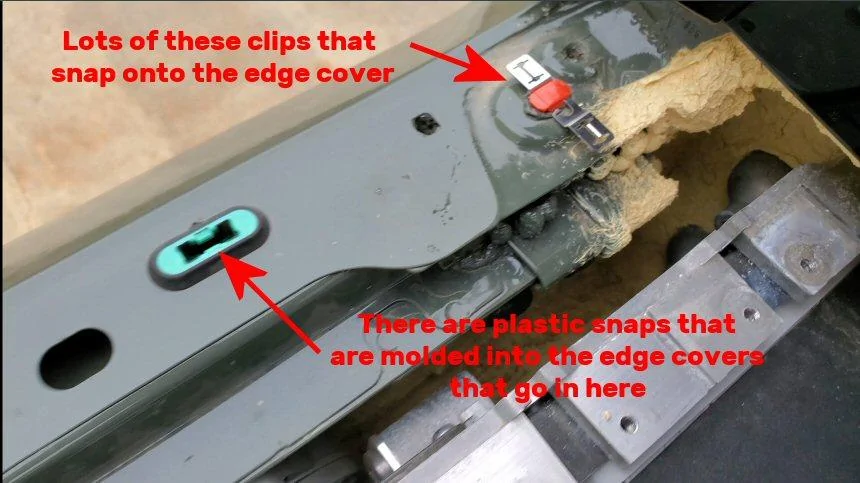

@Lil'O Annie Was there anything special about getting the bed rail plastics off? Or did they just pop off by pulling up on them?
It's not too difficult. Start at the corner near the rear window. Take your time and lift gently. There are a number of odd metal clips with red plastic buttons that can break, so be careful. The ones molded into the plastic edge covers are pretty good.
When you put the edge covers back on, be sure to slip the rear end back into the light blue button before snapping it back down--that's easy to miss and must be done first. If you take them off, you'll see what I mean.
Rivian R1T R1S DIY Tonneau Repairs? Anyone try to do this yet? EdgeCoverConnectors

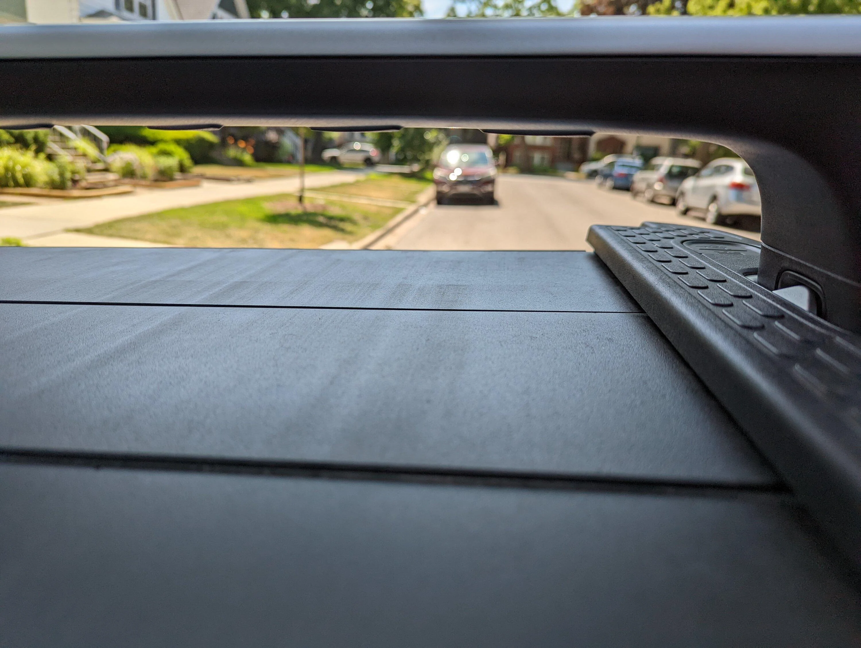

Rivian R1T R1S DIY Tonneau Repairs? Anyone try to do this yet? PXL_20220702_201440001
This state of the last two (in my case) panels binding, I believe, prevents them from properly splitting when entering the stack and contributes to the issues. I could see how this might even cause the two sides getting out of sync and gears jumping teeth.
When the panels are flush, and since it's the last two to enter the stack for me, it's quite easy for me to press up from the underneath the cover and get it back to the appropriate lip and separation.
I don't know if there are damaged teeth on the panels but giving it gentle to forceful encouragement to go into the stack seems helps mine now. I just push on the panel as the motor is pulling them in.

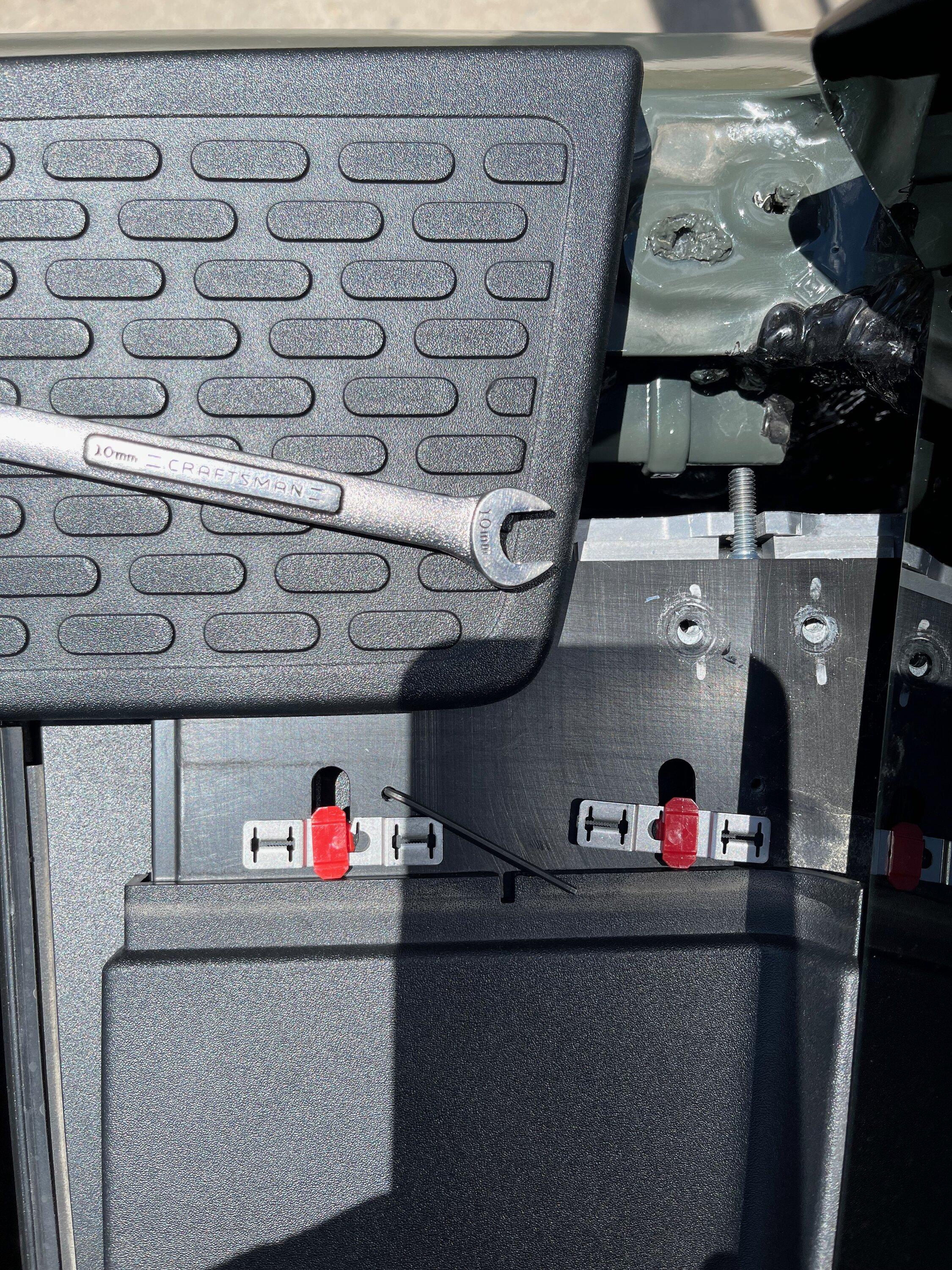

I just got finished wrestling with my cover also and here's a few more tips. The two holes on the driver's side are in the attached pictures. You may need to spin the rod for them to be accessible. I had the first panel very jammed sideways, is why I had to disassemble it in the first place. After unscrewing the 4 torx bolts and the 4 10mm nuts, i ran the tonneau cover reset option on the display. This sucked the the panel in, at which point I pushed the remaining panels towards the cab and they proceed to get stacked/stored in the open state. I then pushed the button to closed the cover which it did properly but somewhat at an angle. We were able to get it back into alignment by having my son pull the cover back as we open and closed it a few more times. I'm leaving it as is for now until they come up with a new design. Its just crazy that after all the engineering that went into this truck the tonneau cover is such a POS!

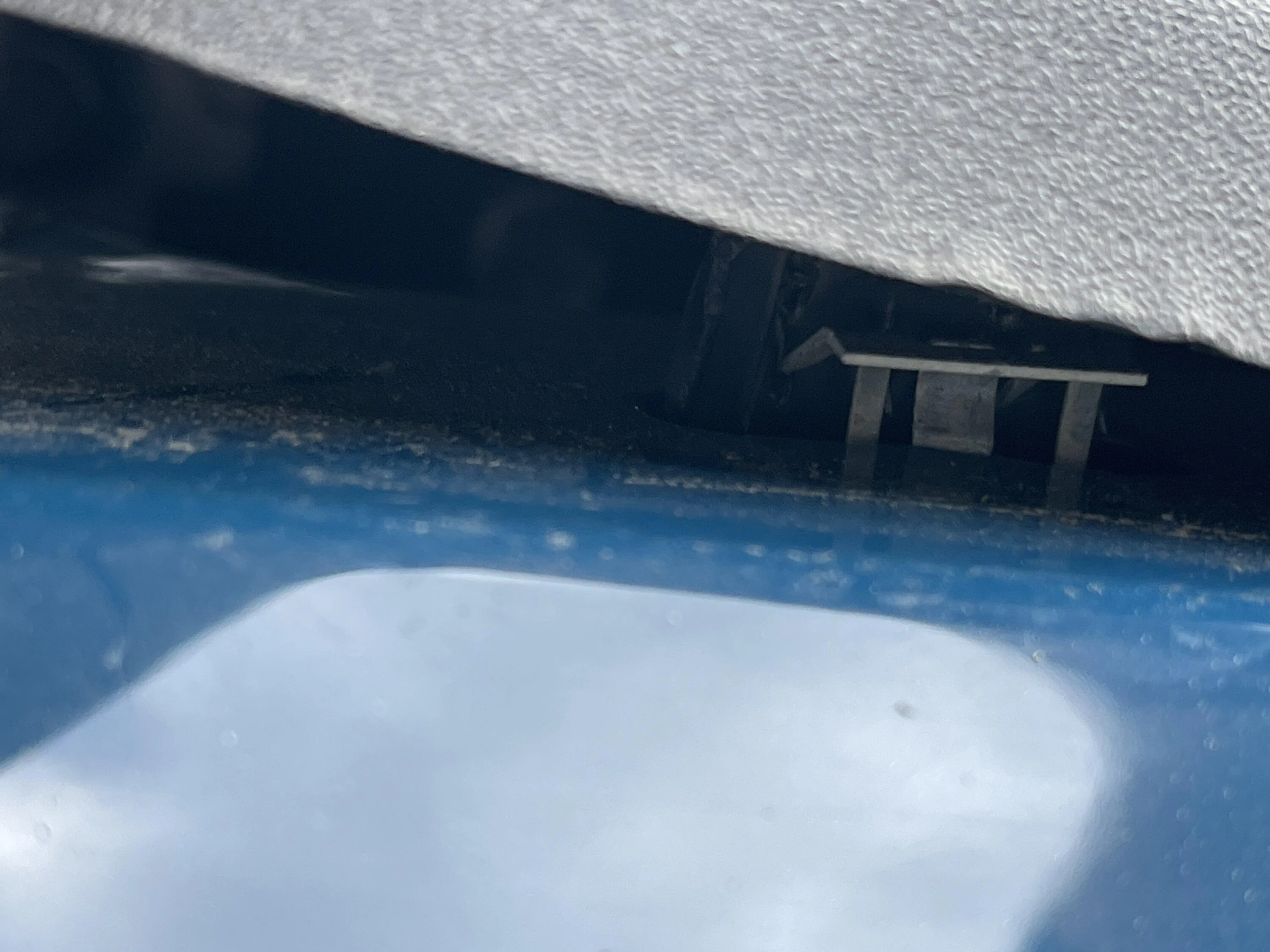

I started trying to pull up the bed’s side pieces but these clips do not want to give. They look different from the ones the OP has.
Any advice on getting them to release?
Thx
Thx
Those don't look like anything we had under our sides. They must have changed the clips after July or so. Where was this photo taken of the side piece...front/back?
Thx
Those are just standard automotive trim clips. They are seated with pressure but having a trim removal tool makes quick work of them.
I’ve got an assortment of trim removal tools, but these things don’t want to let go.

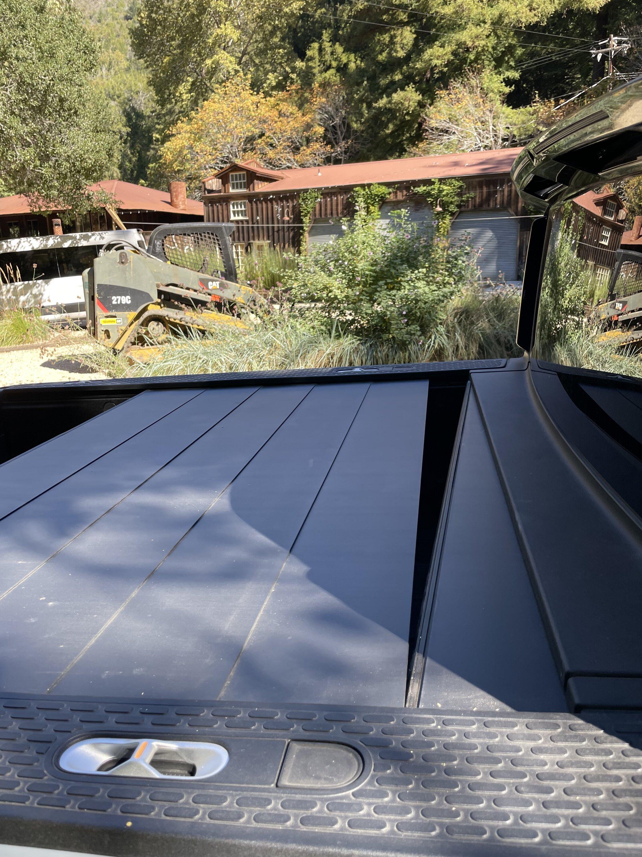

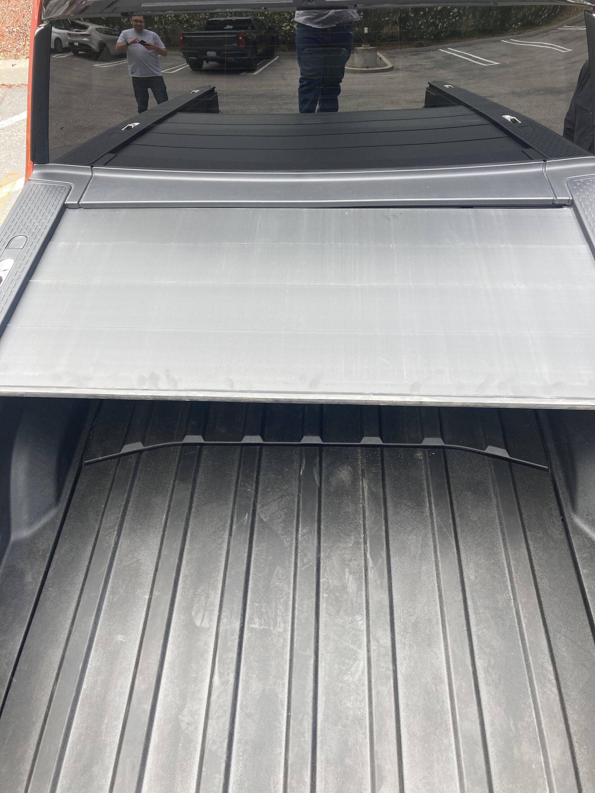

I just got the death twist on the cover. Currently it's so far askew with 5 panels out. It looks like I am going to have to extract the whole thing. I'll try and document the panel removal.
Theses red clips seem like a real pleasure to work with.
Rivian R1T R1S DIY Tonneau Repairs? Anyone try to do this yet? IMG_2583
to work with.
to work with.
This is what just happened to mine after the SC replaced my entire unit. It's still broken. Mobile service was here to check out something for me, but I mentioned the cover and how I just want to use the bed. Rivian was going to have me drive an hour to the SC to get everything back in, instead, the mobile tech just grabbed the outer-most slat and yanked hard at an angle and was able to pull it out. He then did all the rest of them, too. So while I have a crooked one partially sticking out from where the cabin in, at least my bed is open and usable again.
Man I cannot wait for the redesign. Something tells me it's further away than just the beginning of 2023, too. But who knows, maybe we'll be surprised.
