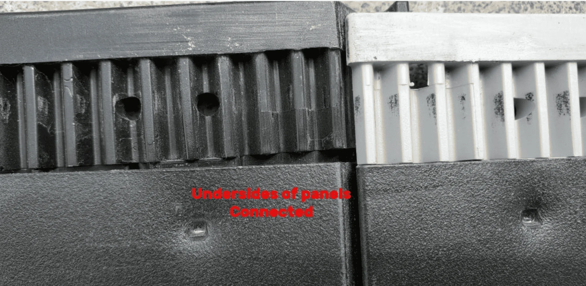

After seeing the additional photos showing the rack on the bottom of the panels, this is unfortunately a pretty big fail on Rivian's part. I can't understand why the designers thought this would hold up to normal stresses caused by the owner (i.e. pinching because something is in the way) and the environmental extremes a vehicle is exposed to.
I agree that a guide/skid made of UHMW or similar would help with tolerance and friction issues. But that rack surface looks like the plastic coating will wear quickly, introduce new slop, and then also have unlubricated aluminum gear on aluminum rack wear. As I said in another post, an elegant design but not robust.
Edit: Taking a closer look at the photos, what the heck is up with this? Looks like the rack is an end sub-assembly, pressed in the end of the slat, and secured with only a punch? This one is clearly already pulling out..... Jeez....
a self tapping screw would be better than that, but then there’s the risk of it falling out…
Maybe the rack pulling out and it and the rest of the slat trying to go in different directions is part of the jamming?
presuming this is a supplier developed part, someone’s going to eat a lot of redesign work.
Dry lube is the only solution. To anyone having problems, at the risk of stating the obvious - don't even think about using a petroleum (WD40, PBBlaster, etc.) or silicon semi-liquid (Fuchs Silkolene motorcycle chain lube) lubricant. It will become a gummy, sticky, dirt attracting mess.
From what I’ve read here and elsewhere, Rivian is using dry graphite spray. Which reminds me I’ve got a storm door that’s starting to get squeaky ?
Yeah, a self tapping screw, a properly sized blind rivet, or a machine screw with thread lock would solve this, depending on whether the rack subassembly is hollow or solid at that location, and where they want to be quality vs. cost. Two fasteners would be better, one each end of the rack.
Even a roll pin would do it…
Good eye.
