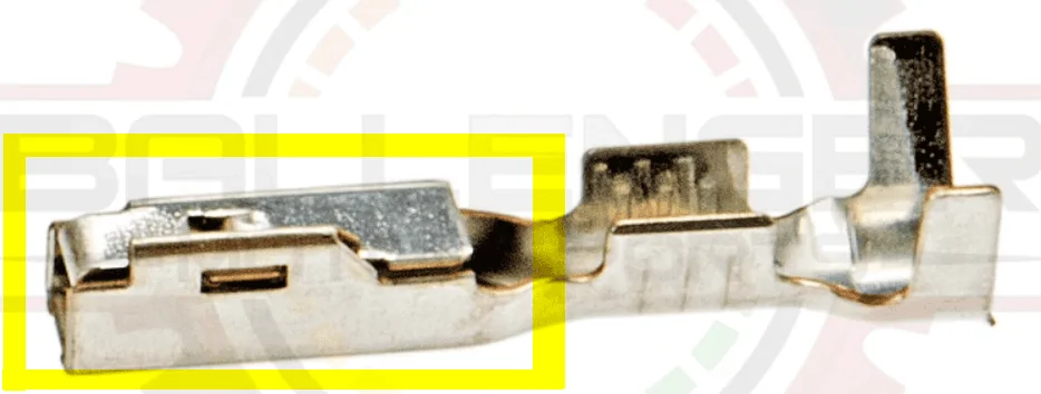

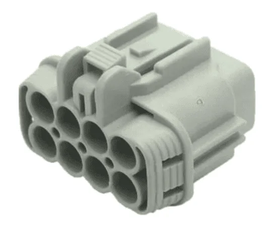

With the right parts (2 mating female pins for the Sumitomo frunk OEM connector, 2 silicone wire seals and a 12V marine-grade outlet), you can add a 12V connector in the frunk and hook it into the pre-wired OEM connector. They still run 12V to the mating connector on the driver-side socket, but only the LED light on that side is wired to the connector. Just order some rubber seals (Sumitomo 7165-0471), the female terminals for the RS 090 (Sumitomo 8240-0265) and a decent 12V marine-grade socket. I used this one because the base is injection molded and wouldn't need to be waterproofed, and I didn't have to worry about connection lugs coming off the socket over time. It takes some work to try and get the socket nut installed, especially if you choose to install the 12V socket in the same area where Rivian originally installed the socket. At least the power is nearby and it's still fused and easy to hook into. It took me about 4 hours to add the 12V socket to my R1S frunk, but it looks nearly OEM at this point. You'll need to manually crimp these Sumitomo terminal on, unless you just happen to have a crimper that will work, and if you do - you may want to consider adding a small amount of solder to ensure a solid connection - just make damn sure you don't get ANY solder into the pinway or the external face of the wire sled, or the pin won't lock into the shell, and it might just push out when you try to connect it. Sumitomo pins are notoriously picky eaters when it comes to pristine crimps and properly sized water seals. I absolutely hate these connectors, personally.
Here's some linked pictures of the Sumitomo hardware you'd need if you want to use the existing OEM hardware:

Unpopulated Plug Shell (Frunk-Side) Optional!
Rivian R1T R1S Do you have a 12 v outlet in dash area? 1689644926770
Rivian R1T R1S Do you have a 12 v outlet in dash area? 1689644934001
Female terminals for the connector - make sure you get ones for your AWG! Note the area squared in yellow - do not get ANY solder in this area or the pin may not engage into the shell!
Rivian R1T R1S Do you have a 12 v outlet in dash area? 1689645493381

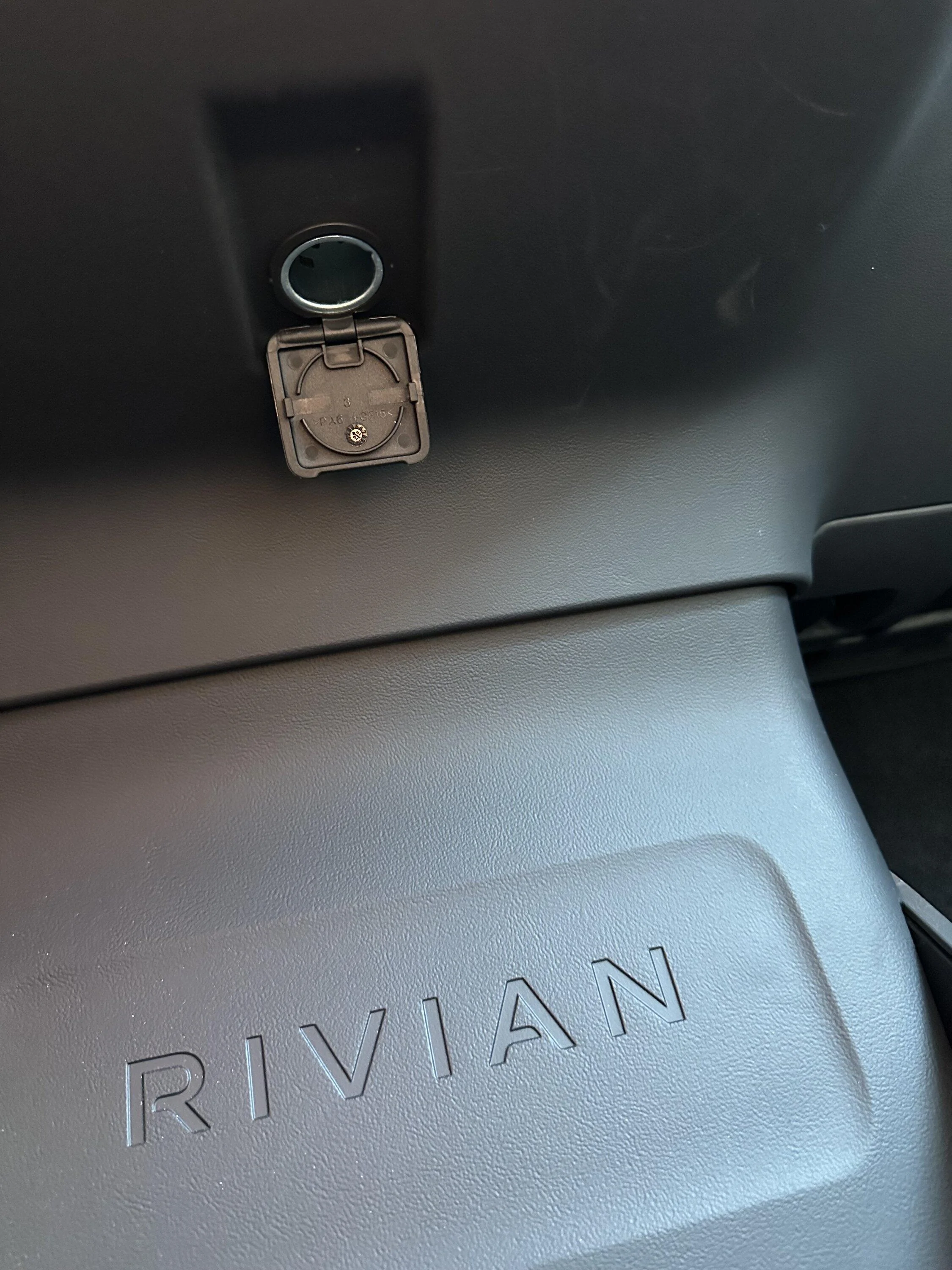

I have it. 12v on the lower dash (can't see it), standard 3 prong plug in rear seating area below the climate control (likewise unseen if you don't look)
LE, built 11/21, VIN 0000xx. I have the 12v in the frunk, under the dash, and gear tunnel. Didn't know about the 110v outlet below the climate control. Went out and took a look after reading this and there it was! In total, I have 3x 12v and 4x 110v outlets.
