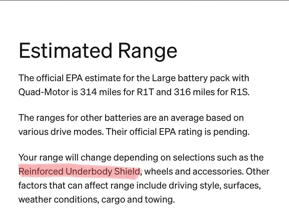

The Rivian configuration website notes a possible mileage effect with the shield. That seems hard to imagine, but….
Does anybody know what the shield is made of and how much it actually weighs on the R1T? 200 lbs. seems like an awfully lot, but I guess it could be.
