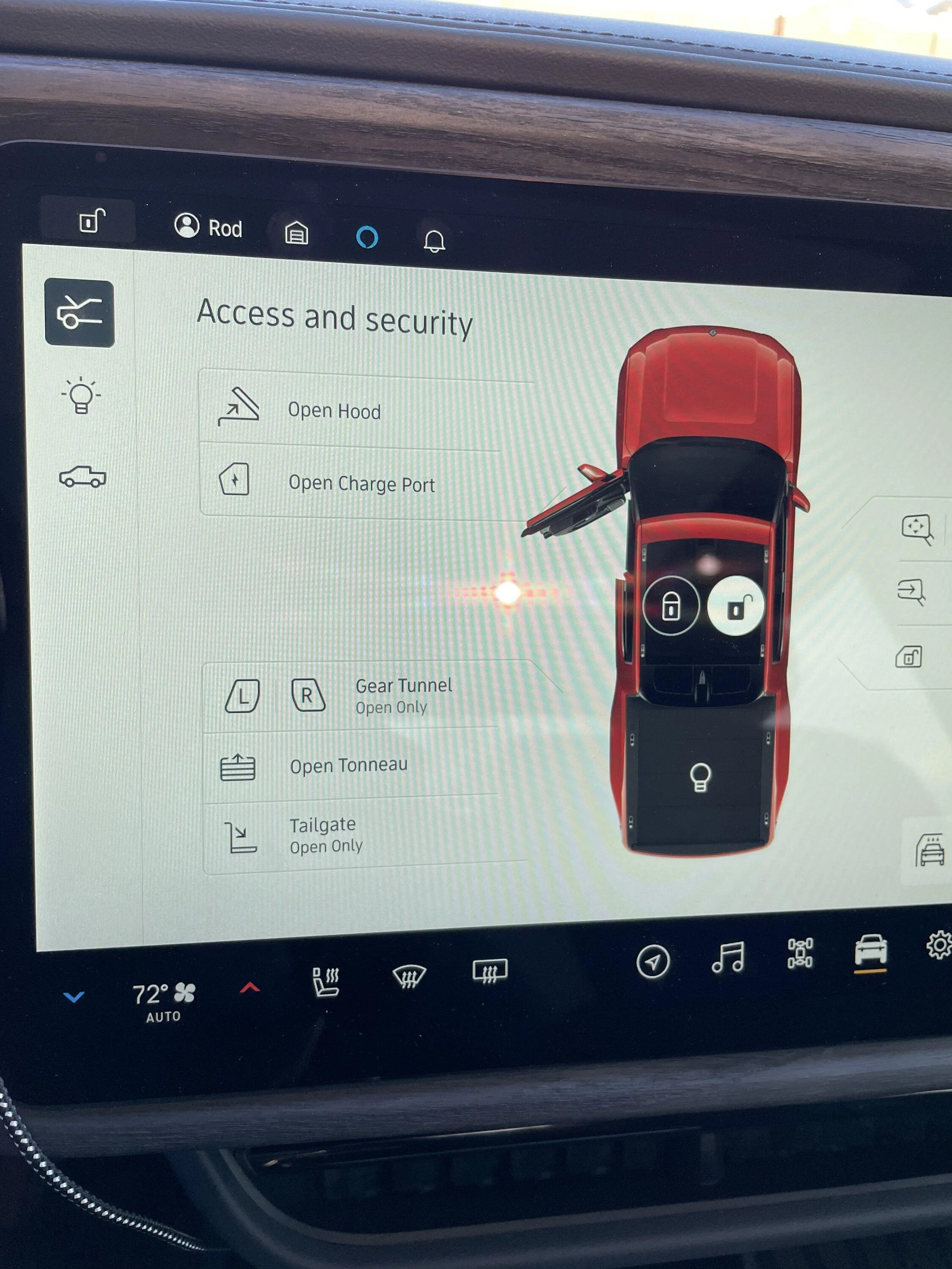

I know mine works because I needed to use it last night. I needed it because the stupid bed lights won't come on again after the tailgate has been down for an extended period of time without closing and re-opening it. Which is not very well thought out since they made the tailgate so long so that a load, in my case a motorcycle, could be carried with the gate down. I had no way to close then reopen the tailgate when the bike was in the bed and it was dark so I had no light.
There needs to be a way to activate the bed lights from the screen. Or maybe there is and I'm blind.
There is. On the access & security screen (the open hood icon) tap the light bulb on the truck bed overhead pic.
AH! THANK YOU!!!!!! I never noticed that darn bulb in the bed!
