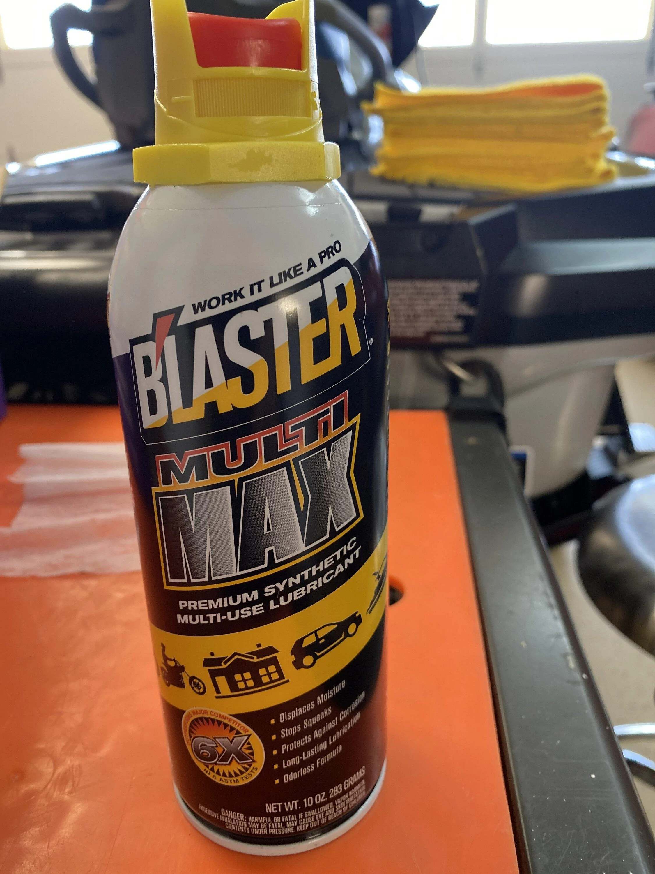

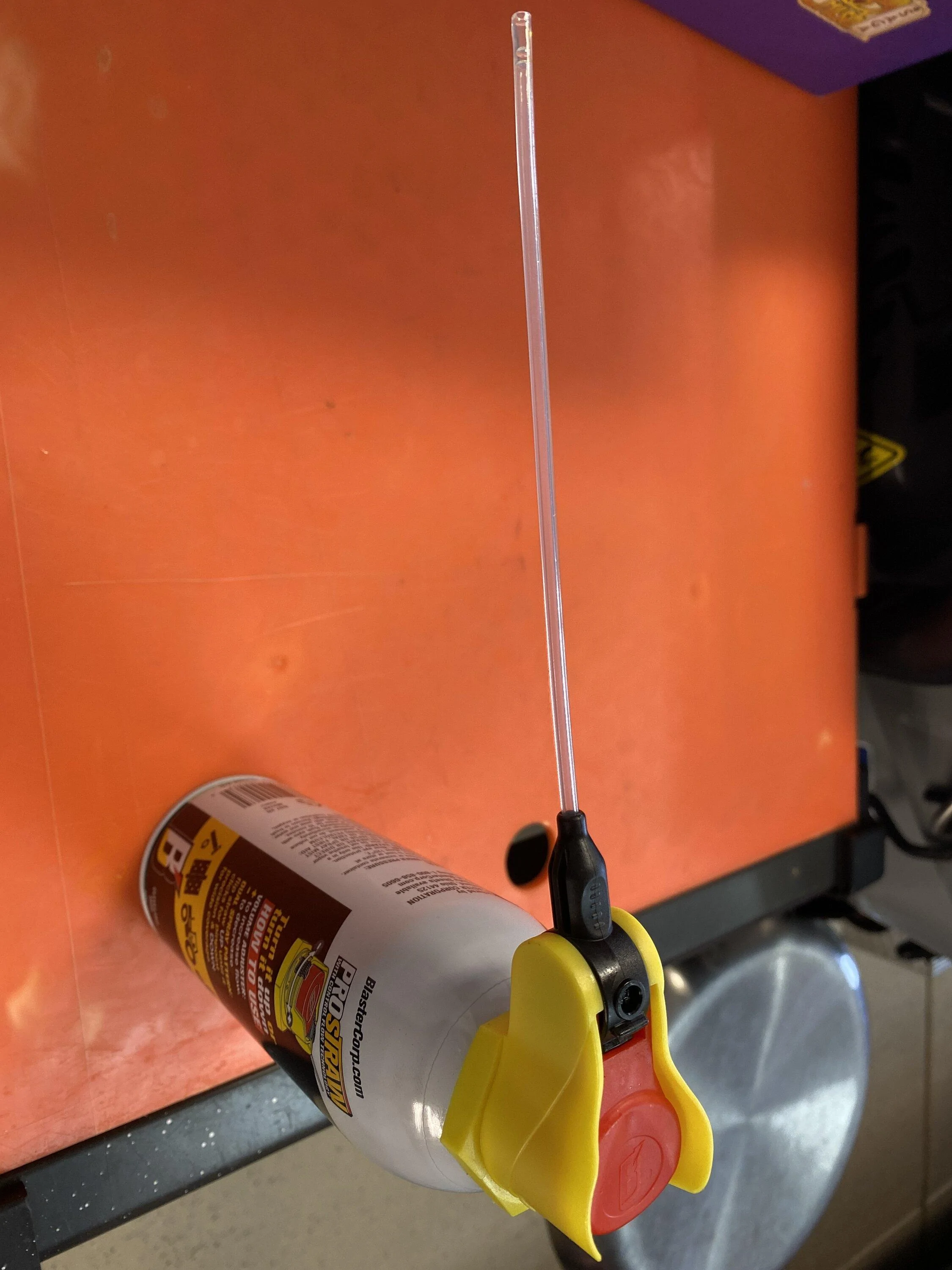

Any particular brand you recommend for the lubricant?
Virgil T2
Nov 21, 2020
56
110
SoCal (Highland)
R1T LE, CR, 22s, 2017 Model X, R1S preorder
I use these that I get from Lowe’s, it has a tube attachment that gives great control with a slight press of the nozzle, so it doesn’t spray everywhere

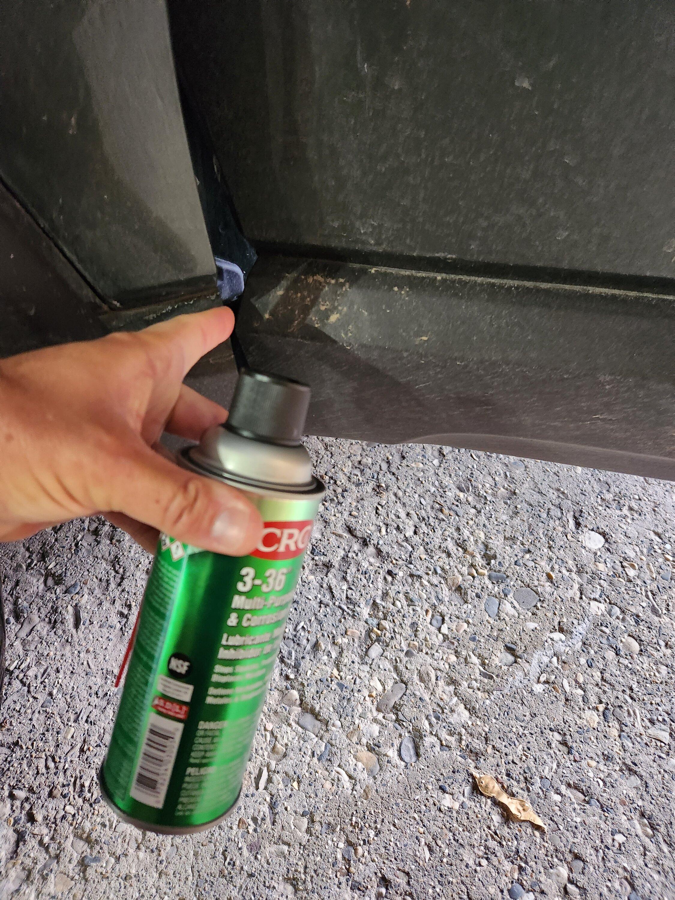

jakef801
Jake
Dec 18, 2020
539
535
SLC, Utah
'16 Tundra/'18 Audi S6/'19 Rubicon/'22 R1T
Rivian R1T R1S Door Handle Creaking when squeezing it to close or open the door 20230114_085529
CRC 3-36. It's at Depot in the electrical section.
