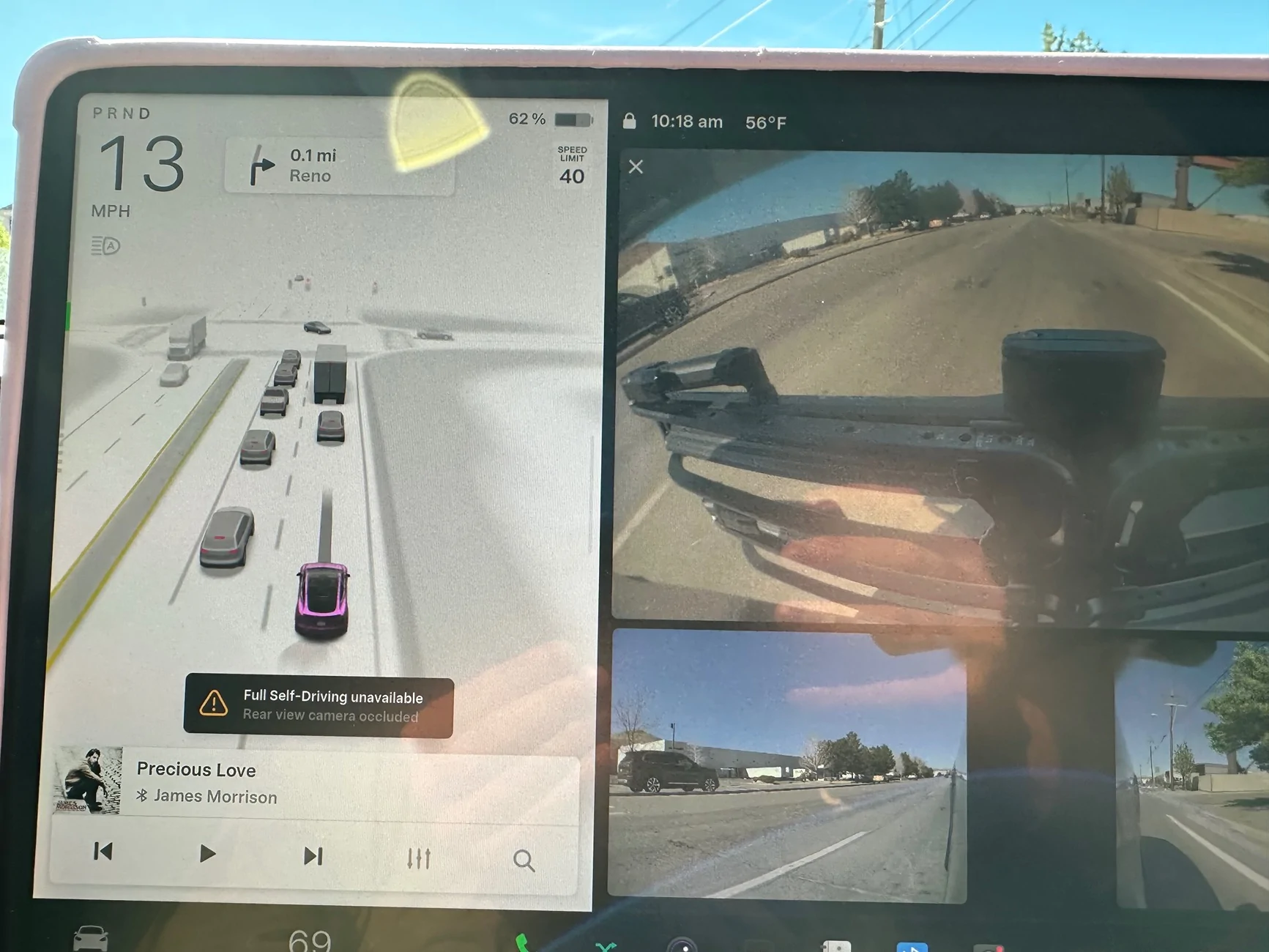

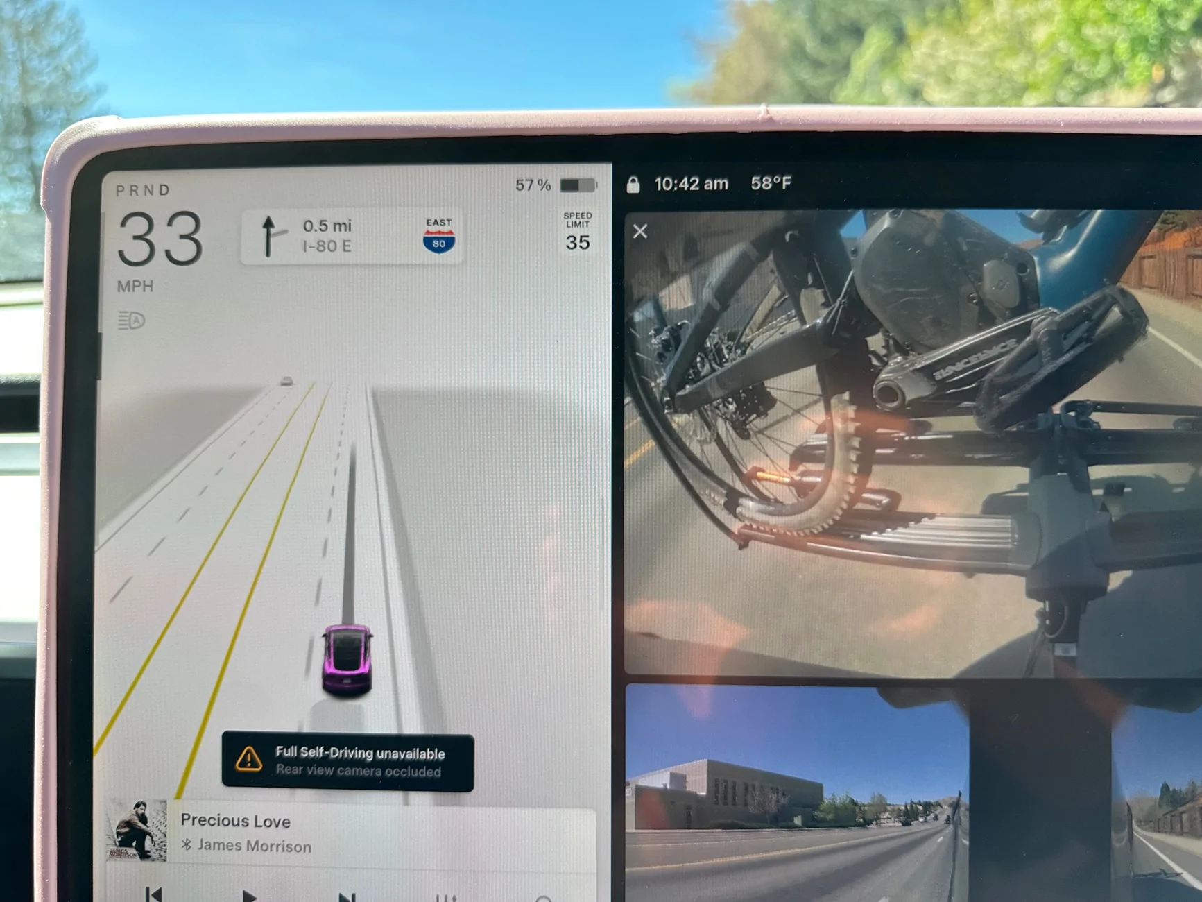

I tried Tesla FSD with a bike rack. Full with bikes, it wouldn't turn on at all. Empty and folded, it turned on and worked for about a mile until someone passed us on the left and then it gave the "red hands takeover".
This could be an area where Rivian's ADAS system could be superior to FSD, and I hope they fully flush this out and advertise it (if it's truly supported and working).

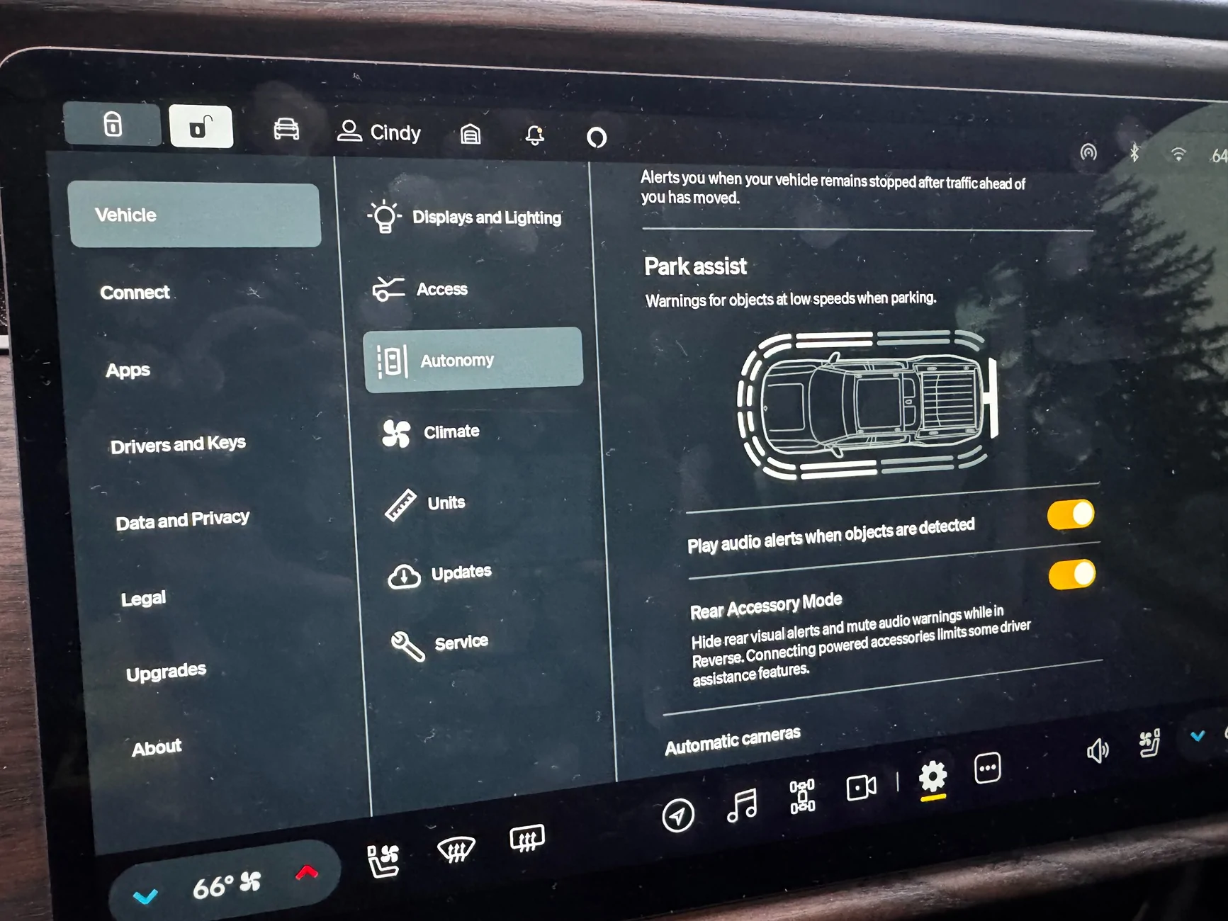

I have a Thule T2 Pro XT that I carry my road bike on. Today I used A+ on the road/hwy and no issues. I did turn off the rear sensor since it was super annoying when reversing. 2026 R1T. A+ seemed to work perfectly as usual.

Thanks! That's super helpful. When you say you turned off the rear sensors, did you do that by using accessory mode, or some other way?
And was this the free version of A+ on the Gen2 or the paid version?

Thanks for that pic! That super promising that Autonomy+ is working for you.

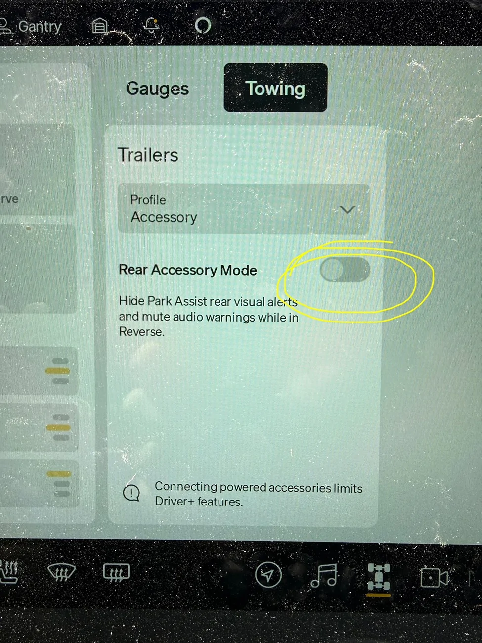

Hmm "Connecting powered accessories limits some driver assistance features"
So I can put my Kuat Piston Pro X on the back and use it, just as you are using it..... as long as I dont plug in the lights? I wonder if that's some weird regulation or something.

I’m a Piston Pro X user with a Gen 2 R1S. You’re totally fine plugging in the lights. You will choose “Accessory” profile on the Towing screen and then toggle on Accessory mode.

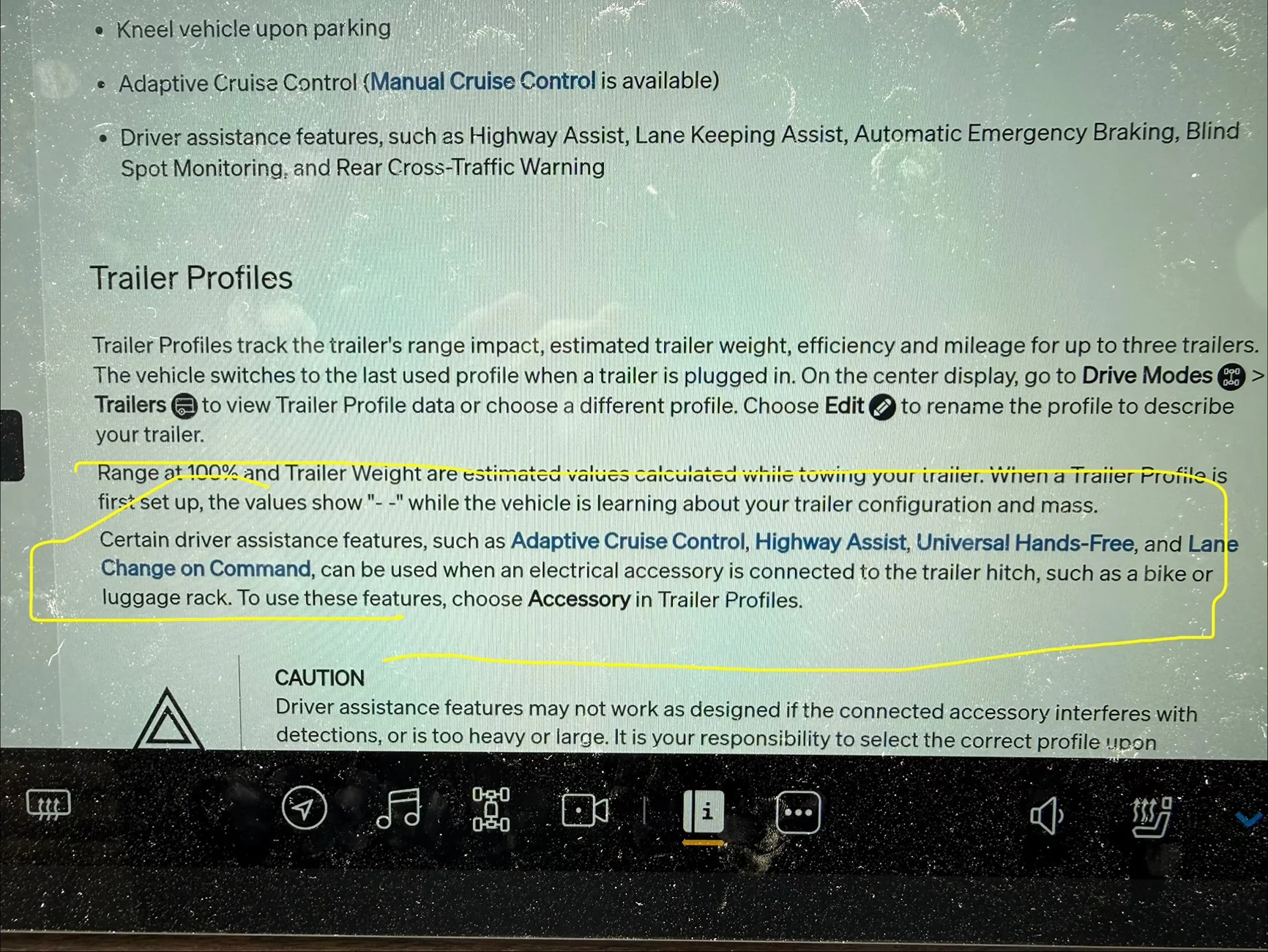

The comment about Driver+ features affected refer to rear obstacle warnings or rear parking assist features.
There’s no concern about Autonomy + feature use, they are completely available, I use it all the time transporting the bikes. Here’s a shot from the manual proving the point:

That helps very much! Thank you!
It's crazy that no one at Rivian knew this. This is a huge advantage over Tesla FSD, and something Rivian should be proud of and make more visible.
