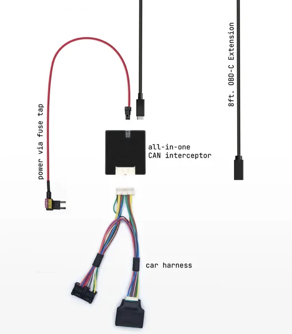

I have been running the comma harness with out Longitudinal and I now am going to install the angle upgrade. Just to confirm on a Comma 4 you need both USB-C ports connected for the longitudinal/angle upgrade?
LivingInKaos
LivingInKaos
If you are installing the Extreme kit, you will only need the ODB USB cable. So the aux port on the side of the comma 4 will be unused.
The image on the store looks as though it only needs the single OBD-C:
Yup that's what Kaos was saying. You only need the one cable going up to the Comma.
If by 'angle upgrade' you mean the Extreme dev kit then, no, it only uses one USB cable.
