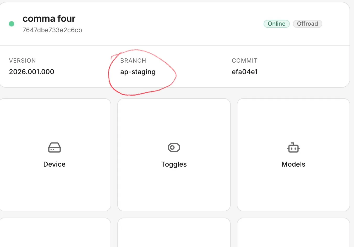

Also, on Sunnylink the branch name is right there in the device details section.
Well, I guess I had successfully installed Adventure Pilot, after all. This apparently explains why my steering wheel was able to go past 90º. Now that I realize this capability, I will have to experiment with it a little more.
