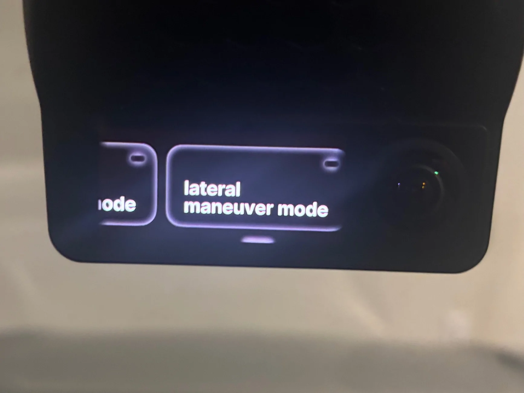

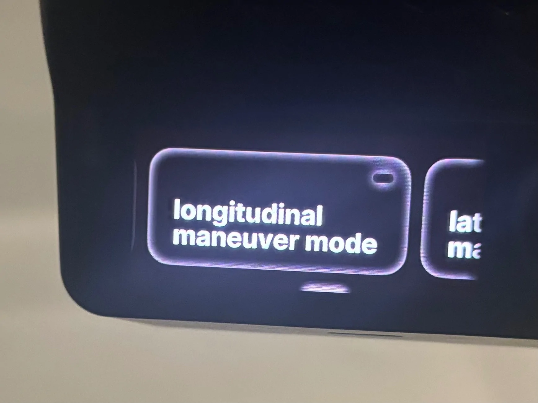

Another question, what are these toggles using the SunnyPilot Stg-A program.
Rivian R1T R1S Comma Extreme Dev Kit NOW AVAILABLE IMG_5352
Rivian R1T R1S Comma Extreme Dev Kit NOW AVAILABLE IMG_5353
Both of those are debugging tools for the devs - nothing a standard user needs to mess with.

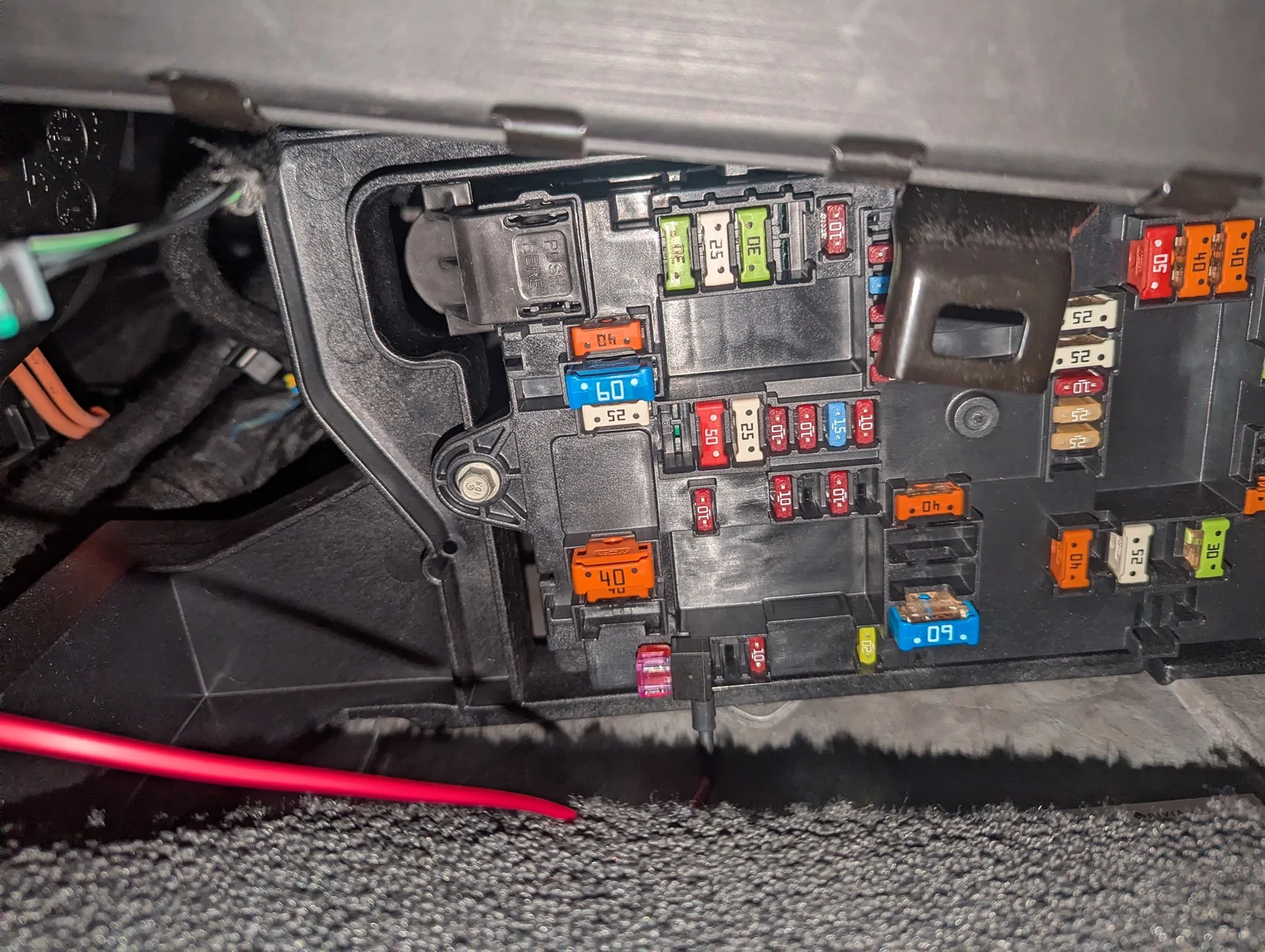

Whew. Alright, I installed the harness. Axm is connected and wires ran but i don’t think I’m doing the fuse tap right. Can someone send a picture of the location and which direction the fuse tap is supposed to get installed? I have it plugged in but the comma 4 won’t turn on. USB cables are fine cause I checked them with standard outlets. So my guess is it’s the fuse tap. Any help is much appreciated!
It should be installed so the tail faces the front of the car.

I have power! I’ve never been so happy to see a , lol. I was going off the video you did @gerrylum and totally forgot to look further down in your guide for more detailed directions. This was a 2 day adventure for me (I somehow overlooked the T25 bit requirement, so had a delay) but I am connected! Thanks again @gerrylum
Nice! Glad to hear you have it powered up - now it's time for a test drive!

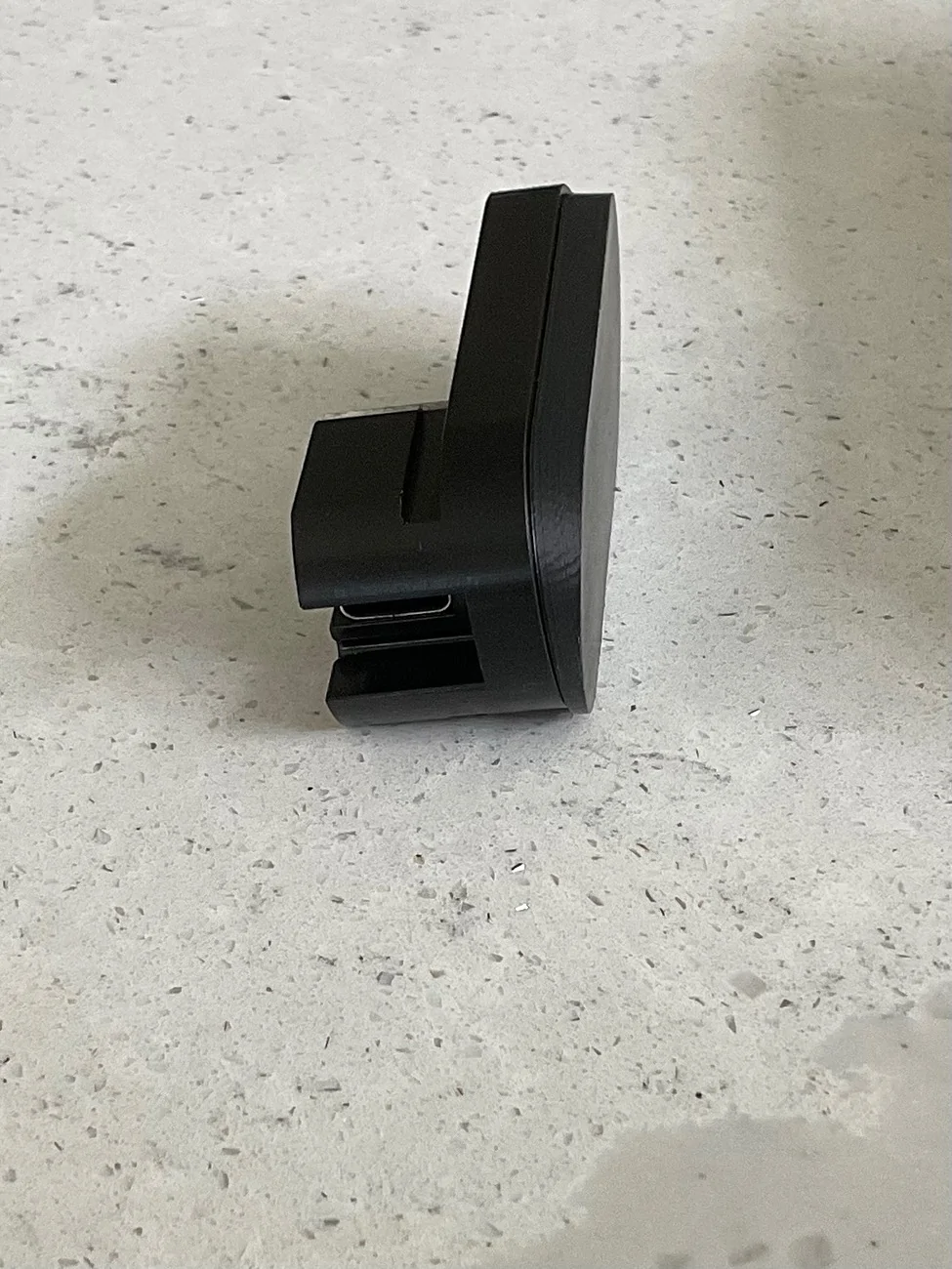

@gerrylum I watched your video on the janka cross glide mount. I have the 8 degree adapter, does that connect to the windshield part? And as far as orientation, I would assume that the larger angle should be at the top of the windshield so the comma is angled “inward” towards the windshield.
It's so hard for me to visualize without having it I front of me, but yeah you want to orient it so that it pushes the camera view up.

So, the thicker part of the wedge needs to be at the top.
