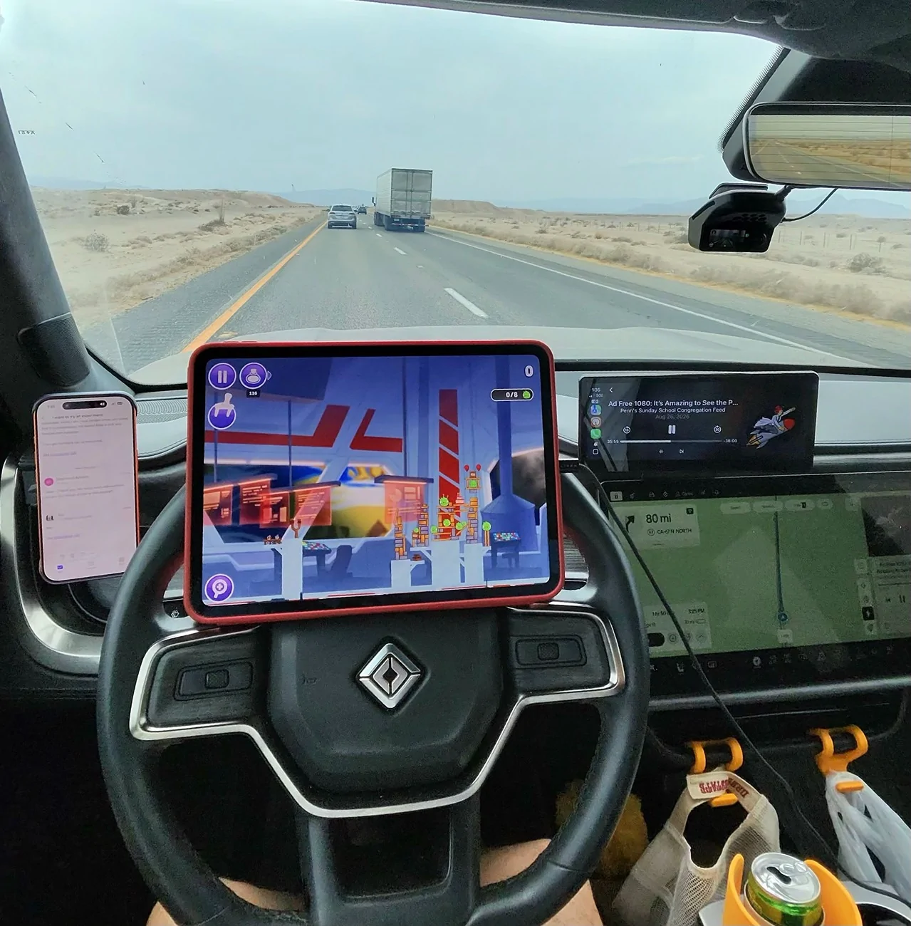

You can put it higher with a different cable, or a right angle adapter, and/or modifying the box. But I think the C4 has zero visibility penalty, while I did not like the C3's size at all.
Also, you can't have too many screens. But the C4 is really not in the way.
Rivian R1T R1S Comma 4 Four released 1787941702719-cy

Oh my, are you not worried about steering wheel airbag going off in an front collision?
SwampNut
Carlos
Apr 22, 2024
56
3,969
4,275
Peoria AZ
2022 R1T Launch Edition
Geek
I just took the photo to troll a friend who hates car screens, not for actual usage. The timing just worked out to also use it to show the C4.
