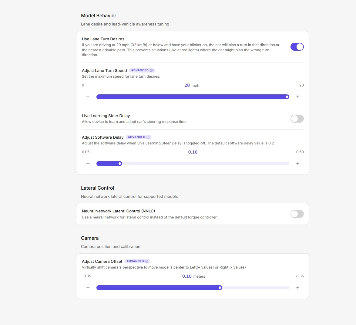

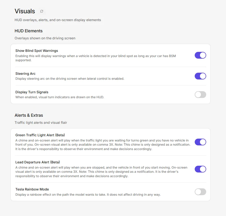

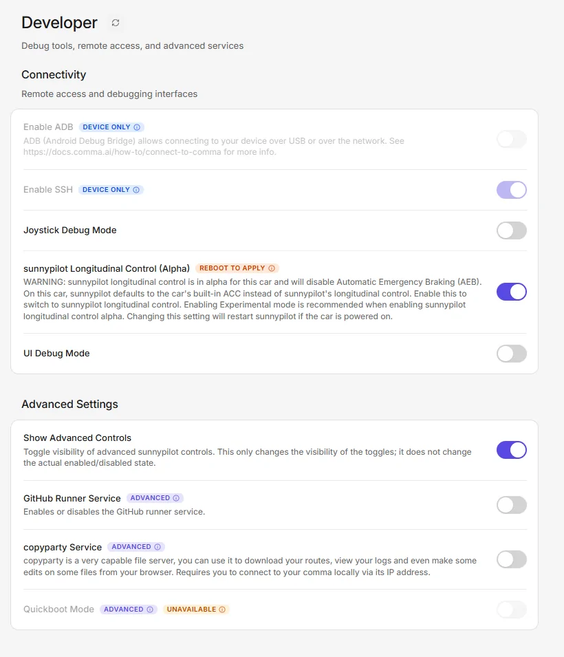

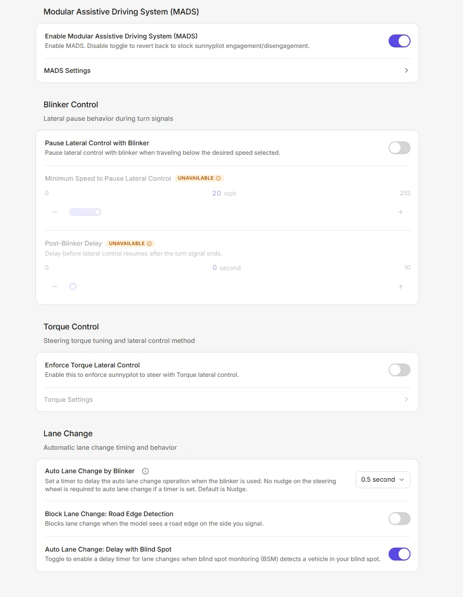

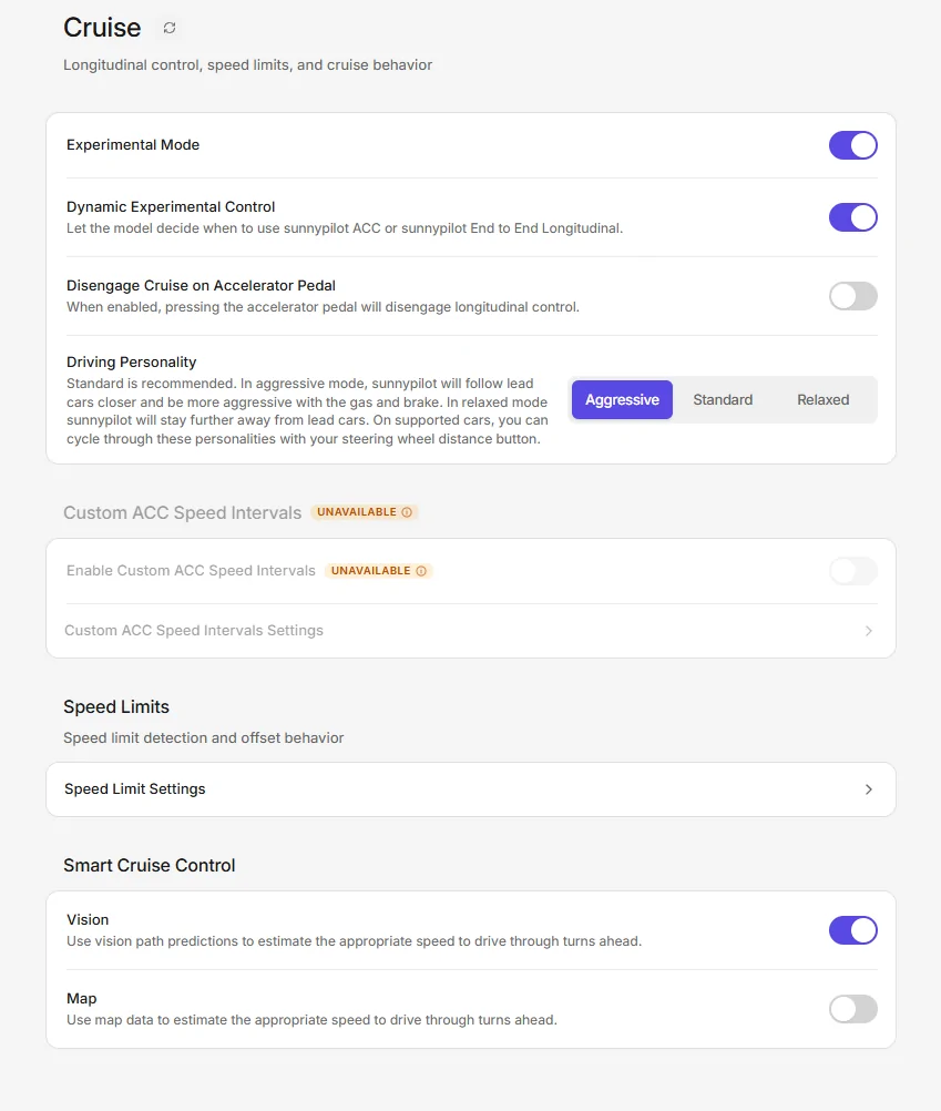

Here are my settings:

GOAT, I almost had all of them the same except enabling experimental mode from following your replies on threads and YouTube comments!
Thank you for the fast reply and always being so helpful.
No problem! The experimental mode settings are totally optional.

How do I turn off the street turnings? Is it just turning off lane turn desire?
My experience with the street turns have not been good and I don’t want to mess with it until I get used to the main functionality.
gerrylum
Gerald
Apr 25, 2023
615
859
Providence Village
Director of Marketing
Turn off lane turn desire.
