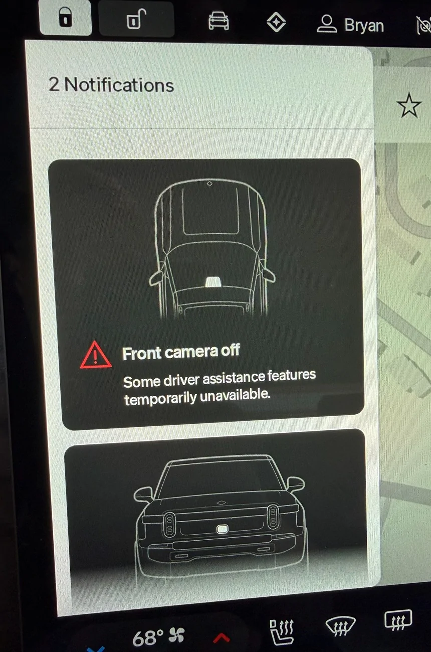

Hey everyone -- thought I'd revive an older thread. I'm back with more (I think) harness issues. After solving my camera fault issues for months with the fuse tap, I did the latest Rivian software update (2026.15.0) with the Comma disconnected from the vehicle, but with the harness in place. Since that time, I have a permanent front camera/front sensor fault.
I've tried reseating all the connections (while in deep sleep), rebooting, etc, but I'm stuck. Has anyone else run into similar issues? I'm trying to avoid taking the harness out completely, but I'm running out of options.

Might need to try a 12v reset?
