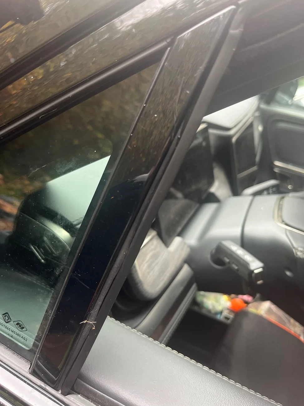

I discovered this as well after the SC replaced that triangle window trim part and the resulting noise was worse. I cut a strip of that round rubber Uxcell 7mm into 1/4 round strips, and jammed it between the window seal and the triangle window trim piece so as to continuously push/hold the window seal rearward against the leading edge of the window. Noise gone. One could definitely spend more time making it look nice, the picture here was me simply roughing out a design to prove the concept.
