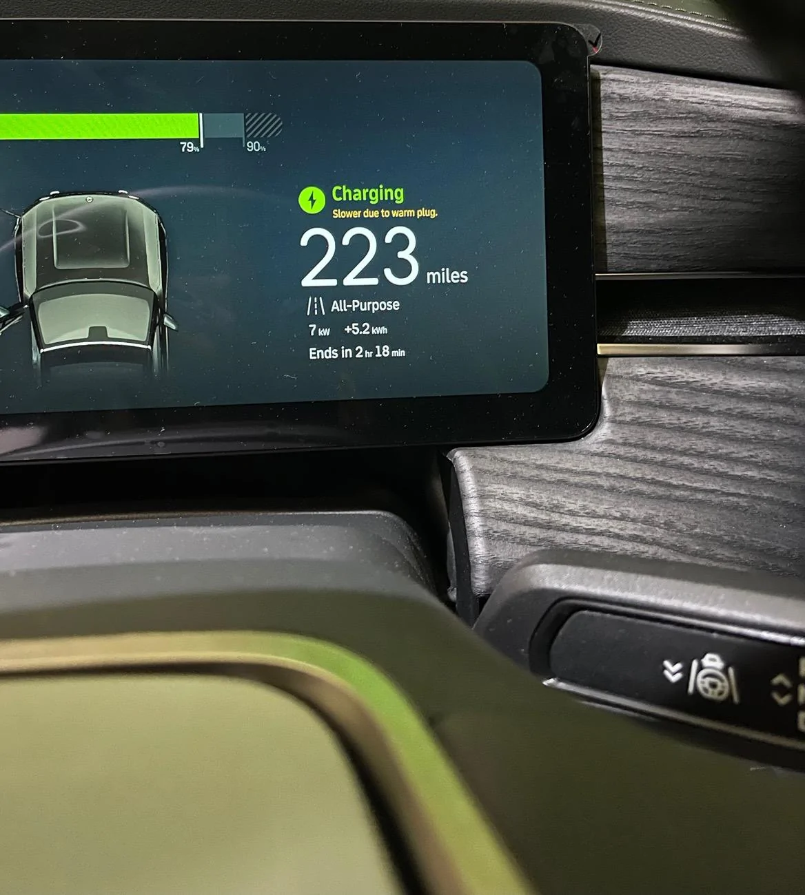

I am having the same level 2 charging derate issue in the Phoenix heat on my new ‘23 T. Charge starts at 10.8kW than reduces to 7.4kW after a bit. I just got the truck and this was literally my first charge with it so I don’t have past performance to compare it to. Came from a model y though and never had any charging issues in the heat. I’m using a Tesla gen 3 wall charger and A2Z stellar adapter that’s installed inside my garage. I’m getting the same charging slowed due to handle temp message. I was starting to think the adapter was the issue (probably doesn’t help) but seems like others are having the same issue so maybe it’s not the adapter. I know it’s not the wall charger because I unplugged the truck and adapter then plugged directly into a model y and charged from 30-70 at 11kW with no issue. And the wall charger has been solid with no issues on other cars in the az heat for over the last year. This would be awesome if it was a software thing that could be corrected. 99% of my charging is at home. Any advice for the Phx heat? Beside move, haha
I get this all the time during summer when my garage is 95 degrees or 100 degrees or higher after Rivian released an update last summer.
I have this warm plug message on my OEM Rivian charger with no adapters.
This is perfectly normal during summer. I don’t have this issue once temps are no longer triple digits.
Rivian R1T R1S Drop charging IMG_2819
Thanks for the info. Now that I know is pretty normal in the heat I’ll embrace my spot in the warm plug family.
