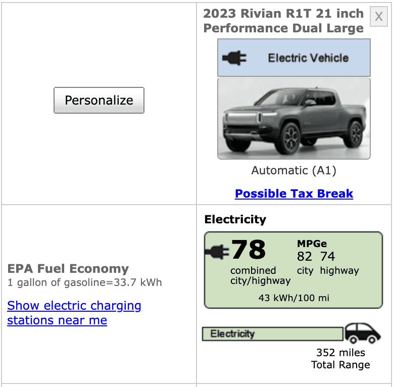

I've doubled checked that these fueleconomy.gov figures are both for the R1T, perf dual motor, 21" wheels. The only difference is the battery pack.
According to these figures, it says the max pack is more efficient than the large pack.
Combined city/hwy figures:
  • Max pack: 84 mpge
  • Large pack: 78 mpge
Alternatively, kWh per 100 miles:
  • Max pack: 40 kWh
  • Large pack: 43 kWh
So, is the max pack more efficient than the large pack?

I wonder if its just a newer software, better efficiency, that wasn't tested in the old one at the time of EPA?
I'd like to see the refreshed EPA test results for all trucks.
Could be software. Could be the new cells used in the max pack generate less heat, so more efficient?
