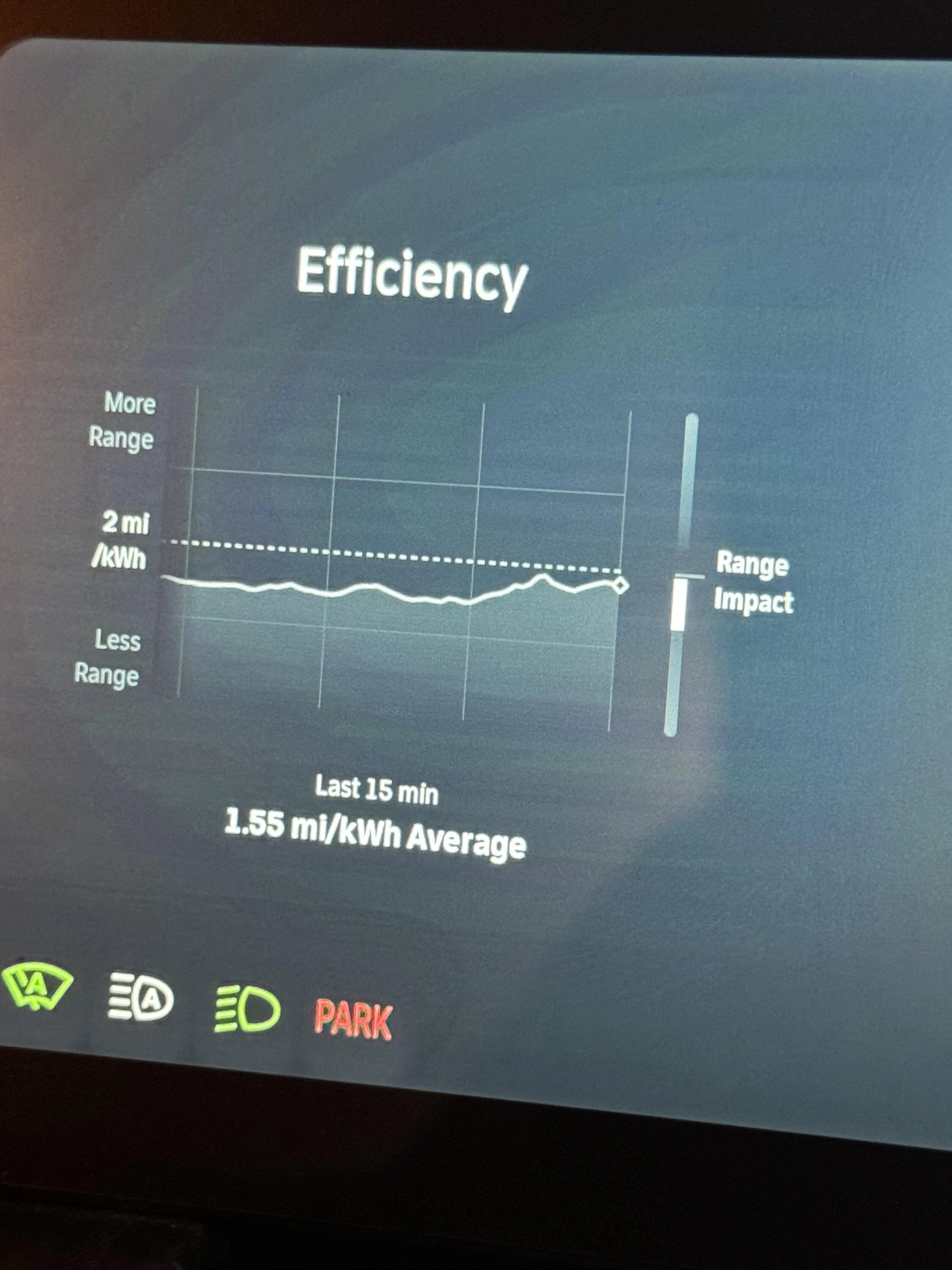

Just drove back home from a night out and was triggered by the efficiency changes the last 7-10 days, so I closely monitored on a 30 minute drive at 70 mph with no wind whatsoever.
heat at 75, 2 dots for 25 minutes
Heated steering for 10
Temp was 43 degrees
Hardly any elevation change
Last mile was in my hood at 25 mph max.
it’s been this way for one week, out of nowhere, after hovering 2.1ish daily.
I have my heat in 73 and it drops my effeminacy to around 1 or so lol

If possible, precondition the cab and charge right up until the point you leave. The battery should be brought to temp (75ish degrees F) and the cabin will be toasty. You’ll use a similar # of electrons net, but your driving efficiency will increase and hence range.
Weird side note - if I immediately put the Rivian in the garage after a longer drive, the heat soak becomes painfully obvious, as the garage warms up considerably. It’s also very well insulated, and has deep concrete under the parking pad, so it stays warm most of the night. Which means the car needs to do less work heating itself up in the morning.
I always think it’s weird to walk into the garage in the morning and have it warmer than the house, but in this case it actually helps.

Either way, I guess I wouldn’t have expected such a large drop with the heat on low setting and the temp not too very cold. In a few weeks it will be 20 degrees cooler.
so we should expect cold temp ranges of 190-200 miles? Yikes.
Assume you live in Iowa; I'm in Western Illinois and can tell you to get used to it. I've tried shutting the heat off and didn't notice much of a difference. During last year's bitter cold period I got 1.1 mi/k. Like others have said 30 minute and less drives in cold weather are really bad. We have not had much cold weather since the enhanced gauge view came out, but near as I can tell the most important factor is motor temp. In cold weather they need to be pretty warm to be efficient. I expected it to be battery temp, but have not found that to be true. Unplug at home with battery at 90 degrees and get bad efficiency until motors warm up.

What if it's in the middle of the day and I've been driving all the day the battery is not cold soaked and it still tanks to around 1? If you're Rivian... no issue found!
That sounds terrible. What conditions are you driving in?
