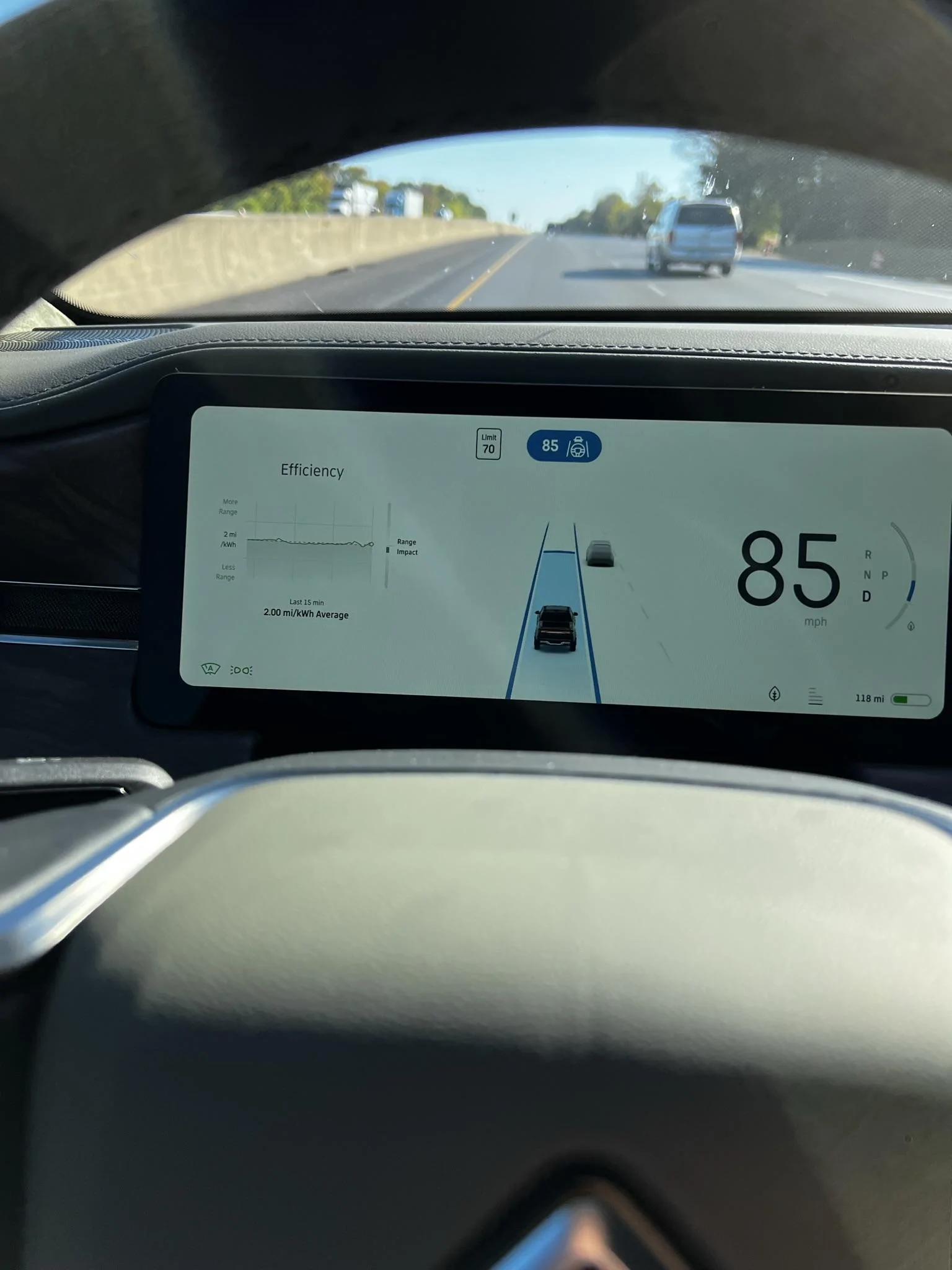

Road trip from Chicago to Nashville 10/2/22. I got 2mi/kWh on average. Driver assist and cruise at 85mph. Config in sig.
Edit: In conserve mode (leaf below 85 in photo). Lowest ride height. Ambient temp ~68F. Didnt run AC much. Since it was a nice day.

Conserve mode?

Yes. Should have posted that. The little leaf below the 8 in the lower right corner of photo. Temp was about 68F. So not running AC much.
Awesome, sounds like conserve mode makes a massive difference. I wonder if it backs off battery heating and HVAC like the Tesla range mode does. That would be a reason to use it sparingly but until I hear otherwise I plan on kicking it on for every road trip.

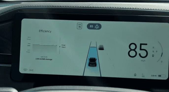

Possibly a dumb question but where are people pulling the stats from.
Push and hold the left steering wheel "left" or "right" buttons to show the 15-minute efficiency graph on the left side of the console. That'll give you rough ideas, or good idea if your driving is consistent over a 15 minute period.

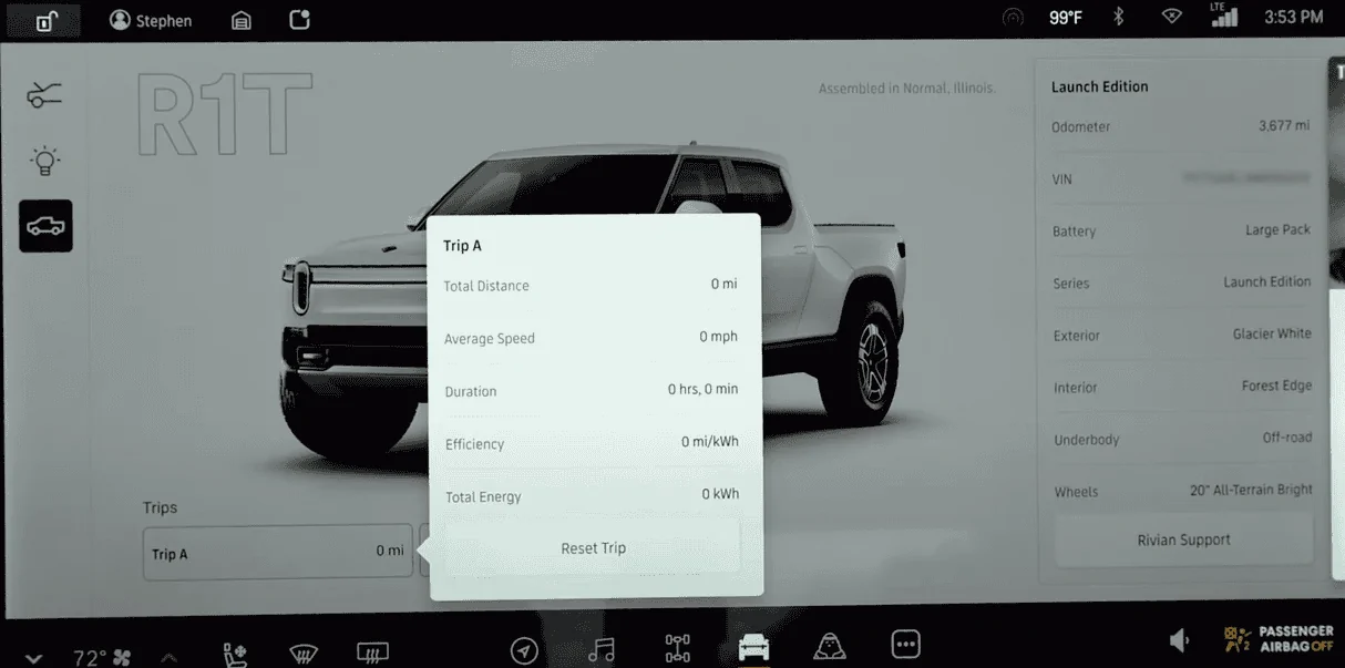

Alternatively, in the "Vehicle" app (fourth icon along the bottom) in the "vehicle" tab (third icon on the left) you can access trip meters. These give you efficiency information for your "trip", which you can reset once you're up to speed and see what efficiency you are getting after a few minutes/miles.
