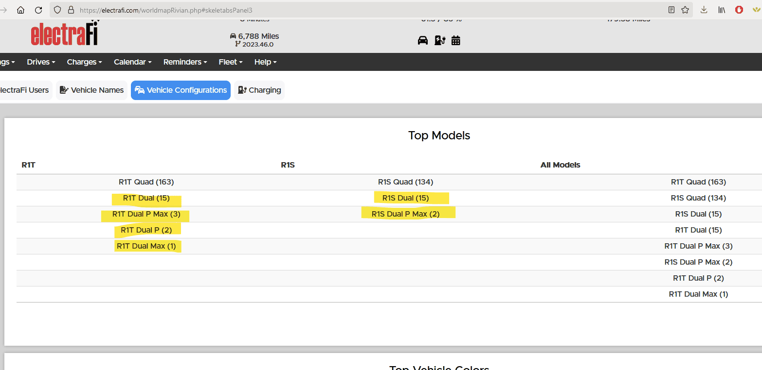

I'm currently in a trial of Electrafi, and I wasn't quite sure what the right way to submit my issues on their support page. But here's what I'm seeing by poking around:
Temperature Efficiency: It hasn't dropped below 45℉ since I've taken delivery, and it's gotten up into the 80s. Yet, the only temperature ranges I'm seeing are "5 - 20 F". If it were "5 - 20 C" that'd at least make some sense, but even then I've driven it when it was 29℃. So even it the numbers were Celsius (even though it says Fahrenheit), I'm still missing data.
Odometer History Timeline: This is blank. No data is showing up. Do I need a minimum mileage or something for this? (I have over 1100 miles at this point).
Tires: I added my tire set this morning. It doesn't appear to back-fill the drives I've made despite setting the start date to be prior to my first drive? I tried rebuilding my driving records, but that didn't fix it.
Fleet: It looks like all vehicles are currently being logged as a quad motor. Mine's a Dual Motor, and when I look at the fleet there isn't a single Dual Motor

There are only about 250 or so vehicles signed on from the looks of it, so not surprised there aren't any dual motors. I've also noted all the other issues you've pointed out. I submitted a ticket about the temperature efficiency page and asking them to display mi/kWh instead of Wh/mi. Under Help, just click on Open A Support Ticket, start typing a headline question and say you want to continue with a ticket instead of looking at support items already there.
Another thing I noticed but haven't submitted a ticket for. They seem to think that everyone charges to 90% or more...and practically no Rivian owners will do this on a regular basis. As a result, there's no fleet history for battery/full-range stats. I finally did a discharge down to 22% and charged back up to 92% and only then did I get a valid measurement showing in that page and the Wh/mi started more closely resembling reality. There's a lot to like in their tool, but it's very clear that the display is still highly reflective of their Tesla roots. Kinda wondering if any of their developers even have a Rivian.
Thanks for the guidance on opening a ticket.
To clarify, my R1T is a dual motor, but ElectraFi shows it as a quad motor (in the screenshot). So I'll let them know about that.
For context, ElectraFi is the EV equivalent of fuelly ?
I've not heard of Fuelly, but after taking a look at its website it seems to have a lot of the same kind of functionality. ElectraFi gives me efficiency stats, plots my drives, tells me my elevation climb/descent, reports battery health, and also shows data regarding the entire Rivian fleet (all other Rivians signed up with the service).

This thread's 10 weeks old ? They added the distinction after I submitted a ticket to them a while back.
Shoot, sorry. I blame the other guy for necro'ing a dead thread, LOL. I just noticed it at the top of the home page and assumed it was new. ??
