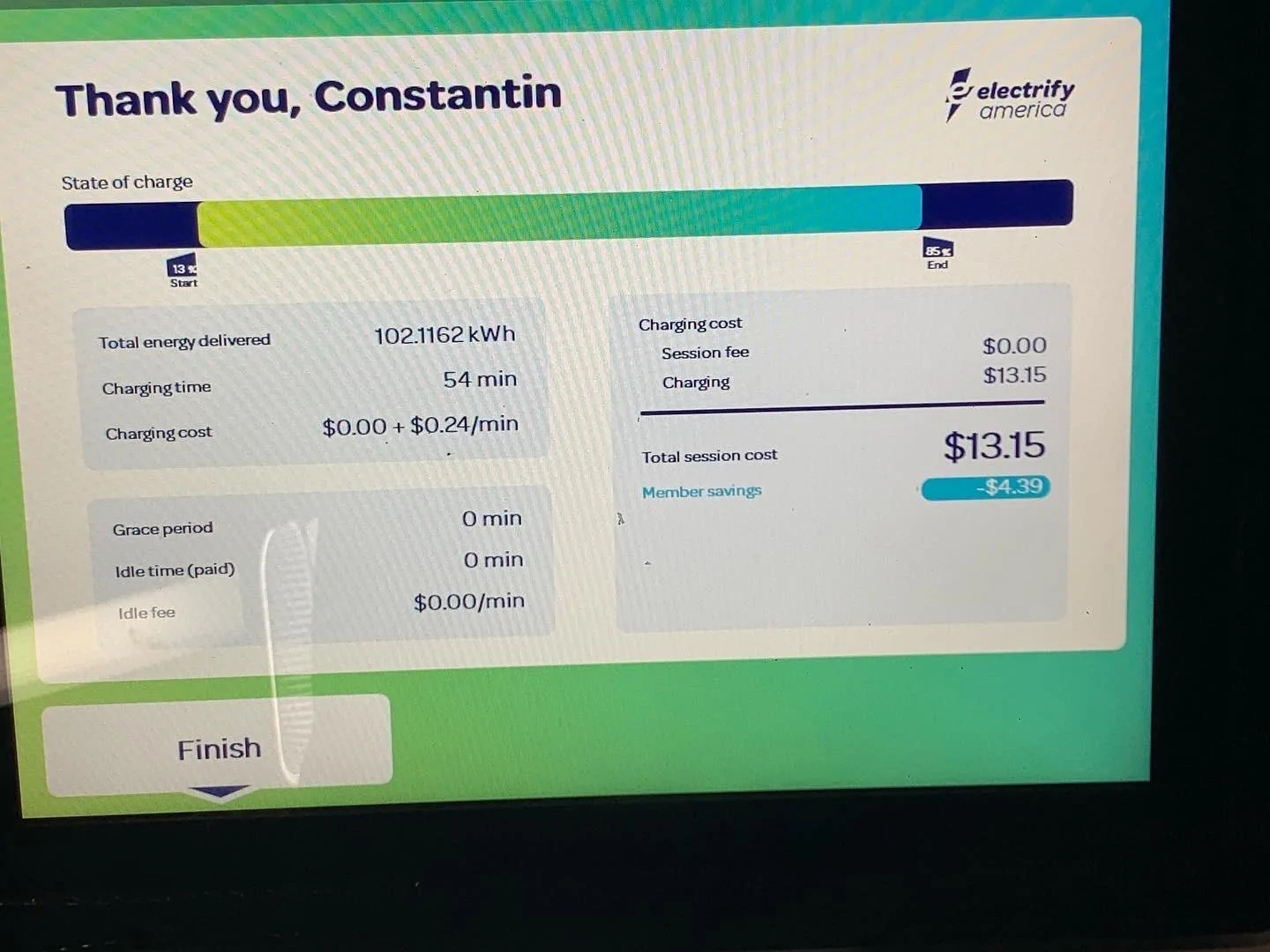

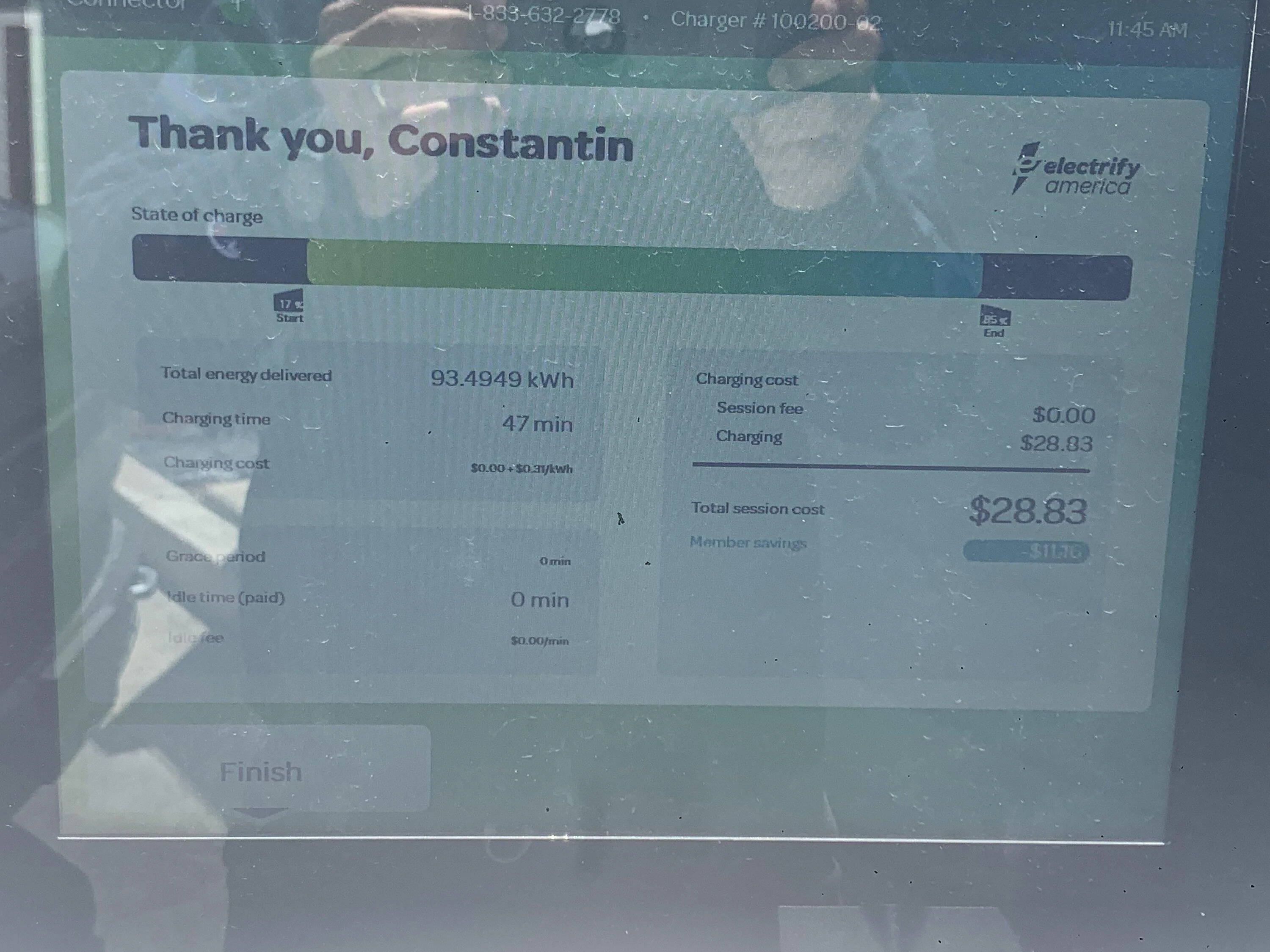

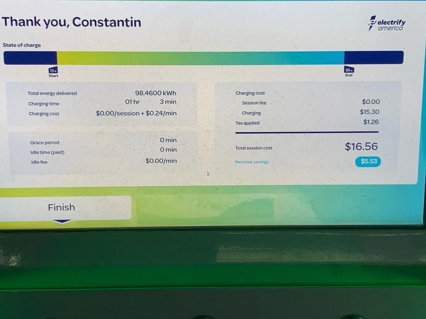

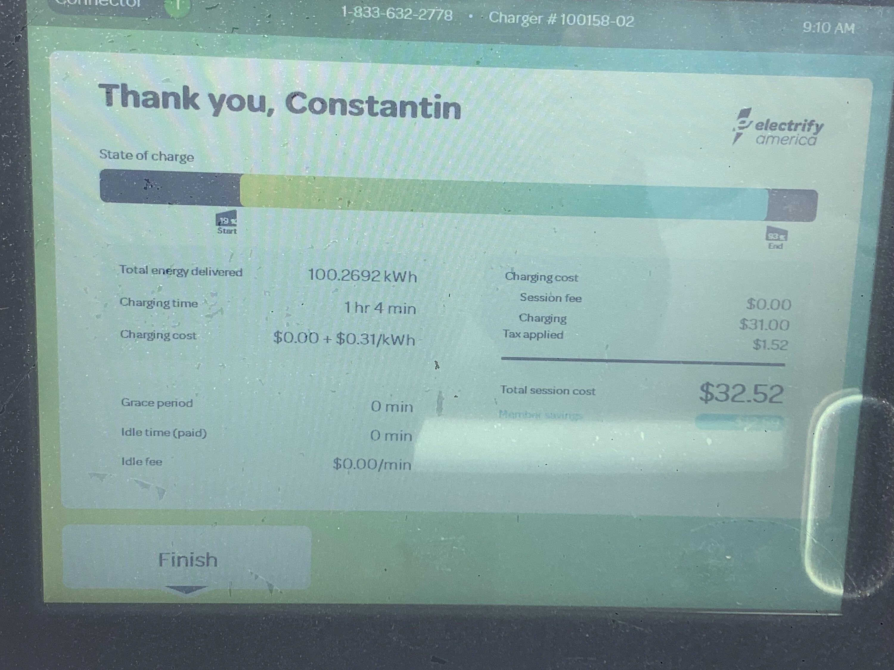

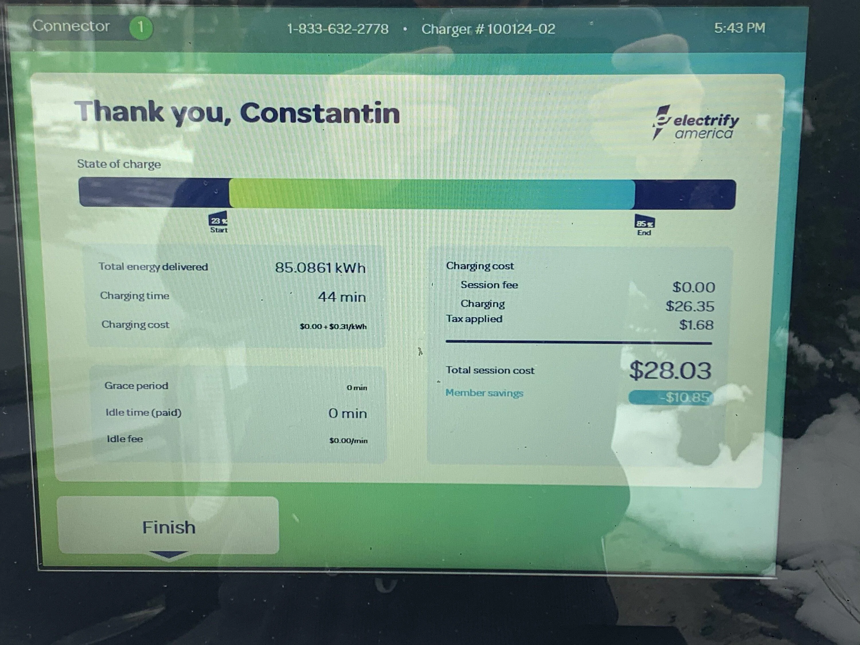

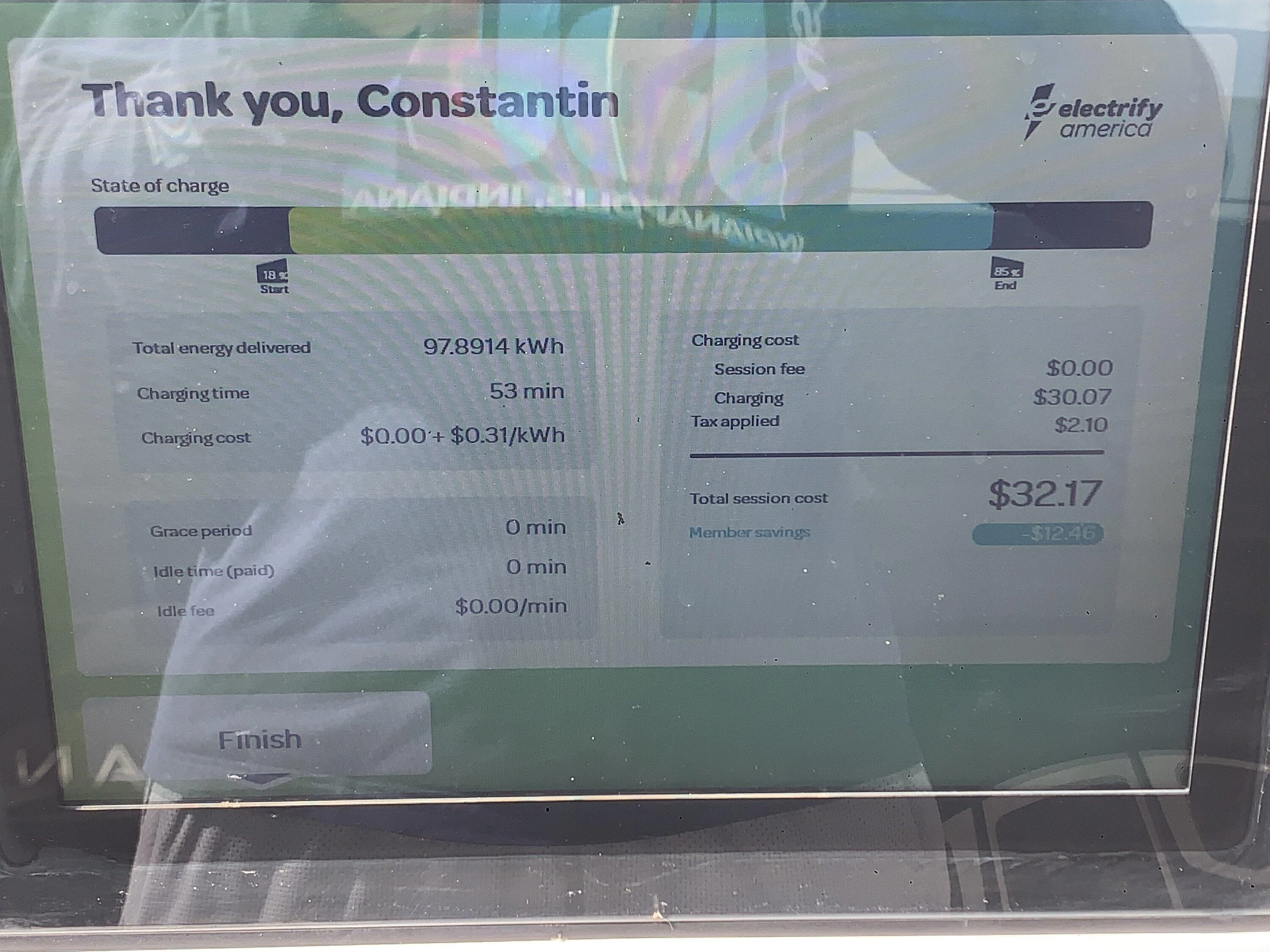

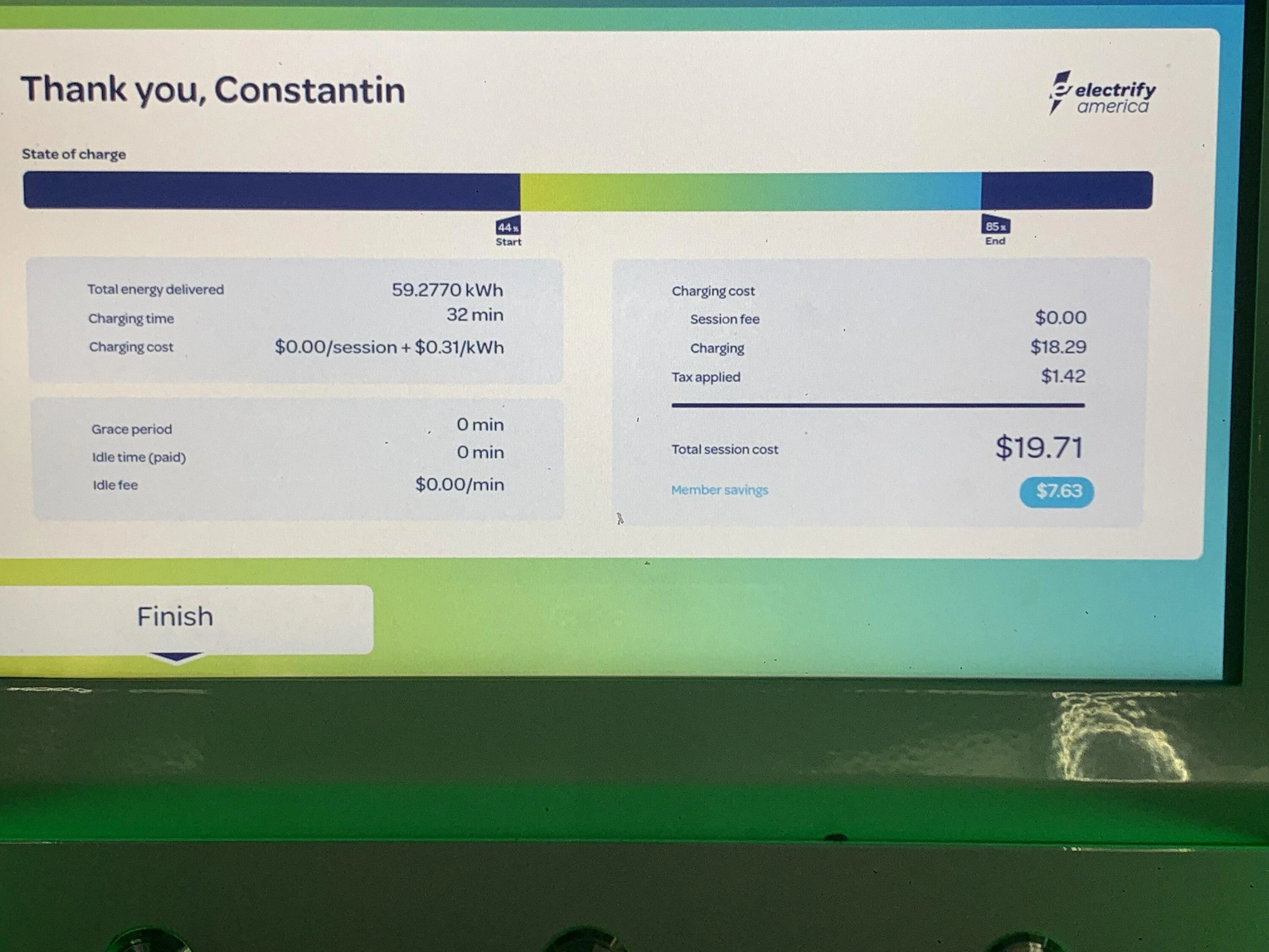

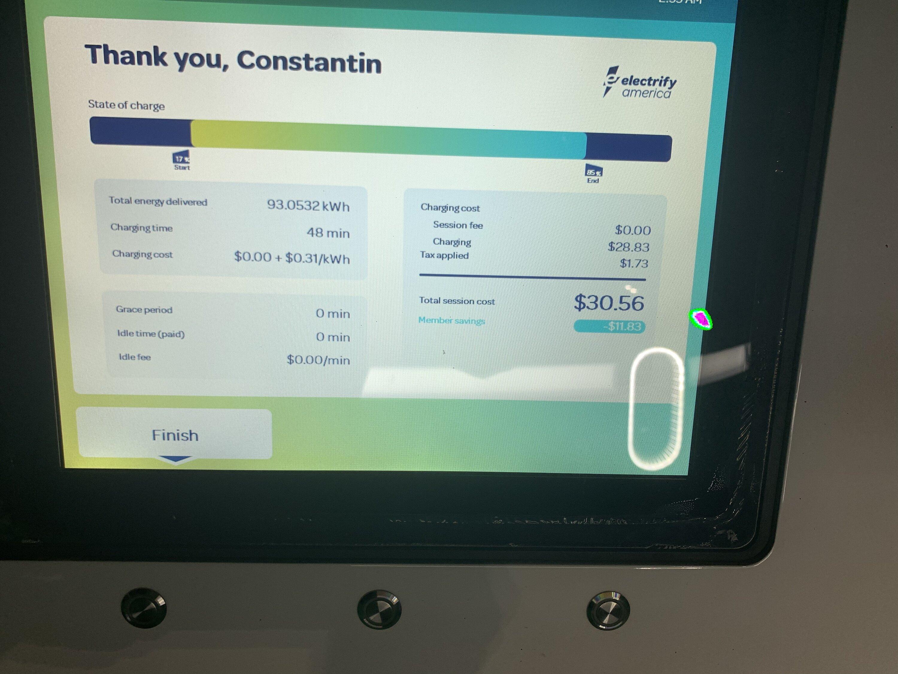

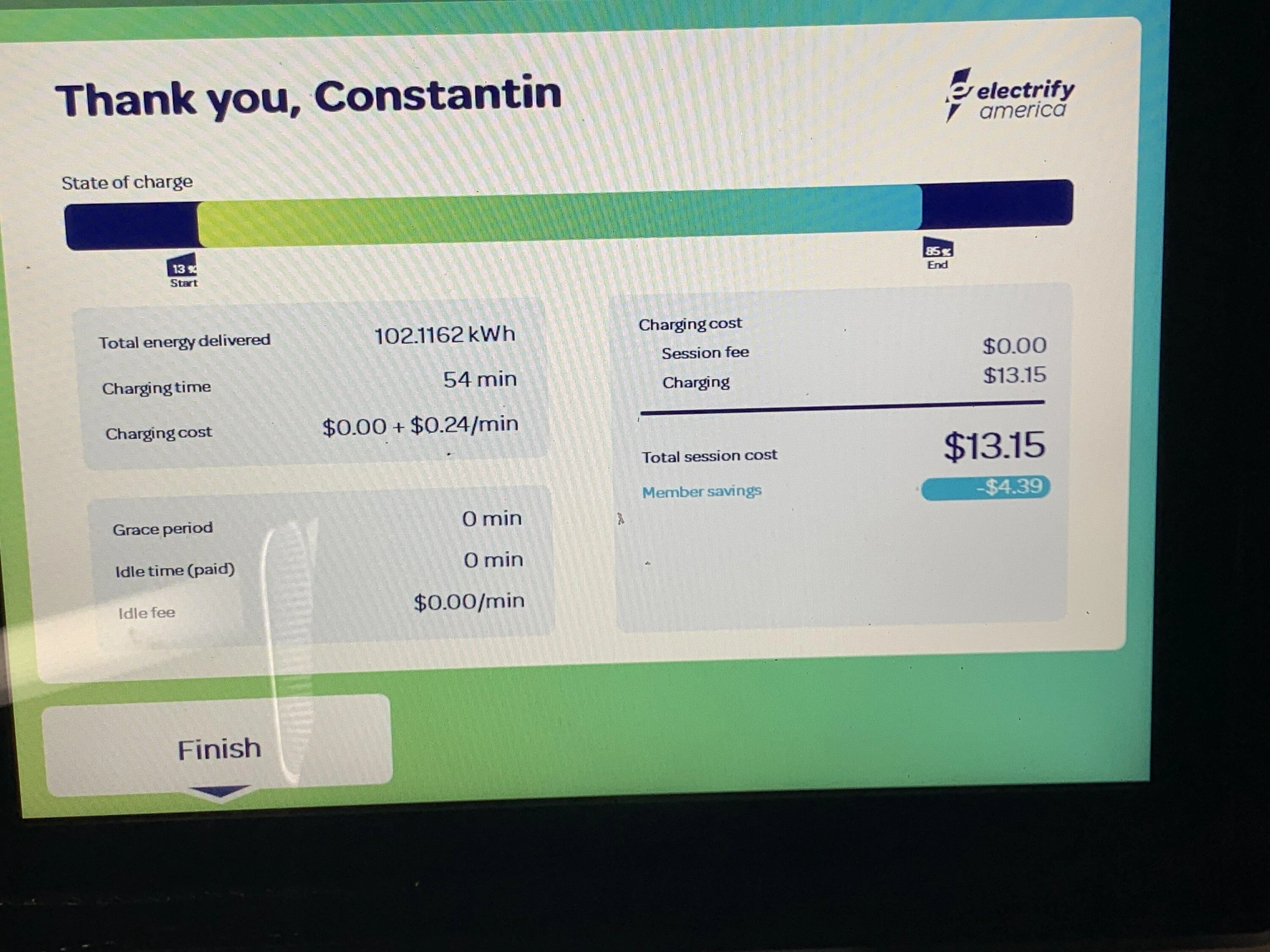

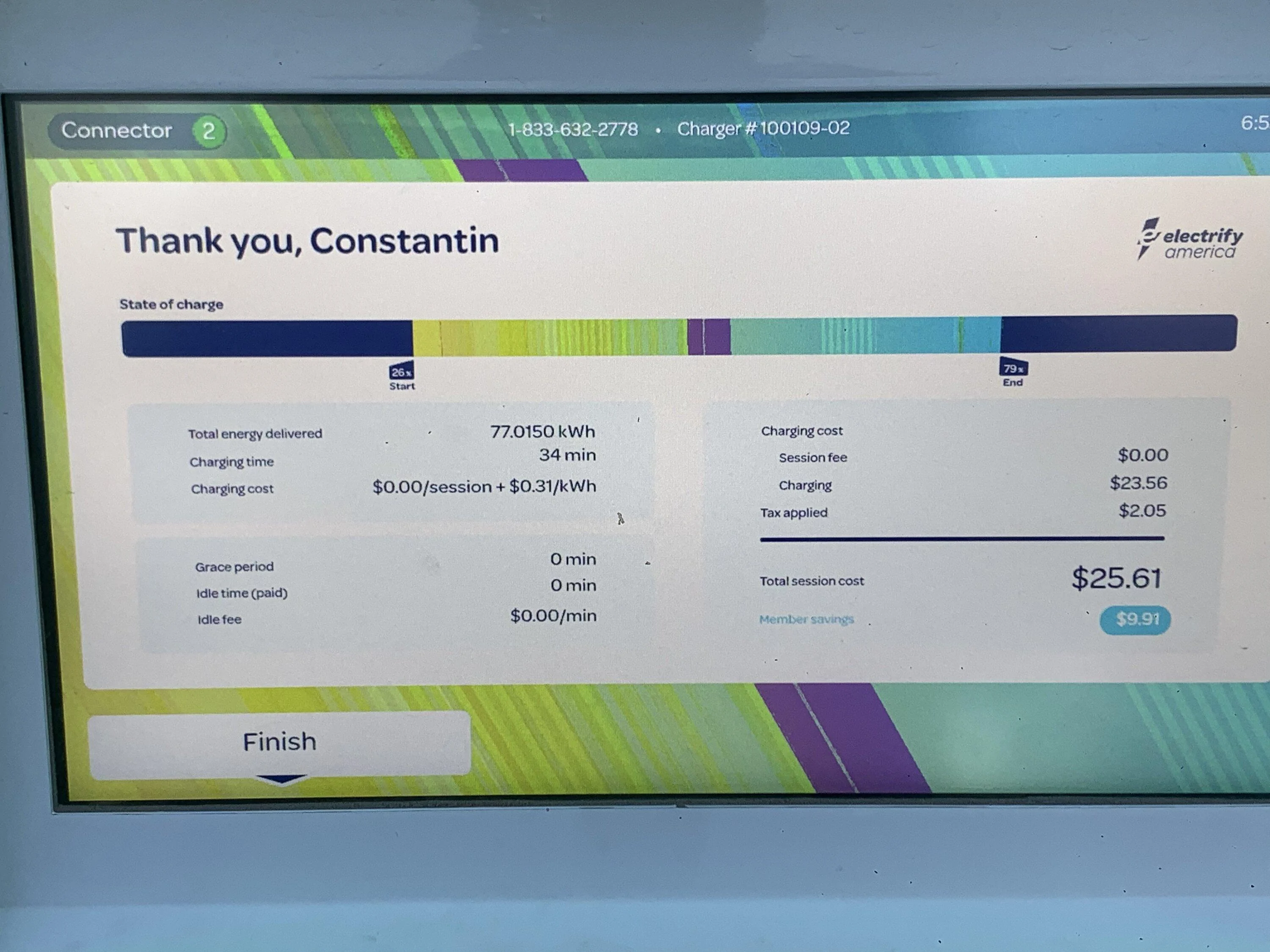

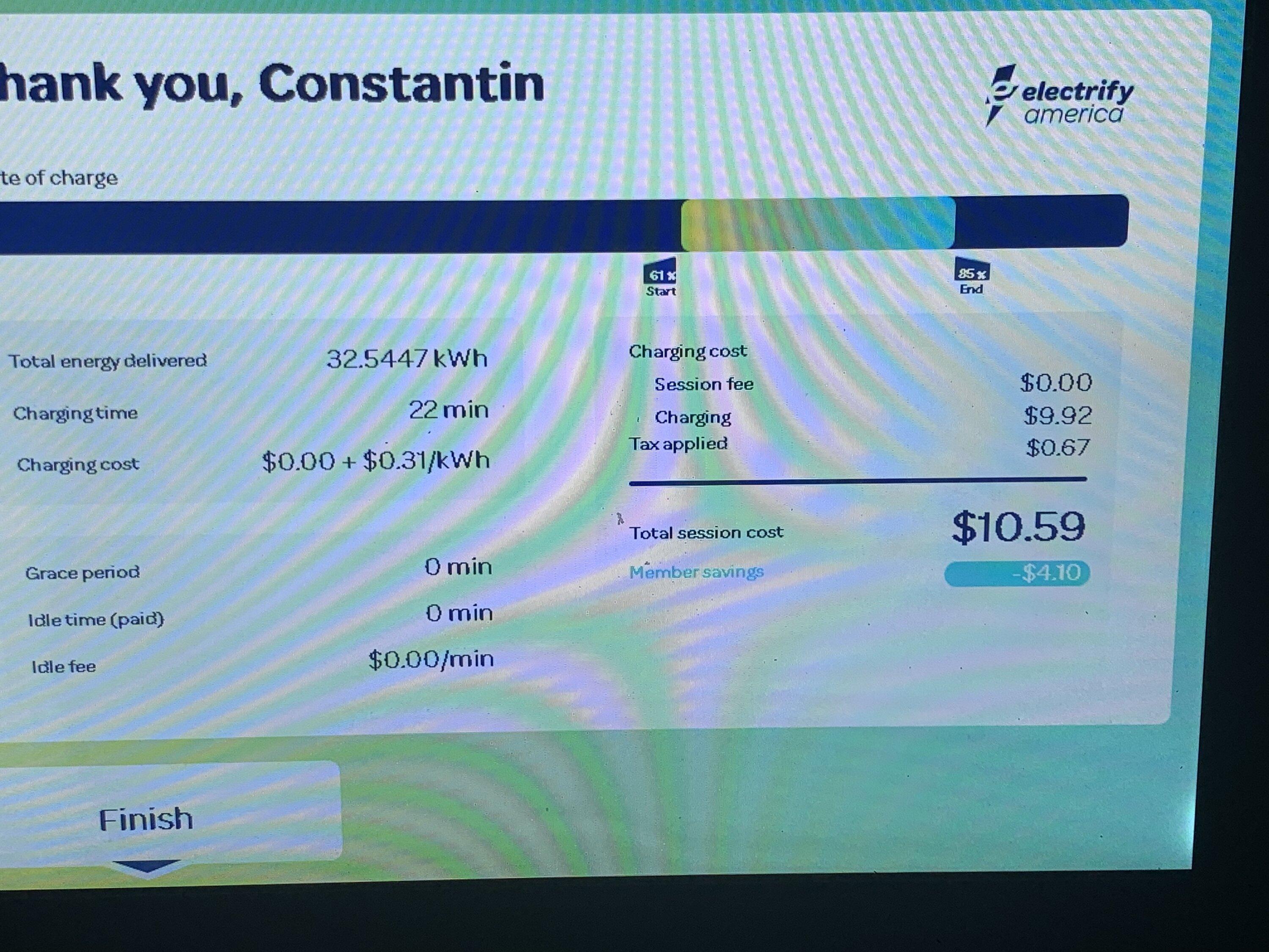

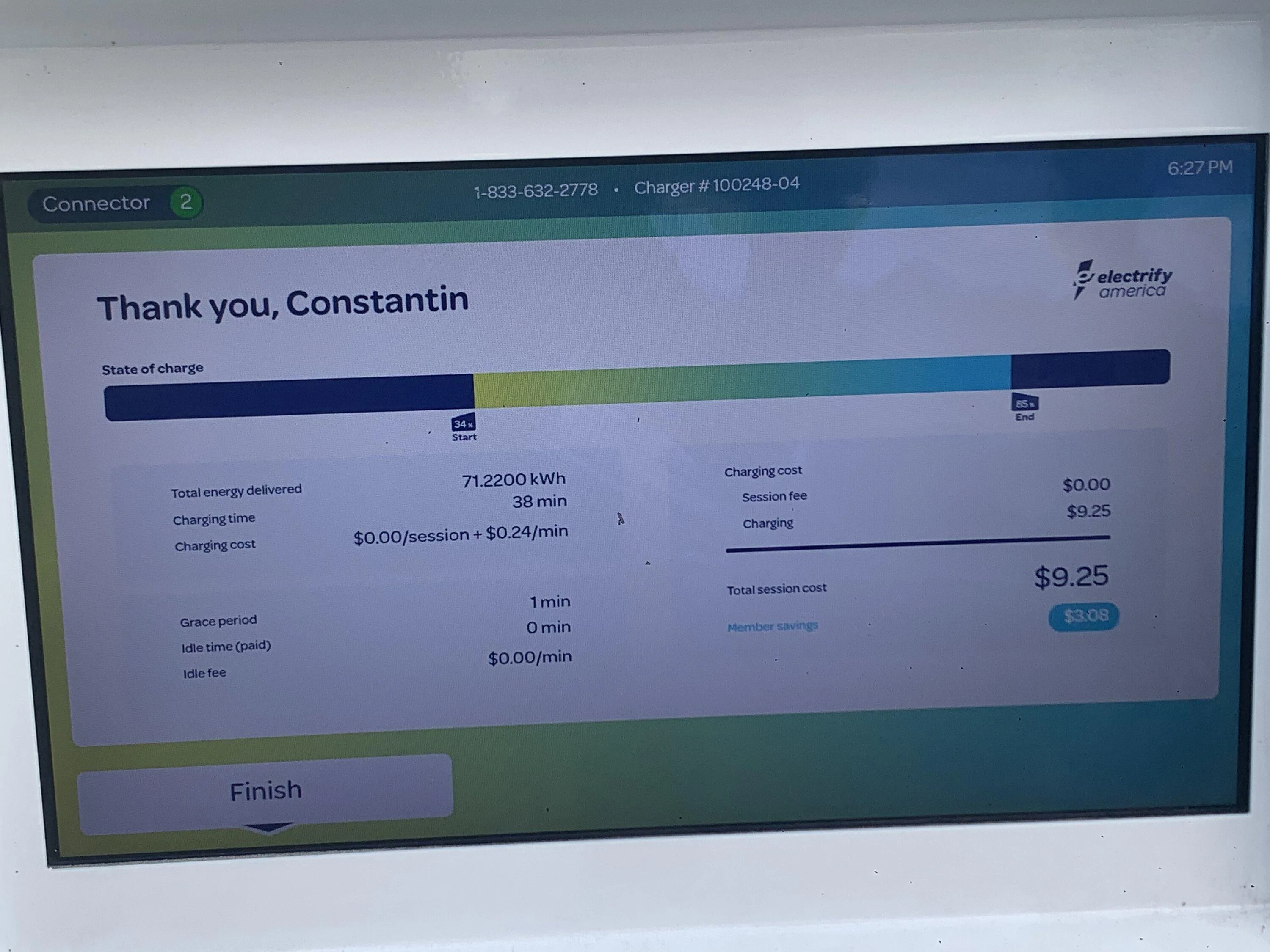

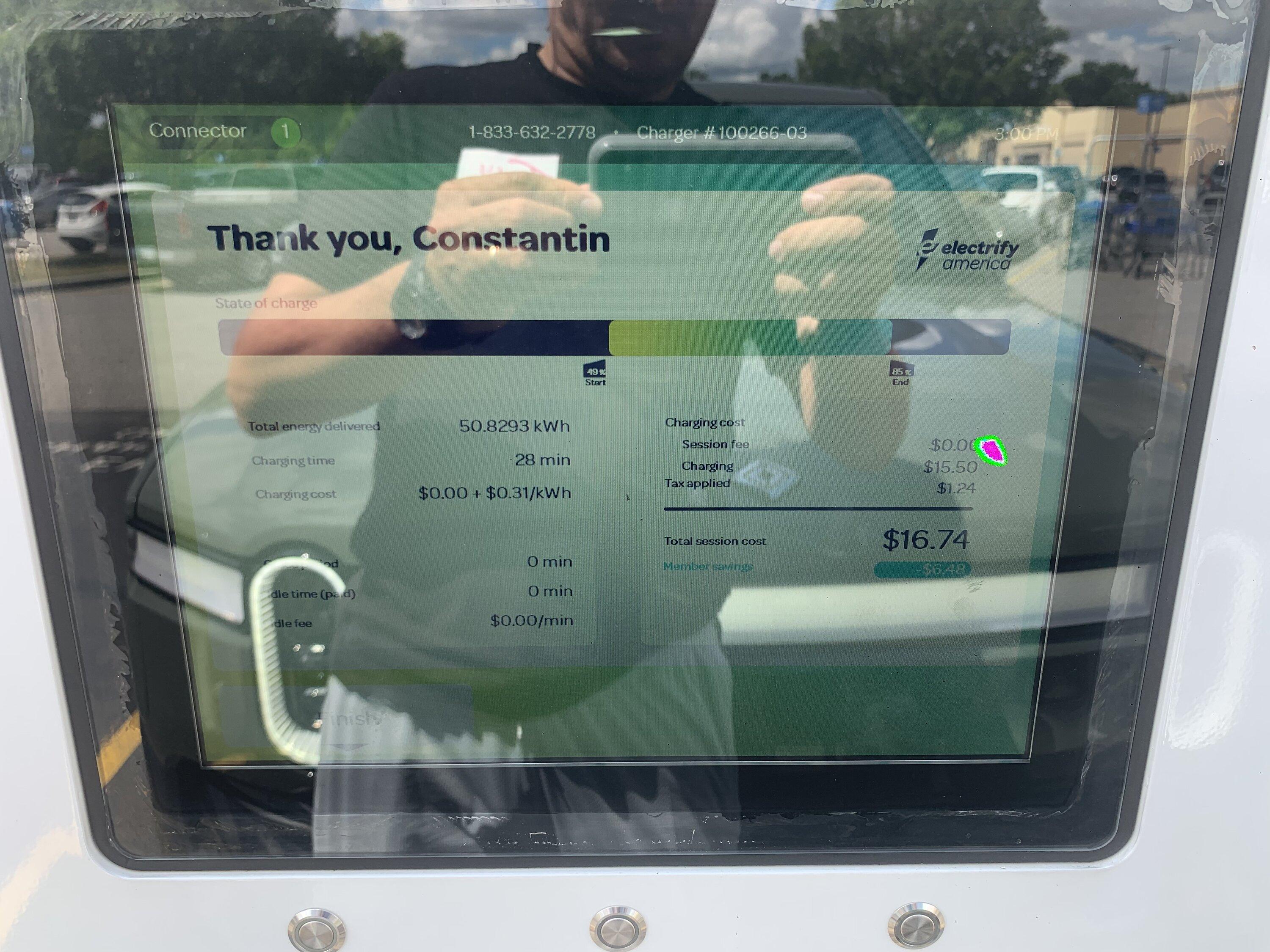

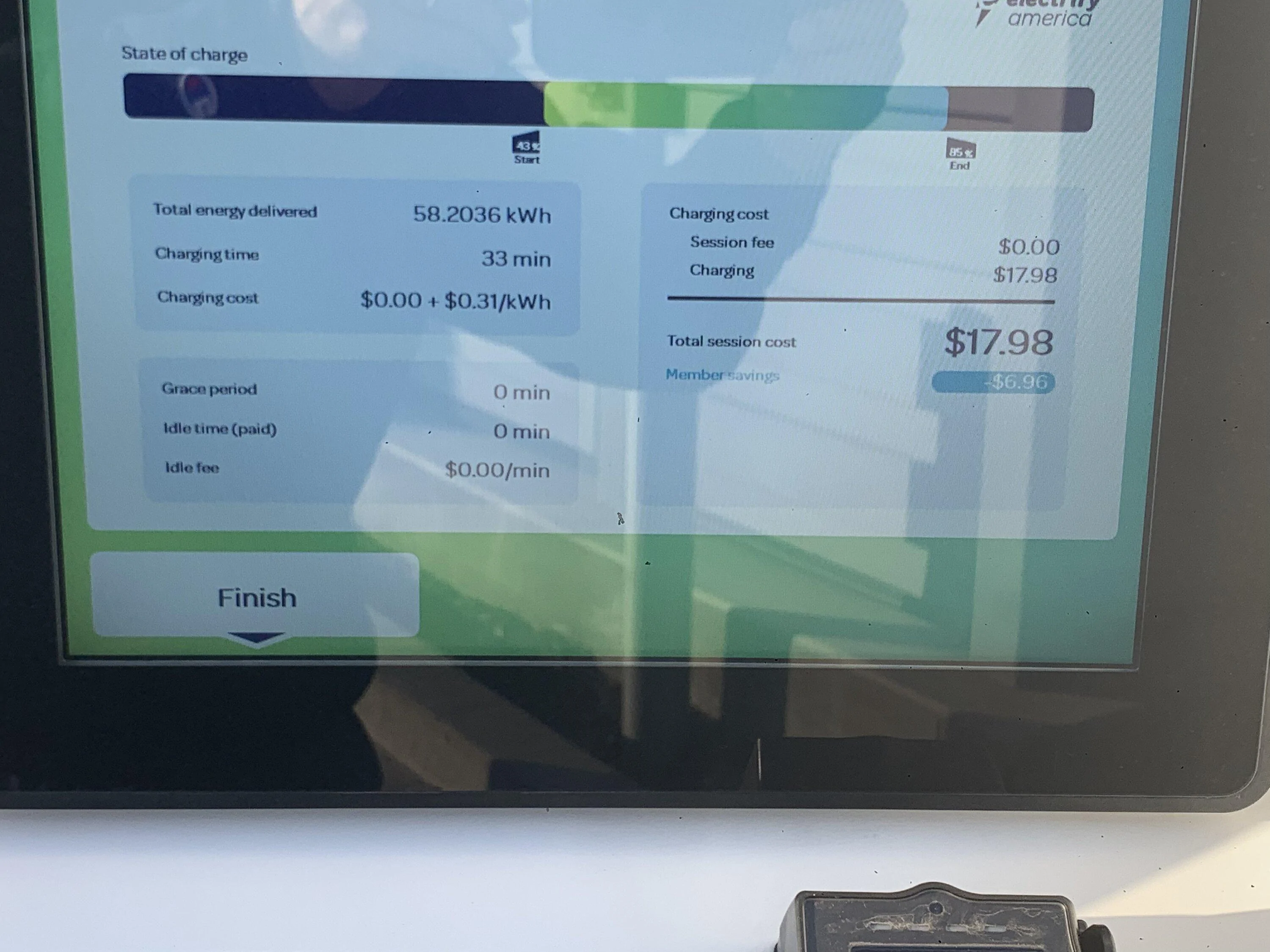

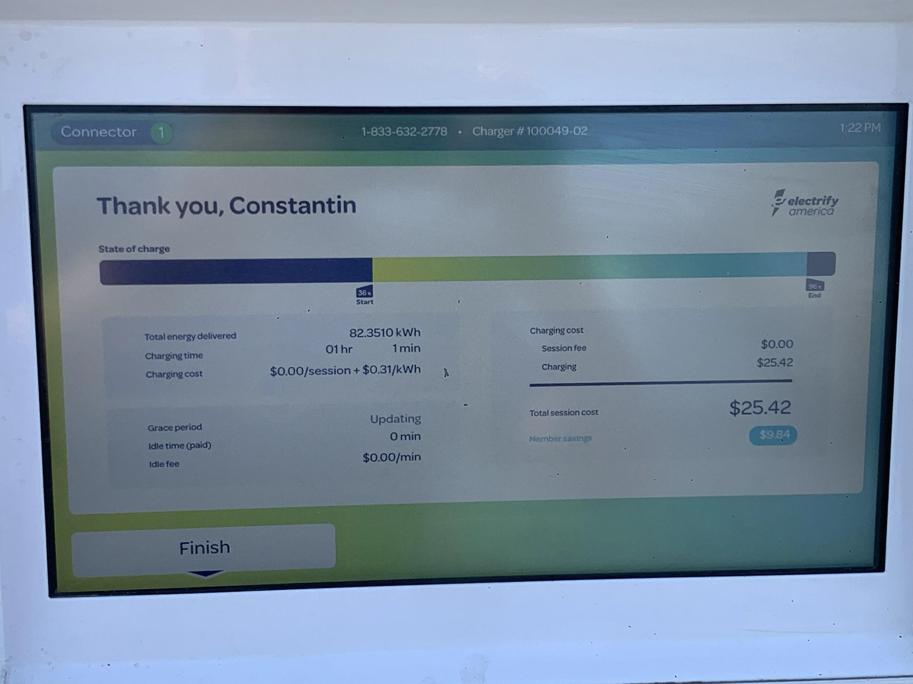

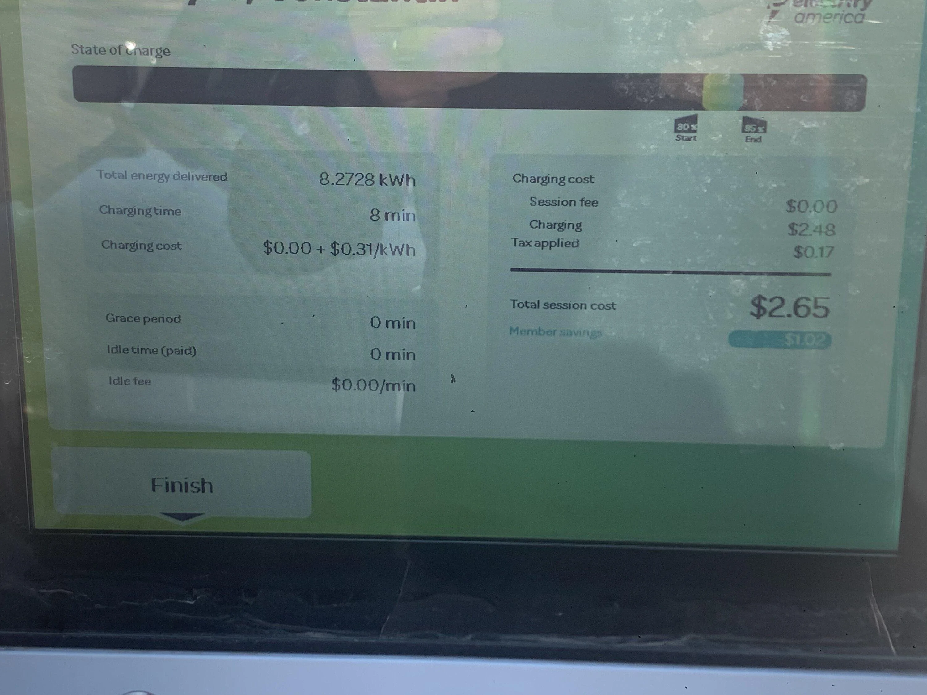

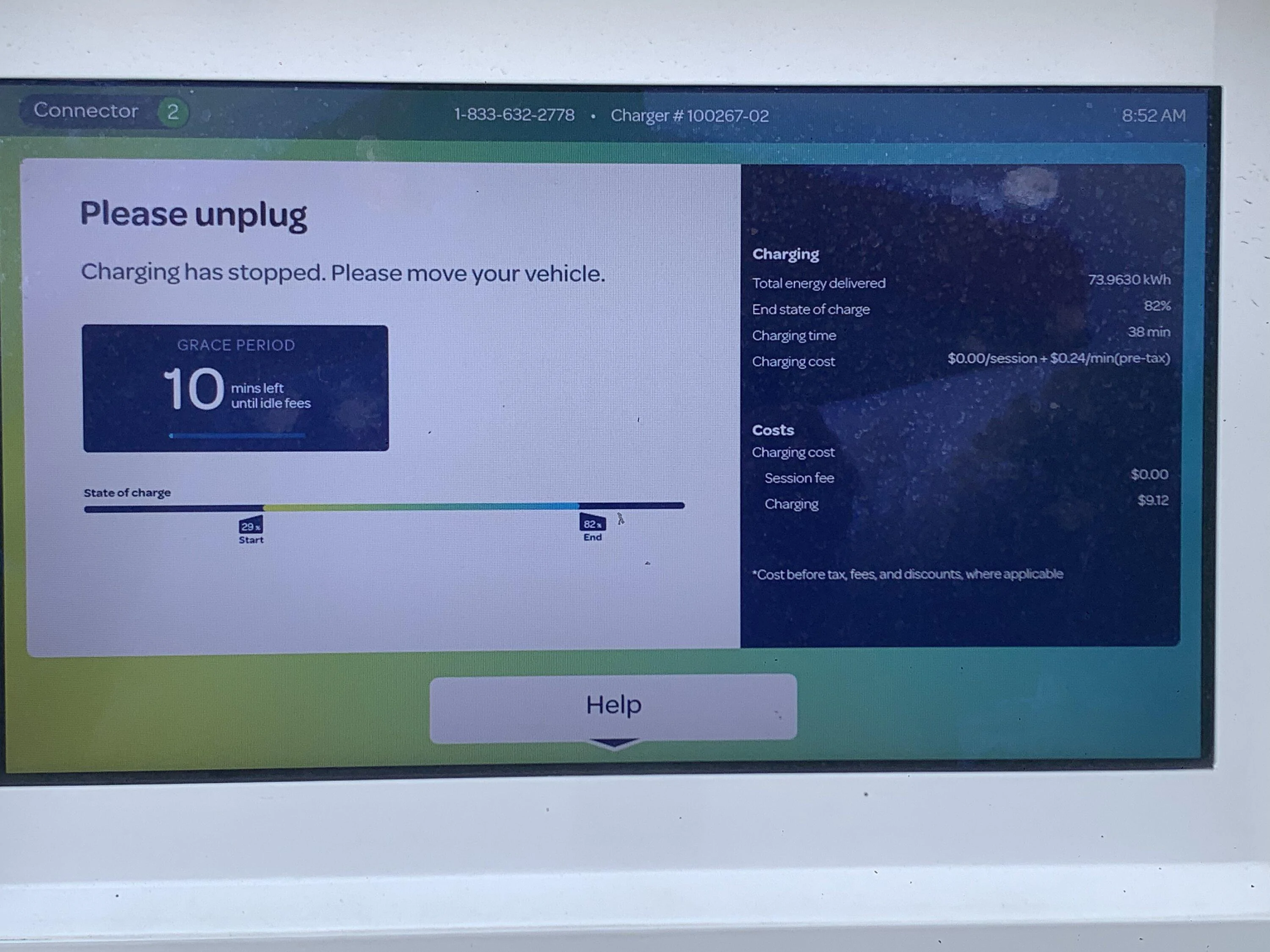

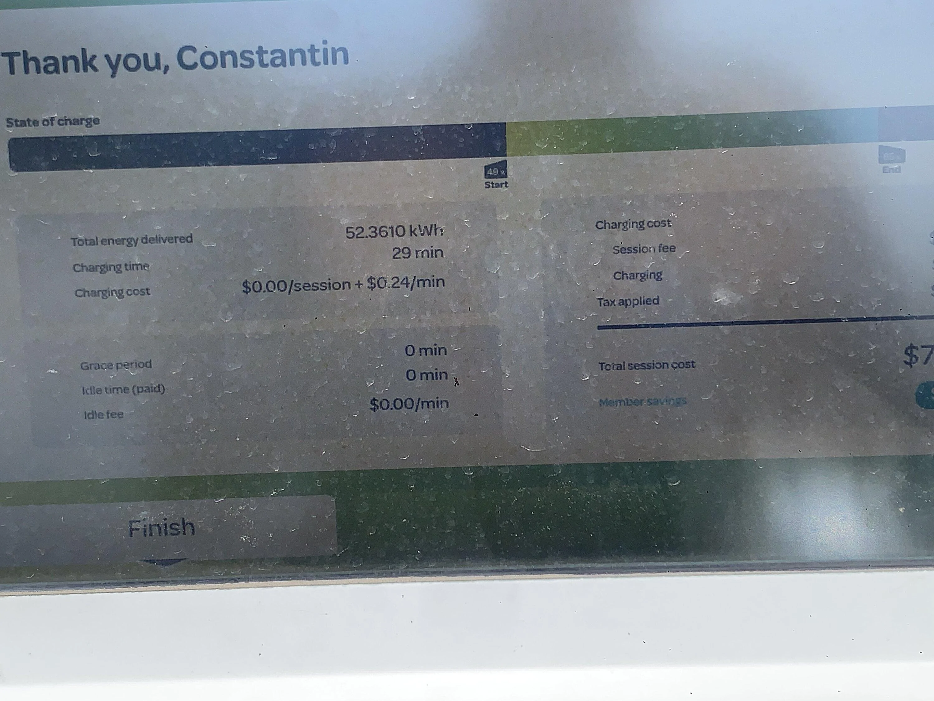

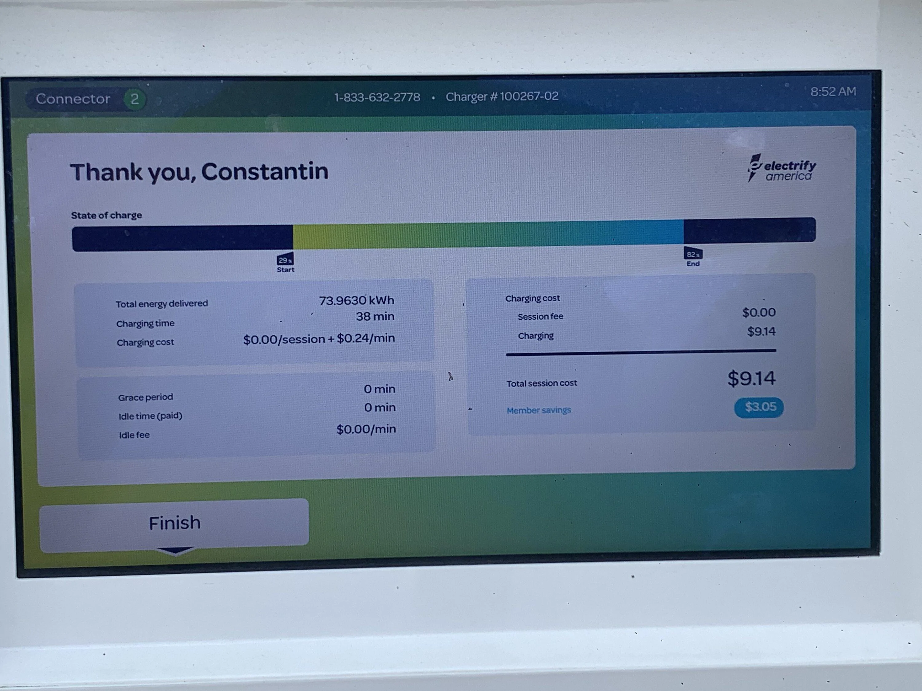

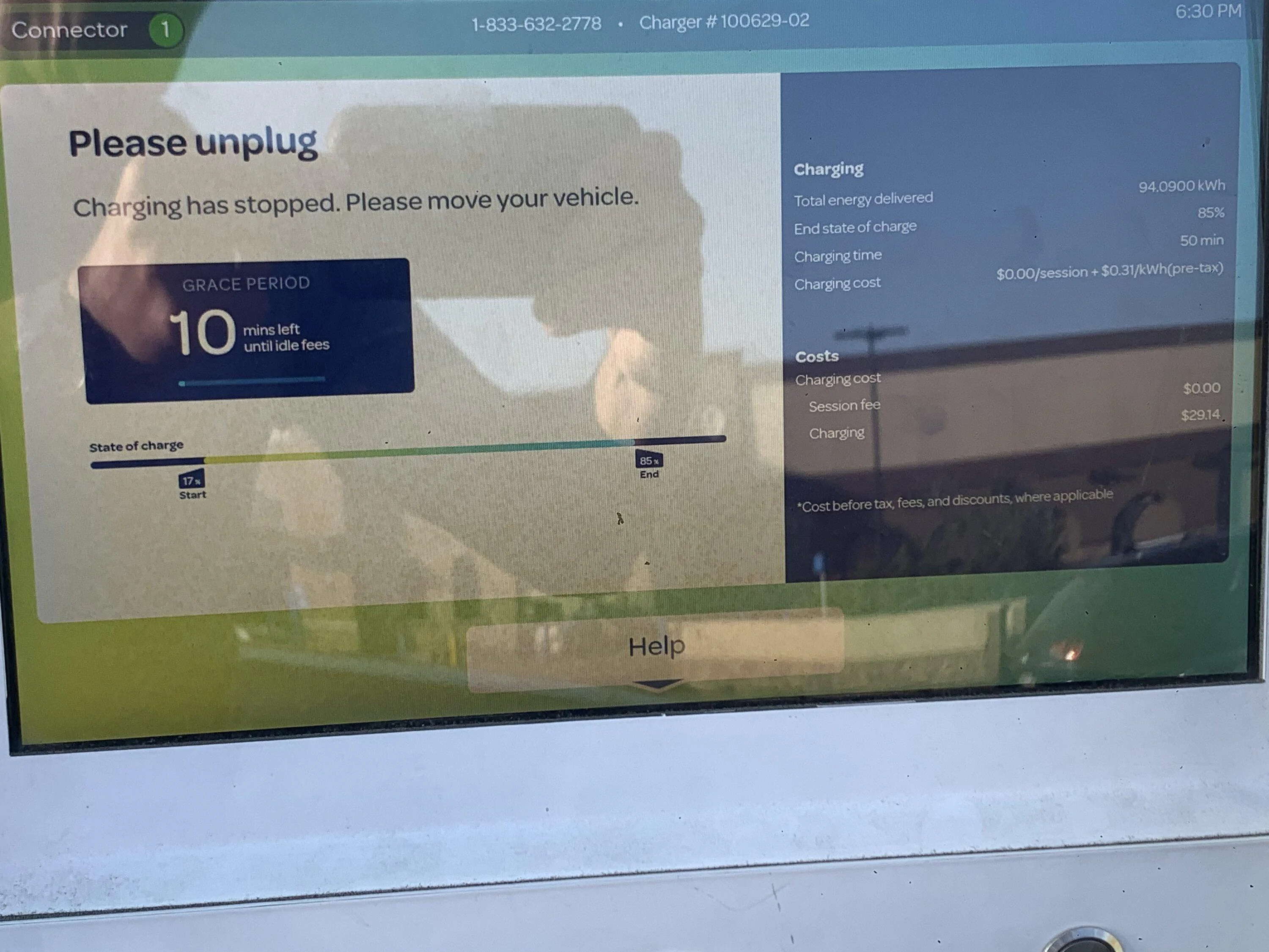

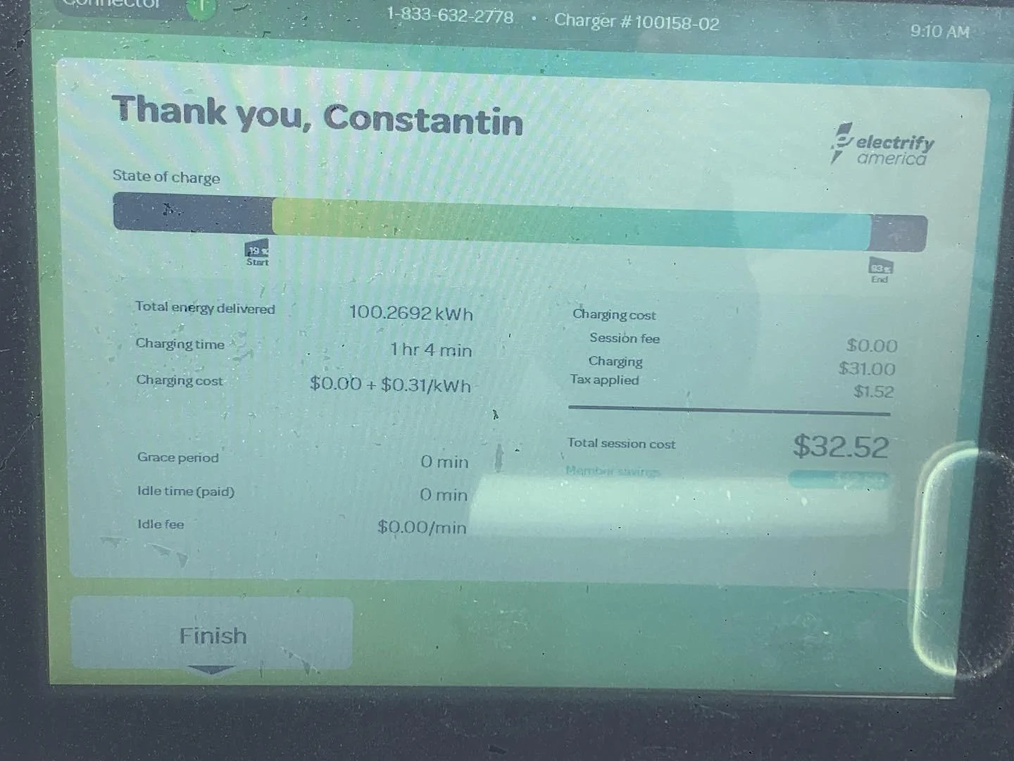

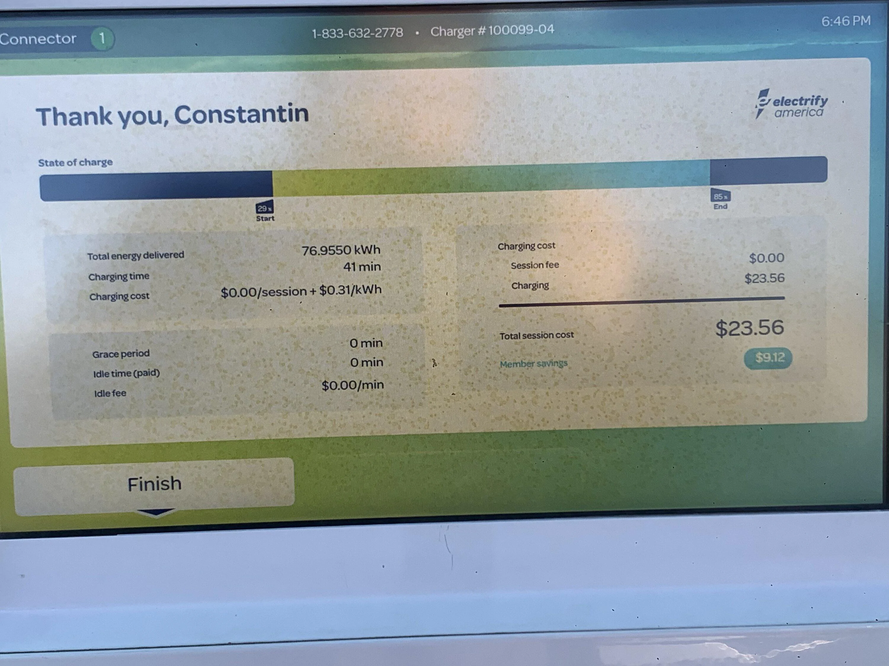

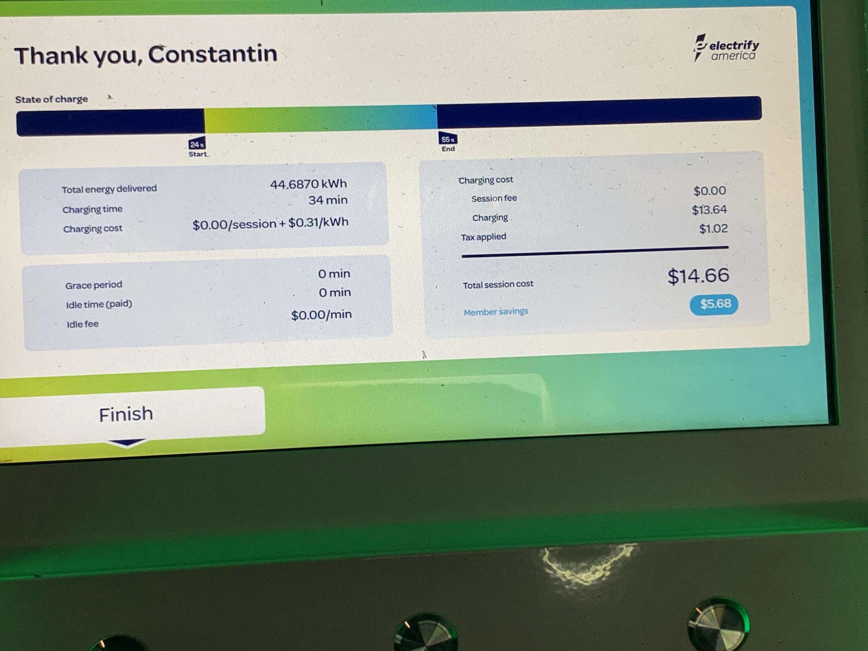

On my cross country trip, I took screenshots of the charging numbers and I used only EA for 7400+ miles journey. If you want, I can upload them to take a look. If I remember correctly, the cheapest one was in Mississippi (9 cents/KWh) and the expensive one was in California.
It’s worth to mention that I have a subscription with EA

I would be interested to see the numbers.
