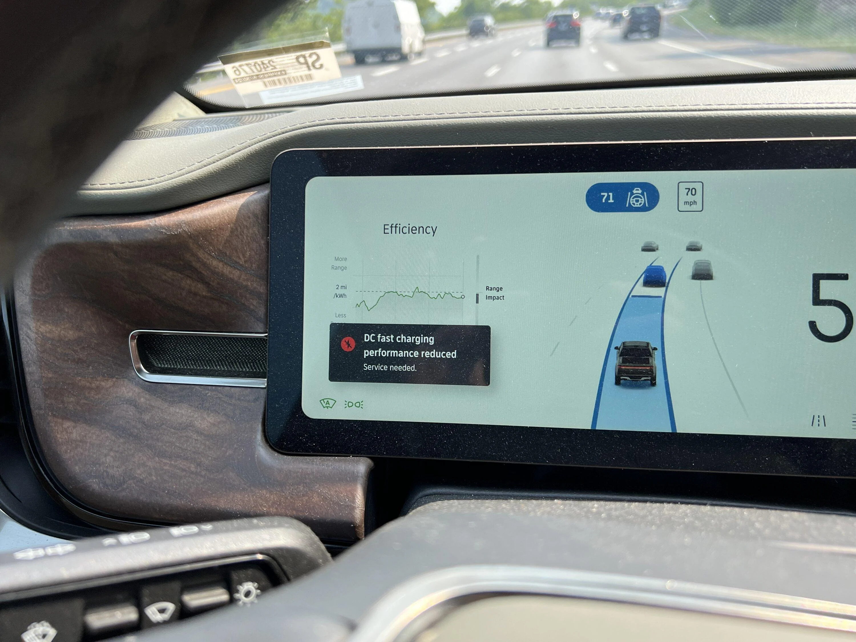

Has anyone else received this message? I've gotten it a couple of times this week upon attempt to start the vehicle. It flashes the message and refuses to shift out of park. Has always reset itself upon a soft reboot or exiting the vehicle and re-awakening/opening it back up. Have a service call into the system, but curious if anyone else has dealt with this?
Yes. Had mine in for service 2 months ago. Replaced wiring harness. Said it was fixed. Dropped it off last week for service and currently driving a rental for the same problem.
Rivian R1T R1S Error Message: Charging Unavailable until Serviced IMG_1583
