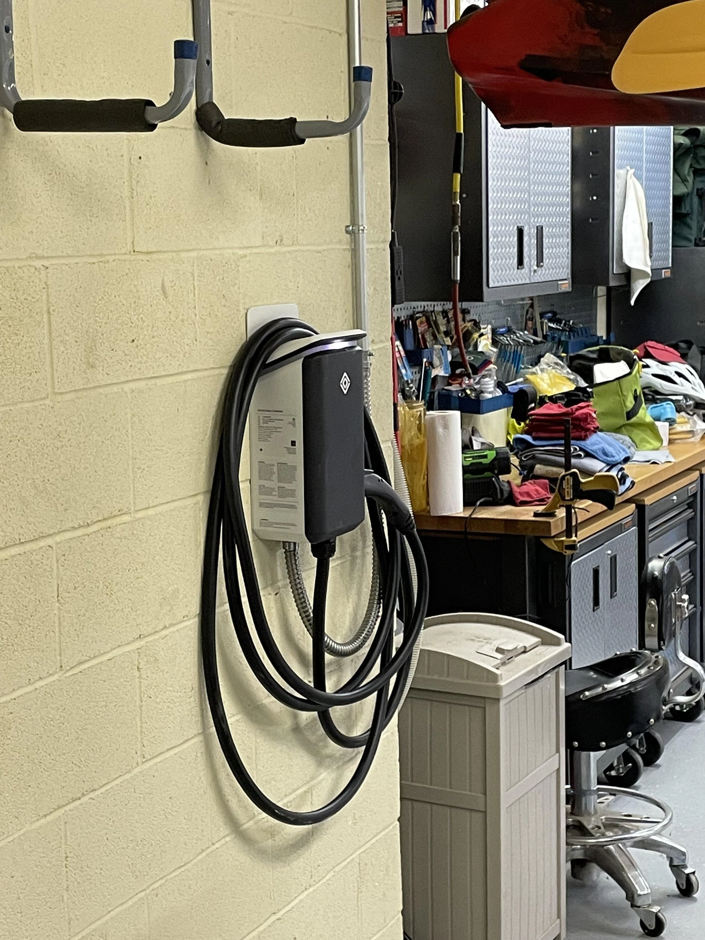

This is a timely post. I've been temporarily using a 10-30R outlet coupled with a 14-50 adapter and RV 14-50 extension cord on the portable Rivian charger... been dialing the truck down to only 24 amps but never felt confident in this as a long term solution. This video just confirms that.
I had my wall charger installed last night on a 60 amp circuit. Feel better already.
