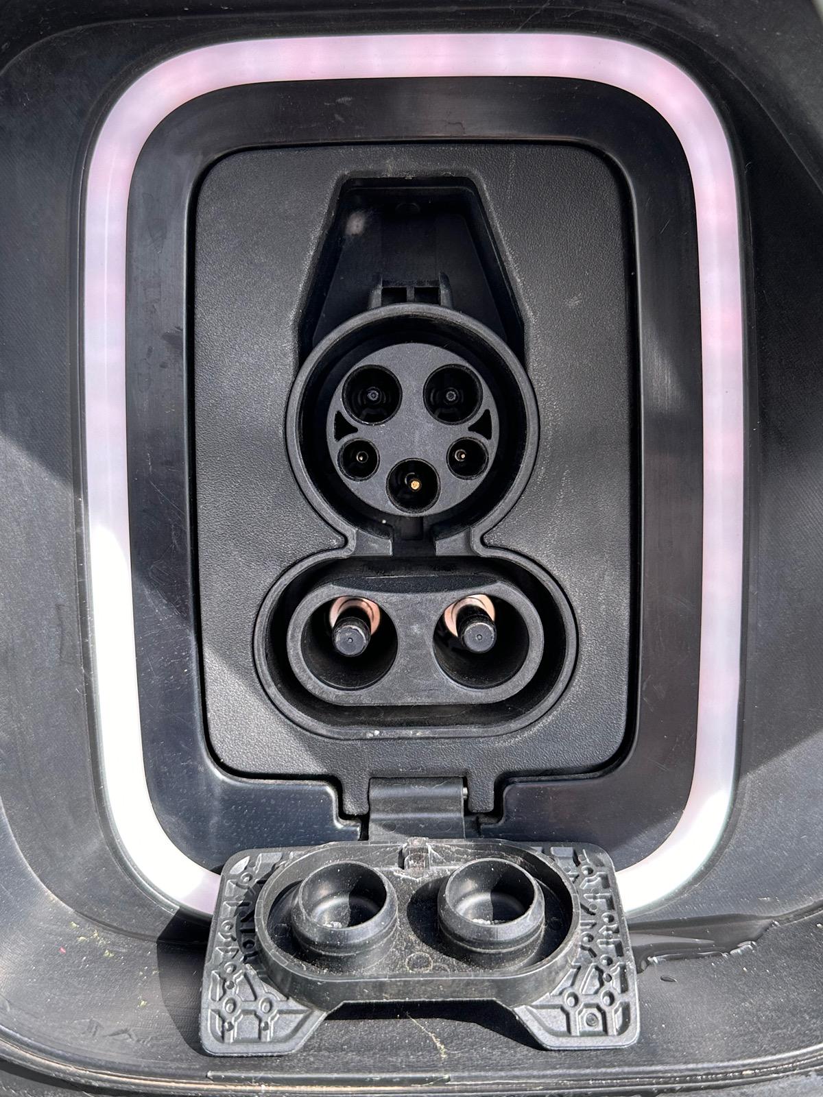

The top portion of your charging port is known as J1772, used for home charging or destination charging. It can only take up to 11.5kW. The whole port, known as CCS1 (Combined Charging System), is used for DC Fast Charging. Currently, the max speed that Rivian’s can accept is up to 220kW. You will need the NACS to CCS adapter such as the one from A2Z or what Rivian is sending everyone to utilize select Tesla Superchargers. Electrify America, EVGo, and other companies have fast chargers that already have CCS1 connectors so no adapter needed.
